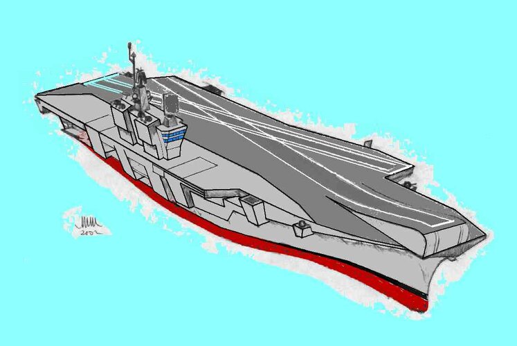

Indeed. Here’s my lengthened Centaur in the 80s with 25x F/A-18s.
I added a long waist catapult (199ft BS5 as on Eagle/Ark Royal) for higher take off weights and a Hermes-like angle deck with a ~6.75 degree angle (wasn’t sure a large Victorious like sponson could be made to work on such a narrow hull)View attachment 744378

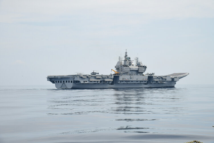

Like the early design for the Indian Vikrant 2?
Even as completed her aircraft lifts could still be enclosed without much trouble:

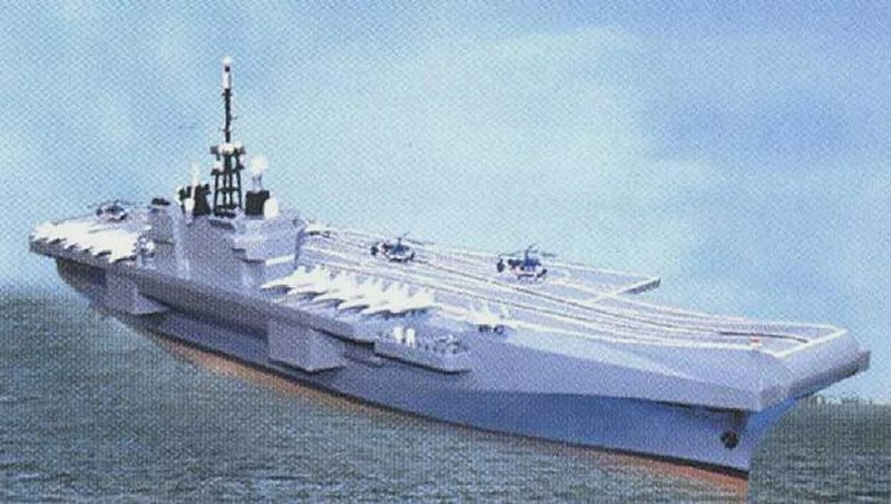

In this thread and others concerning light carriers I be been talking about my ideal carrier for the Canadian Navy. I think I may have found something close to it.
I wonder if you could squeeze a larger engines in her . And how much horsepower you could put in a carrier built say somewhere between 1964 and 1968.

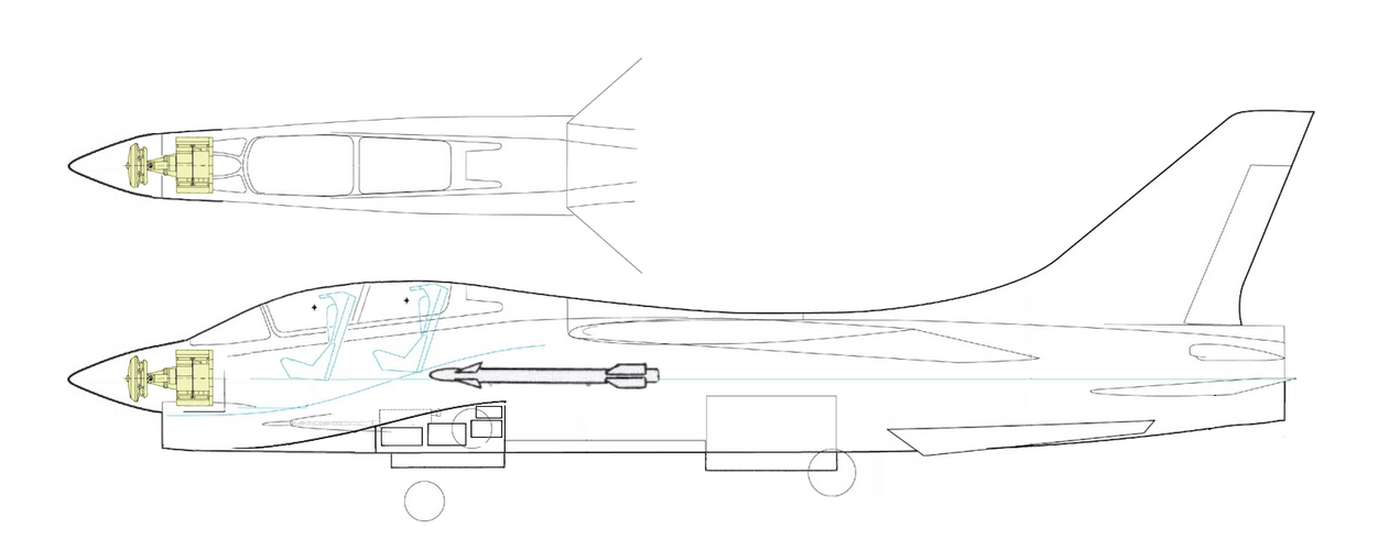

Personally I'm going with Spey Twosaders with pulse doppler radar for look down/shoot down interceptions... from the late 60s onwards. Would Canada want a few? F8U-1T Twosader mod 200px=1m v3.png

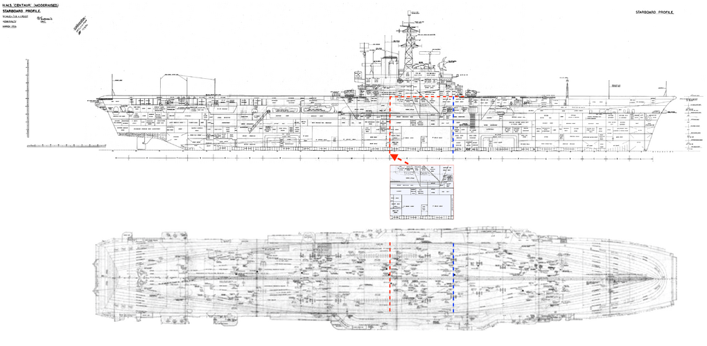

Yes looking at Centaur's plans and hull lines I've come to the conclusion that the best location for a hull plug would be right below the island, at the bulkhead behind the forward machinery room.
This would allow 2 new hull sections to be inserted amidships, where the hull cross section is constant. These 2 sections would be duplicates of the forward turbine space and fwd boiler rooms, allowing the old forward machinery spaces just ahead of this to be freed up and converted to fuel & weapons storage.
See dashed red line below. Obviously this would best be done early during construction, before the machinery spaces and island have been installed.
If the plug had to be done after the hull is essentially complete, then it would best go where the dashed blue line is, i.e. ahead of the existing machinery spaces. But the hull cross section wouldn't be constant and that might be problematic. HMS Centaur plans 5px=1ft v2.png
P.S. The rationale for such a hull plug would be if the RN determined that rebuilding the wartime Illustrious class would not be economic and that the Centaurs's 725ft flight deck was just a little too short to effectively handle the longer deck runs associated with jets.

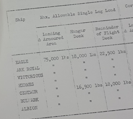

There was a fair bit of discussion in this thread about deck strength limits.
I've just come across this interesting table which states the maximum single undercarriage leg load for the carriers in service in 1963.
Does that mean 18,000lb for each main undercarriage leg and another 18,000lb for the nose gear for a total of 54,000lb?
Well if I’m not mistaken the nose gear typically supports only ~10% of total aircraft weight, with ~45% on each main landing gear. So these limits would translate roughly to:
18,000lbs / 45% = ~40,000lbs gross weight
(Centaur flight deck)
22,500lbs / 45% = ~50,000lbs gross weight
(Hermes/Victorious/Eagle & Ark Royal flight deck)
as I have understood it in the past that referred to the empty weight of the whole airplane.
The F-4K (FG.1) had an empty weight of 31,000 lb.
They did test-flying from Eagle with the only mod being to one of the arresting wires.
I believe that that table means exactly what it says - the maximum weight for any SINGLE landing gear leg - not for 3 legs combined.
now I have to wonder about some info since it never specified.... cool. I love learning new stuff on here!
Also, the S.2 Buccaneer had an empty weight of 30,000 lb and operated off all 4 "modern/modernized" carriers... as did the Sea Vixen whose empty weight was 27,950 lb.
The Scimitar, which operated on all those plus Centaur, weighed 23,962 lb empty.
