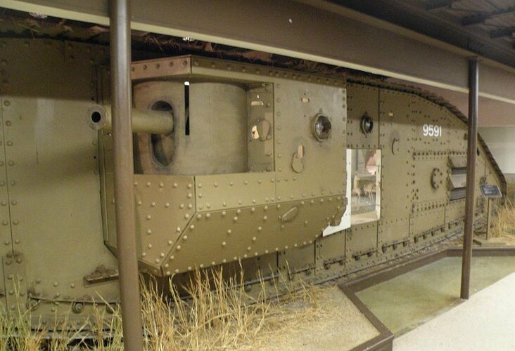

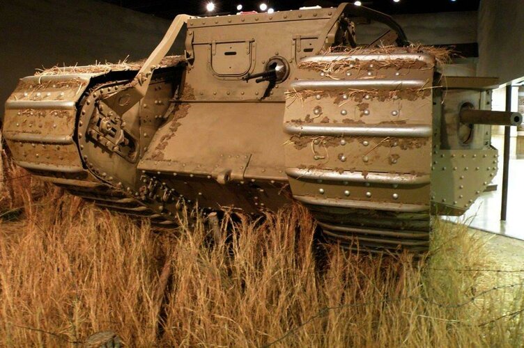

Mark V * - British heavy tank during the First World War. It is a front-line modification of the Mark V heavy tank.
In an attempt to stop the tank threat, the German army began to dig wider trenches that made it difficult for tanks to cross. For example, the trenches on the Hindenburg Line were expanded to 11 or 12 feet (3.4 or 3.7 m), which exceeded the trench-crossing capability of British tanks by 10 feet (3.0 m). To counter this, Sir William Tritton developed the "tadpole tail", an extension of the tracks to fit on the rear of the Mark IV tank, which lengthened the tank by about 9 feet (2.7 m). Although 300 shank sets were sent to France in the spring of 1918, they were never installed and the design was never used in combat.
This, in turn, prompted Major Philip Johnson from the workshops of the Central Tank Corps to develop his own plan in early 1918. He cut the Mark IV in half and inserted three additional panels, lengthening the entire hull by six feet. Three cars were modified in this way. (For a long time it was thought that most Mark V*s were field conversions made by Johnson. In fact, they were all new, factory new designs.) The Mark V* featured a reshaped rear turret with two additional machine gun mounts, a door on each side of the hull with an additional machine gun mount on each side. This tank weighed 33 tons.
The extra space also allowed up to fourteen men to be carried in addition to the standard crew: the 1st Battalion, Royal Tank Regiment claimed that 2 Lewis guns with a two-man crew could be squeezed in; 2 Vickers guns with a crew of four; plus an infantry reconnaissance officer and an officer. However, as described above, they tended to be exposed to smoke-filled atmospheres.
The total order for the Mark V* was 500 men and 200 women, 579 built under the Armistice – the order was completed by Metropolitan Carriage in March 1919. Shortly before the end of the war, Britain delivered 100 vehicles to France. Mk V* (80 males and 20 females). They were not used in action, but remained in French service throughout the 1920s. Discharged from active service in 1930, they were left in storage to have heavy tanks to discard in case the Conference on Arms Reduction and Limitation required it.
Because the Mark V* was lengthened, its original length-to-width ratio was messed up. The lateral forces in the turn now became unacceptably high, which led to the dropping of tracks and a huge turning radius. So Major Wilson redesigned the track in May 1918 with a stronger camber to the bottom, reducing ground contact (but increasing ground pressure as a compromise), and the tracks were widened to 26.5 inches (67 cm). The Mark V engine was bored out to 225 hp. (168 kW) and located further in the building. The driver's cab was combined with the commander's cab; now there was a separate machine-gun position behind. Of the revised order for 700 tanks (150 females and 550 males), only 25 were built, and only one of them by the end of 1918
Male Mark V*, number 9591, has been part of the collection of the National Armored and Cavalry Museum at Fort Benning, Georgia since 2010. Issued to Company A of the US 301st Heavy Tank Battalion and hit with 57 mm (2.2 in). on September 27, 1918, during the attack on the Hindenburg Line, it was repaired and sent back to the United States. This is the only surviving Mark V*.

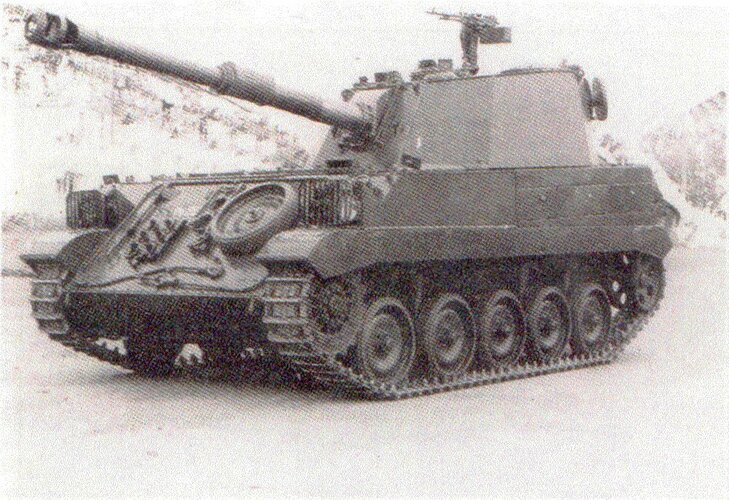

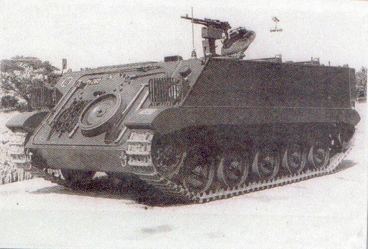

A prototype from FVRDE, not the British one, but India DRDO's FVRDE.
Inspired by captured Pakistan M113, India tried to built an APC on AMX 13's running gears, the APC 70. They also built an SPG variant.
I'd love to know more about this program, I'm not finding anything on it

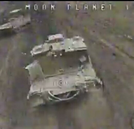

Some news on the Ladoga NBC-protected personnel carrier: seems the Russians are getting well and truly desperate, because one has apparently made an appearance near Lyman, Ukraine. Where it was likely wrecked by an FPV drone, very little information available (and I'm a few months late, but only heard about this yesterday).
The arguments go around and around but, like a quick-change barrel for CSW machine gun, the essential need is to de-bus rapidly, and preferably protected from small-arms / shrapnel by the vehicle hull.
So, where do you put the engine / drive train ?
And, would the vehicle be adaptable for eg command role, mortar carrier, re-supply, medevac etc etc ??
Dafuq?!? why the hell would one of those be anywhere near the front?!?
