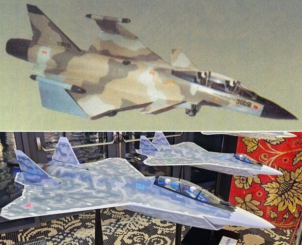

I agree. Especially with apparent T-50 technologies being employed. All it needs now is perhaps political support to get it running. Especially if desire to have "medium" fighter exist. After it flies and demonstrated, then things can be hoped to flourish.
That's the main issue. Russian AF brass from Soviet times dislikes single-engined aircraft, and I'm not sure if calculus using experience in current war (heavy Su-34 carrying 2-4 bombs to toss them 30+km away, when even old aircraft such as MiG-27/Su-22 can do the same if WCS is upgraded) is enough to overcome inertia.

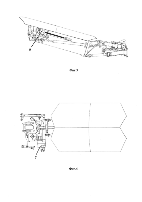

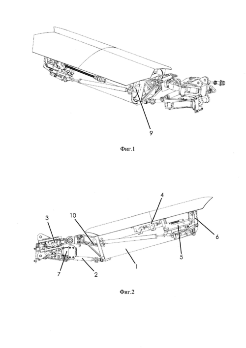

Parachute system patent for T-75 in detail:
The parachute braking landing installation of a single-engine aircraft comprises a brake parachute container and the brake parachute itself. The brake parachute container is made movable by means of a reciprocating electromechanism of the container release and retraction mechanism from the raised position to the retracted position and back. In the retracted position, the brake parachute container is recessed into a niche of the upper tail section of the aircraft above the aircraft engine, and in the raised position it is rotated above the surface of the aircraft around the container rotation axis. The claimed installation is equipped with a brake parachute container flap mounted on the rear part of the brake parachute container with the possibility of opening it by means of the brake parachute container flap opening mechanism through the limit switch mechanism and fixed by an electromechanical lock of the flap opening mechanism. The installation is equipped with a brake parachute lock connected to the brake parachute tether. IMG_1609.png IMG_1610.png

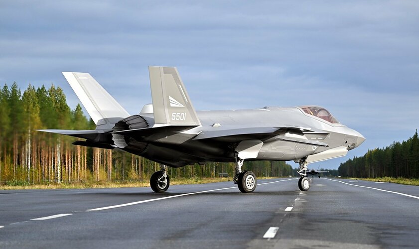

Looks more elegant of a solution then on some F-35’s. Admittedly on F-35 it was an afterthought:
It is too soon to tell, I don’t see where the parachute would go other than having to add a pod like the f-35. One thing I was wondering I have seen that the f-35 has high AOA capabilities, I wonder how the su-75 compares to it.
well, this is on an export variant for some country that I cannot remember the name of. It is an afterthought because it (parachute system) simply wasn't needed for USAF, USMC, or USN.

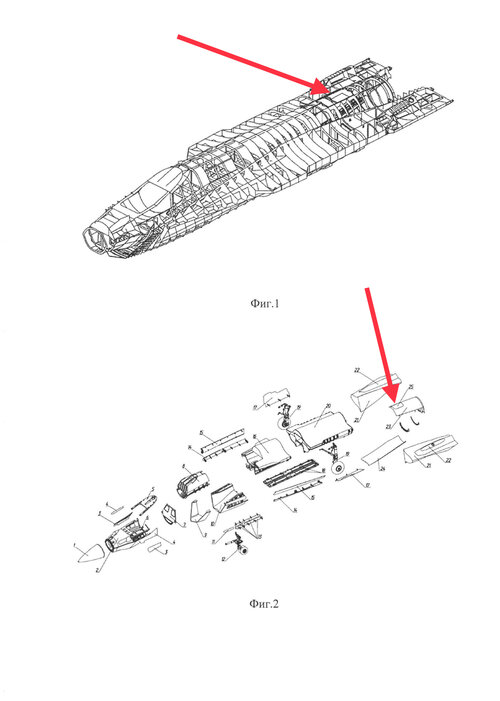

As Flateric already wrote, through patents you can see the location:

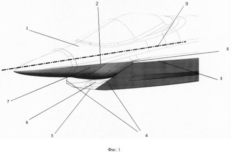

As for high angle of attack, again, patent :) :
TACTICAL AIRCRAFT WITH ENHANCED AERODYNAMIC CHARACTERISTICS
To achieve high lift capabilities at high angles of attack, an aircraft needs vortex formation.
The required vortex formation on the fuselage in the claimed invention is ensured without the use of wing extensions by reducing the opening angle of the upper and lower parts of the nose of the fuselage to values of 65° - 70°. Such shaping is achieved by placing the engine air intake with full coverage of the entire lower part of the aircraft fuselage. The acute opening angle of the fuselage surfaces, as well as the reverse sweep of the side edges of the air intake and the edges adjacent to the fuselage of the air intake, make it possible to ensure reliable vortex formation necessary for obtaining high load-bearing capabilities at high angles of attack.
In the proposed design of the air intake, all edges are swept and can be parallel to any elements of the aircraft (wing edges, empennage, etc.), while there is no gap between the air intake inlet and the surface on which it is located for draining the boundary layer.
The side edges of the air intake inlet and the edges adjacent to the fuselage have a reverse sweep, which improves the characteristics of the air intake while reducing the air flow from the maximum value at all Mach numbers (hereinafter referred to as M) within the operating range.
The absence of additional aerodynamic surfaces, such as wing extensions or vortex generators on the fuselage, allows to reduce the aerodynamic drag of the aircraft as a whole and increase the values of its aerodynamic characteristics. The proposed technical solution is also aimed at ensuring stable operation of the power plant up to the number M = 2.1 with a total pressure recovery coefficient at the engine inlet not lower than the typical one for unregulated air intakes and a total flow non-uniformity below the maximum permissible value. IMG_1684.png

1. The more resent images have already shown significant changes from the original model away from the su-57 but one engine plan they had been promoting (wich isn't surprising reusing the su-57 wings would have given the su-75 way to much lift)
2. I think the fact that the Russian MoD has shown zero intrest in the design I think shows that the su-75 probably isn't a very good deal. if it was cheap to make you would think su would build a prototype consdering the export potential. But nothing on that frount either.
