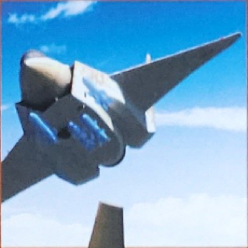

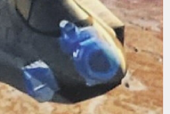

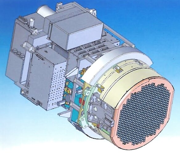

Anyone notice the second picture to the left at the very bottom? Radar and EO equipment highlighted in blue, but also some kind of side sensors/comms highlighted on the sides of the chin intake.
I think it is the EOTS

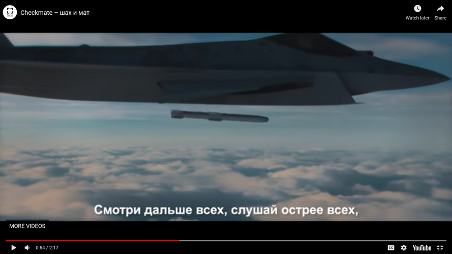

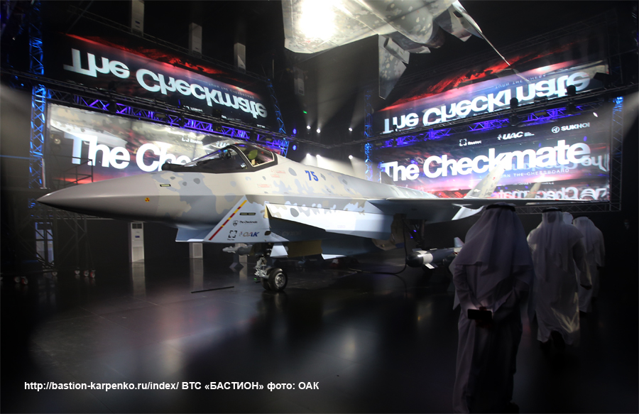

5 in the main bay?
Should be 3 from what they have said. In any case, it seems confirmed that it can carry MRAAMs in the side bays, definitely a good feature. The loadout shown in the image below is quite nice for a strike mission, me thinks:

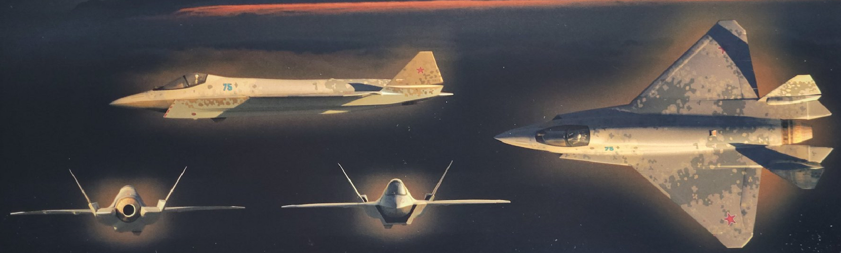

Twin seater would look like the model in the front, the one in the rear is unmanned:
I mean, splitting a bay equally in two and in 3 isn't the same.
Suspension points/adapters for two bigger&heavier munitions may not be the same points that are used to hold lighter and narrower 3.
And they may not be used simultaneously. Or may actually be - for something very small.
I see no other explanation on the given airframe.
That is innteresting, definitely the points for big ordnance could not be the same ones used for the 3 AAM, there would not be space for the weapons. So maybe it is 11 suspension points, but not for simultaneous use as you say. Other option is that the wing has three instead of two suspension points, but being essentially identical to that of the Su-57 that would be unexpected
