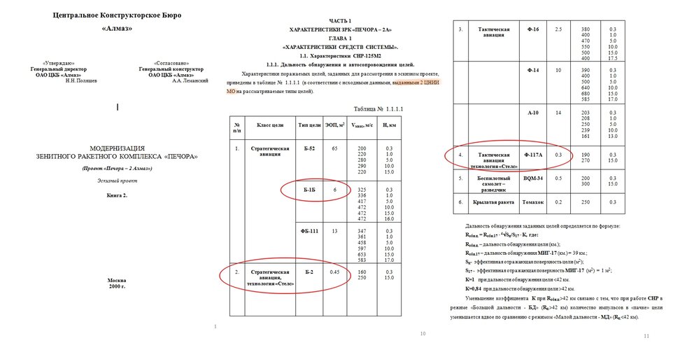

@Trident The claim of -50 dBsm comes from this study:
file.php
Obviously, the study ignores RAM, and average RCS is in the -10 to -30 range. The poo-poo-ing of minimal RCS claims vs a large number of emitters with differing azimuths and angles is still valid if an absolute minimal RCS is chosen, since minimal RCS is closer to a valley than a depression.

Just one last question. How do the Russians evaluate the RCS of the F-35? Do they view it as stealthier or less stealthy than the F-22? The Checkmate would make a lot of sense if they viewed the F-35 as a 0.2 or 0.1 m^2 RCS fighter; then the math on detection range suggests that the Checkmate, given the claimed 0.2 m^2 average RCS as well as the substantially larger radar, would get a radar detection advantage vs the F-35 on average. Of course, in practice, the availability, presence, and survivability of a counterstealth radar is still extremely crucial, since counterstealth radars can cue EO / IRST systems. And when we consider the combination of counterstealth for detection and EO / IRST for tracking, IR stealth becomes highly crucial. What known IR-signature suppression features are extant on the Checkmate?
According to Russian experts, the RCS of the fifth-generation fighter can not be lower than 0.3 m2. F-22 rating - 0.35 m2, F-35 - 0.4 m2 (with short - range missiles under the wing - 2.4 m2) The engine of the izd. 30 has a reduced IR signature. In the future, it will be equipped with a flat nozzle with even better data. This is officially stated. As far as I understand, the Russian doctrine provides for reducing visibility only in narrow sectors. The maximum coverage with radio-absorbing materials in the front and the minimum from other angles. This allows you to dramatically reduce the cost of maintaining the readiness of the fighter. For the LTS $ 5,000 is claimed for an hour of flight, which is seven times less than that of the F-35
Iirc, the old Chinese / Russian RCS measurement of the F-22 was 0.1 m^2, was it not? I know at least the Chinese had a "representative" RCS measurement of the F-22 at 0.1 m^2, so maybe I'm conflating Russian measurements and Chinese measurements.
Still, if what you are saying is correct, with a claim of 0.2 m^2 vs 0.35 and 0.4, the claim is being made that the Checkmate, in Russian eyes, is stealthier than the F-22 and F-35, no?
For other readers, please remember that the RCS of an aircraft cannot be represented by a single number, but instead by massively complex graphs that vary depending on combinations of angle, azimuth, and frequency. The assumption being made is that the Americans prefer listing minimal RCS figures that represent the lowest RCS of an aircraft, while the Russians prefer listing average or usable RCS figures that represent a wider range of angles and azimuths.

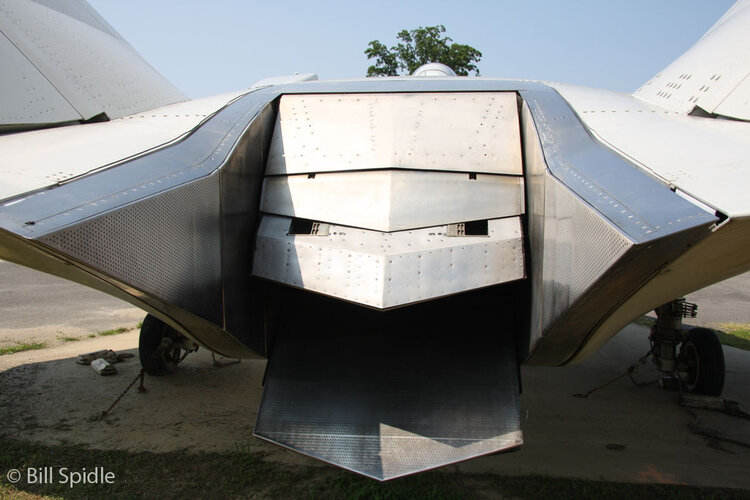

What are the advantages of flat nozzles? Are they worth it?
I read an article on the F-22 where they said the flat nozzle was great for radar and IR signature reduction.
On the flip side, it's heavy, produces has less thrust than a circular one, and probably less efficient at some exhaust velocities due to the lack of adjustable diameter.
I'm not convinced that it's appropriate for a modern fighter, unless you are going for absolute, all-aspect stealth, which is not the Russian way as I understand.
Are there some other advantages to it?
In the characteristics of Russian radars, this is one digit - the average value with which the SAM works

1. This will reduce the radar visibility to the desired value of 0.2 m2 from other angles
2. It will reduce the infrared signature
3. This will allow to close the nozzle for option a short take-off and vertical landing
2D nozzles are also relatively easy to install thrust reversers for STOL (see SAAB Viggen). 2D nozzles have far fewer moving parts than 3D nozzles (round).
Just look at 2D engine inlets ... they are common and pretty much standard on planes that fly Mach 2 or faster.
Are thrust reversers justified on modern planes though? Aren't the flaps+ all moving tails provide enough braking force?
And with regards to STOVL, are there rumors on the grapevine that something is in the works?
Personally I'm not seeing the appeal of STOVL compared to STOL, and canards or movable root extensions allow for planes with pretty good STOL performance.
