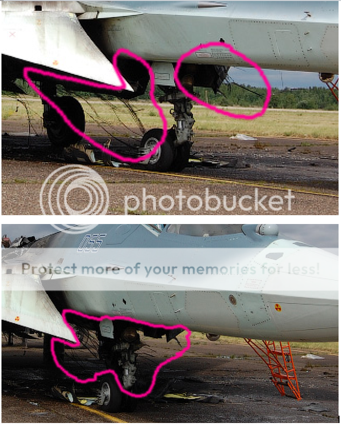

You can see that the damage goes well beyond the centerline of the PakFa by all the stuff hanging underneath.
In fact, it went down slightly different. Today T-50 initially rose to demonstrate the possibilities for our Indian guests. Around 12 pm on board lost contact. Was only partial remaining. On the 3rd turn there was an alarm, shavings in the right engines, the pilot was forced to shut down the right engine. Since there was no communication, he passed over the runway waving wings, letting understand the RP (EDIT: ATC) problems on board. Successfully able to land the plane on one engine. Turned to the nearest taxiway, the pilot immediately turned off the left engine. Then all the fun started! RP gave the command to leave the plane immediately. Pilot turned around and saw that intense belching black smoke poured out of the right engine. Without waiting for any ladders pilot jumped out of the cockpit. Seeing a burning puddle of fuel underneath the plane he ran a good 100 meters.
Closeups showing damage to the un-seen left side:
Look closely at the underside of the two photos. There is extensive damage to the left side of the aircraft.
Look at these closeups and at the left Levicon. I am not saying they lied about which side the fire started on, just why they didn't show the left side.
Hate to say it, but that does look like a potential write-off. At the very least, it will be a long and costly repair. It seems much of the equipment in the nose would have survived to be salvaged though, so not a total loss even if the airframe turns out to be too badly damaged for further use.
As for them not showing the other side, while there is indeed likely to be some damage there as well (for all the reasons Spudman points out) I don't really see anything which would indicate that it is worse than the right side, so I wouldn't read anything into the fact that there are no pictures (yet?). I mean, it's mildly surprising that there are decent photos so soon after the event at all!
EDIT: another interesting piece of info is that the pilot elected to unstrap and and climb out - one report on a Western pilot flying the Su-27 remarked that the intricacies of the K-36 were such that in a ground mishap it might be advisable to eject if you were in a hurry and had nobody to assist you in getting out of the harness! Maybe the new variant for the T-50 is less complicated in that regard.
Interestingly, the tires appear to be quite intact, so heat damage may not be all that extensive. Though the hanging fibers look quite troubling. It's hard to really gauge the damage from these photos.

Although this might be as much of a complement to the early 0-0 ejection seats that the Soviet Union helped pioneer as it is a complaint about harness complexity.
Yet another reminder of the danger of being a test pilot and the caliber these men must have. Glad he's safe.
Why is there a radiation symbol/sticker on the levcon?
EDIT: I haven't been keeping up with the latest PAKFA, especially 055, so a brief perusal on the net finds claims that the Levcon houses radar antenna.
I have seen speculation that it was an engine fire. I have to question that though since it looks to be far too forward for that. I wonder more if it was a fire in another system - perhaps avionics overheating or even OBOGS?
An engine fire that spread to a fuel tank? Do they (RuAF) use hydrazine? Maybe there was a hydrazine tank there?

Because unlike the f-35, PAK FA is still in a much earlier stage of development, hasn't had a track record of failed promise repeatedly over the past 20 years, and massive cost overrun that left the US air force too starved for money that the bulk of its fighters are less advanced then their export versions that are sold to allied forces. We are also talking about the scale of the project - f-35 is meant to be a core fighter component of all 3 branches of the US military for the next 50 years, and a dozen other allied military.
The PAK FA incident is sad. Will it cause some stir, especially with India? Possible. But it is hardly an incident that would be as catastrophic as say the f-35 crashed at this stage of development. And there are good reasons for that.
OBOGS is placed in quite a different place
we don't use hydrazine
rumors are of AMD fire

I like to think of the difference between this and the F-35 is that this (landing after catastrophic failure) is a test the F-35 has yet to perform...Those darn crafty Russians…showing the west up again! ;)
I'm no engineer, but from the photo the fire damage is directly above the Levcon. How can that possibly be from an engine fire? Could be a Levcon actuator or wiring, or antannae component in the Levcon.
Is there an active radar wave cancellation system located near the intake openings on the Pakfa?
No it isn't. I am also unsure what AMD is exactly?

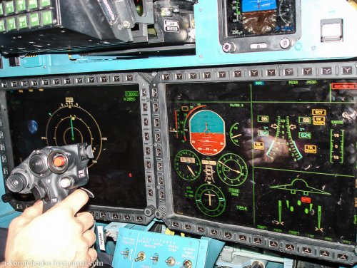

I've been trying to decipher the flight instruments display in the T-50. (If this really is the T-50 cockpit?)
I can recognize the ADI, altimeter, airspeed and horizontal situation indicator. And I assume that's a rate of climb/descent to the right of the ADI?
What's on the left of the ADI? Angle of attack indicator? Turn rate?
And there's a sort of inverted v-shaped gauge between the ADI and the HSI. What is that? And is it the same thing as the larger, similarly shaped display to the right of the flight instruments? Engine thrust perhaps?
AOA indicator
Engine RPM in %
