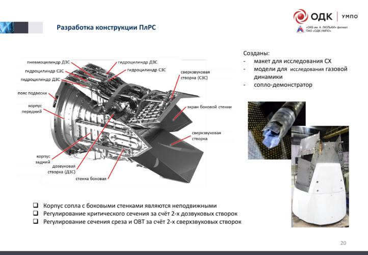

''On May 18, 2021, AEX.RU - A. Lulka Design Bureau - a subsidiary of"ODK-UMPO"is working on the formation of a scientific and technical backbone to create a sixth-generation engine for combat aviation. "This is a three-contour scheme, which the whole world is doing," Evgeny Marchukov, general designer of the Design Bureau, said at the ICAM-2020 conference. This is reported by the press service of the MAKSAir Show.
According to him, two options for implementing this scheme are being developed. The first stand tests of the demonstrator are due to take place in 2021. Using a three-contour scheme will allow to modernize the al-41F-1engine, improving its characteristics while maintaining dimensions.
In addition, as part of the creation of the NTH OCB, I.A. Lulki is engaged in such areas as a combustion chamber with wave detonation, a pulsating resonative detonation engine with a two-stage burning of kerosene-air mixture.''

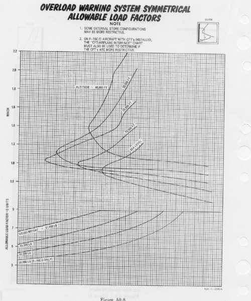

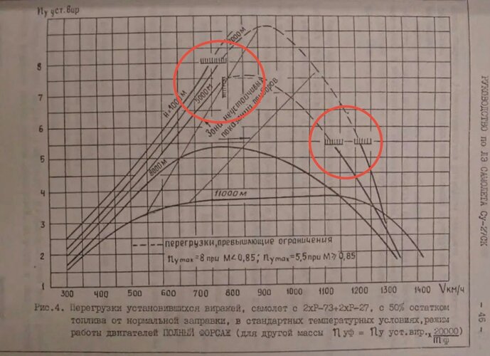

PeregrineFalcon said:
Here is the chart for similar type of limitations for the F-15:
And you are clearly cherrypicking your data for the F-15, since this is the limit without OWS. In the same document several pages later, with OWS, F-15 is clearly able to pull 9g, something you conveniently left out.
It states, “перегрузка” - load factor for the sustained turns at the weight of 20000 kg (missiles included, 50% of fuel from the normal fuel load etc.)
The full lines represent the G load for the 8G limit, and intersected lines represent the G load when the exploitation 8G limit is exceeded/overridden.
If there was serious danger of destroying the airframe under 9G sustained turn at 20000 kg, there wouldn’t be such option on the EM chart, and the plane would be hard limited to 8G.
And that chart has clear marks at the 8g limit, which clearly indicates those are limits not to be exceeded in normal operational service at risk of damaging airframe.
This is similar to F-15 able to pull more than 9g even when not explicitly in manual (which has happened in training and in combat operations), or F-18 Hornet having ability to override 7.5g-limit. The aircraft able to do it aerodynamically but doing so absolutely risk damaging or even losing aircraft, and cannot be done repeatedly.
But for purpose of aerodynamic comparison don't even know why F-15 is being invoked at all as analogue for F-22 when they're made by completely different companies and only look superficially similar at the roughest glance and even then, not that much other than closely spaced engines.

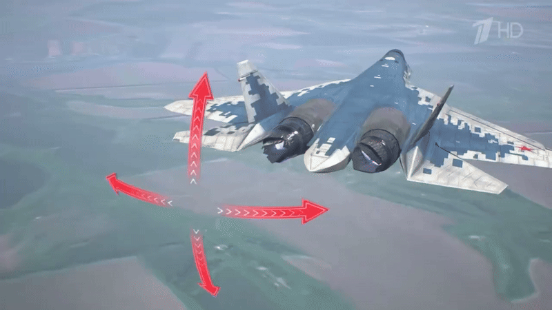

does this mean the real thing can change the vector of thrust in a rudder axis in addition to the standard pitch control via petals deflection?:oops:
Is this an official animation? I was under the impression that they just went up and down and the canted angle was used for the z axis, like the su-30, su-35 and current su-57

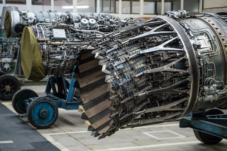

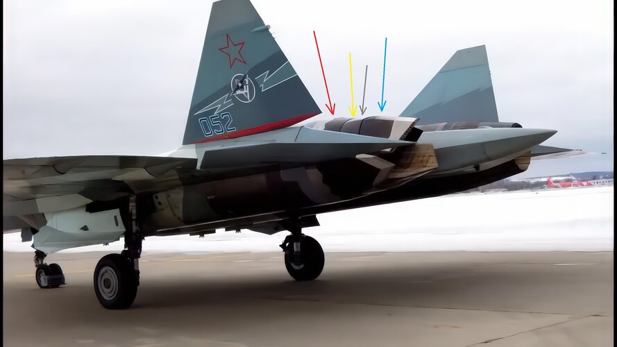

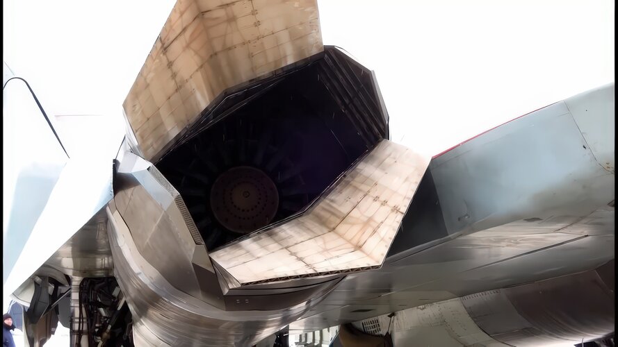

Also, the rear of izd.30 or AL-51F1 seem to have radar blocker and spray bar similar to EJ200 or YF119? Although not full coverage like serial production F119.
file.php
First tnx for 'modified pic',second, maybe it is not the radar blocker but this ,AB chamber w/o stabilizer.

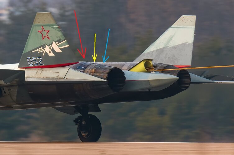

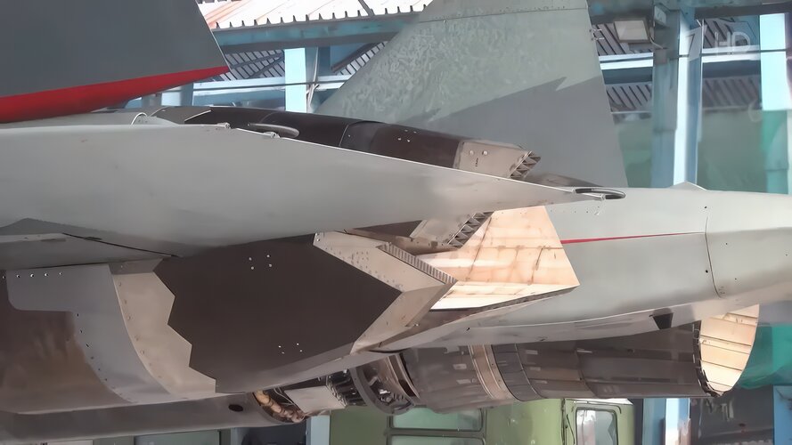

Another details... now let us see how LOAN of Izd. 30/AL-51F is look like.First the video of static test.
View: https://www.youtube.com/watch?v=V_OcDZBe82o
What we can see here? Red arrow shows us skin plate of the Izd.30 ,yellow arrow to end of the skin plate and the place where we can see LOAN movements,blue of course shows to us LOAN itself.
Now let us see how the new nozzle is look like. Red arrow shows to us completely new skin panel,yellow arrow shows to us the end of it and grey arrow to the section for nozzle rotating in longitudinal axis.Blue arrow shows to us moveable part of the nozzle.

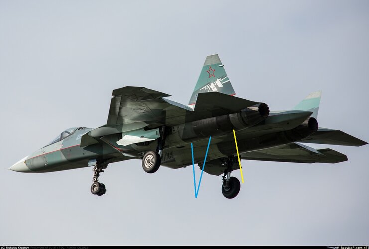

My question is, if this is Izd. 30/AL-51F with the new nozzle, why is there completely new upper skin panel ? Other detail ,if we look better ,lower skin panel of the engine nacelle is also new.If there is really AL-51F ,inside left engine nacelle, why they changed skin panels on it ?
Blue lines shows to us nacelle panels that are the same ,yellow shows us the place where we can see new panels,

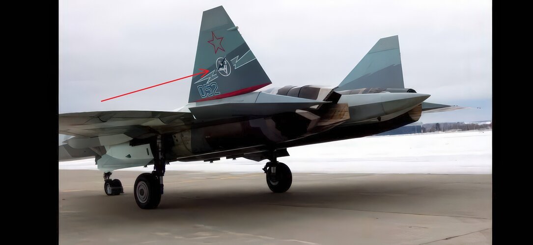

As wrote before ,we can clearly see that Su-57M emblem on the vertical stabilizer so it means that this new engine is for the Su-57M ,not for Su-57. As some official sources said ( personally it was Yuriy Slyusar), AL-51F will be integrated into serial Su-57's from 2025 and all serial Su-57's with AL-41F1 will not get Izdeliye 30. As we know ,static tests for Izd 30 started in 2016 ,flight tests began in 2017 and lasted 7 years ( 2017-2024). Static tests of this completely new ( yes, 6 gen) engine started in 2021 and as we can see ,flight tests started at the end of 2024 and will last for years to come.
First flying prototype of Su-57M had first test flight on Oct. 21 2022 .Pilot was of course Sergey Bogdan. Su-57M is prototype of the Russian 5+/6 gen fighter with many technical inovations.As Sergey said several times,he achieved several test flights so far in which he didn't do anything at all from the takeoff phase ,flight itself and landing phase.He only monitored work of all systems.

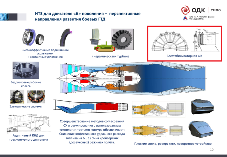

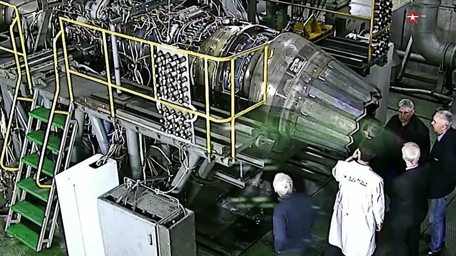

On June 2023 it was released info from ODC that new 6th gen engine is testing...
В ОДК показали кадры испытаний двигателя шестого поколения для Су-57​
''В Объединенной двигателестроительной корпорации (ОДК) проинформировали об успешном испытании двигателя шестого поколения для многоцелевого истребителя Су-57.Немалую роль в высоких эксплуатационных характеристиках нового двигателя будет играть плоское сопло.''
In the article we can see all those illustrations but also pic where we can see ''Su-57'' with new 6th gen engine.Pic was in fact photoshop from paralay. Many sources wrongly wrote that it was the start of the flight tests of that new engine.
Russian source where we can see that it is in fact AL-51F-1 with flat nozzle.There are pics where we can see nozzle with and w/o rotation section.
P.S. If I am wrong about this ,I will apologize to all members.
