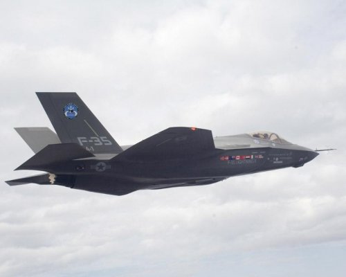

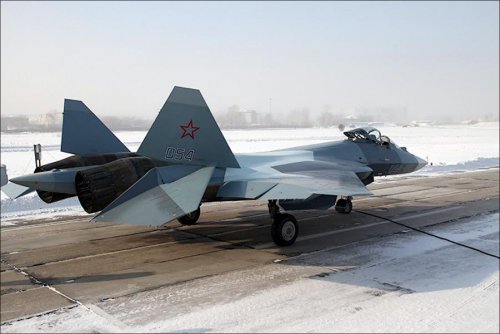

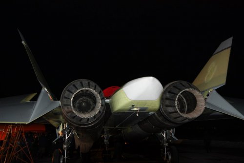

You have no evidence of kinematic advantage. Basic physics favor a centerline mass more agile than two boxy outboard weights that counteract each other. F-14 had similar centroplane, yet it was not used on any western 5th gen. It is outdated, but as 2idsgt, avimimus, and trident say the Russians went with what they knew and what would basically get the job done no frills with less risk. The T-50 is a less risky design, and is more stable. Outboard engines and less static instability than the f-35/22. F-22 was designed much earlier than the T-50.
My racecar with centerline mass will be much better handling than you're racecar with 2 mass located on the sides.
Also, having a huge pancake between two podded areas provide much more wetted area, which the Russians needed more wing area to make up for lost agility due to less instability built into the design. Just as the F-16 needed a smaller wing due to tail lift and an unstable design, which translated into less supersonic drag. The Russians took simpler approach on T-50.
The entire underside of the F-35 is a lifting shape derived from the lifting body research way back starting w/ M2-F1, M2-F-3 etc.
The T-50 flat pancake is a crude approach, which does work, at the expense of needing much more flat wing area. I think the Russians did it more for weapons space/payload reasons. It was a layout they were familiar with. T-50 More old school F-14 style flat pancake wetted drag than an F-22/35.
