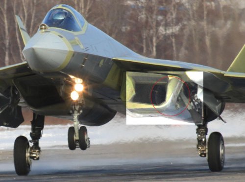

Is there confirmation the long ventral strakes under the wing roots are missile bays?
it was known from insiders back in late 2009 - even before T-50 external view was declassified on maiden flight

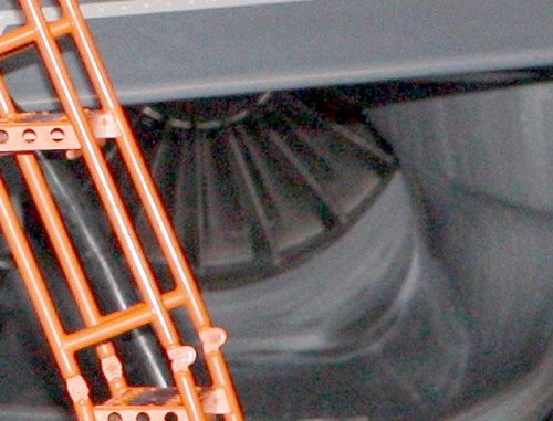

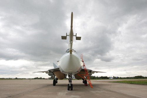

hello friends
In reference to the object that can be seen in these images:
http://imageshack.us/a/img32/5023/blockerpakfa1.jpg
http://imageshack.us/a/img21/6820/t50323hires3.jpg
an user of KP forum has said that "it is an IGV (Inlet Guide Vane)". It seems to me this device is a combination of IGV and radar blocker.
¿What do you think? Thanks in advance...!
My sources tell me the under wing fairings just outboard of the main gear wells contain actuators for leading edge flaps on the wing centre section. I have seen a sketch showing the actuator and the drive linkage, but I think it was in a Powerpoint, not available on the web.
BS
Unless the actuator consist of a thousand gerbils pulling on a string, I can't imagine why it would need a fairing so long.

Wasn't that drawing with the actuator & linkage a speculative illustration, made by a member of this forum literally days after the first flight back in 2010? Seems to have taken on a life of its own in the meantime!

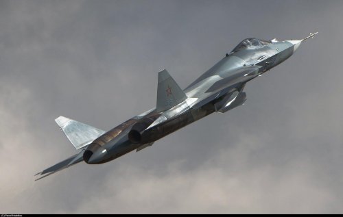

A nice pic of PAK FA #1, © Pavel Noddlov. Enjoy!
chuck4 said:
Don't shoot the messenger, I'm just repeating a theory I heard in a briefing on the aircraft about a year ago. The actuator is quite large and has a fairly long stroke with a bellcrank mechanism to gear down the stroke (increasing the force), suggesting the LE flaps are used at very high speeds. Anybody else have a different story?
Theory is BS and comes from someone who knows absolutely nothing about aircraft construction and modern state of actuators tech. These pods are equipped with clearly visible doors and hold one Izd.760 short-range AAM each.
it was discussed dozens. hundreds. zillion times in last two years. it was known FOR AGES HOW radar blocker would look like
THERE IS NO RADAR BLOCKER INSTALLED YET ON ANY OF FLIGHT VEHICLES
Out of curiosity, wouldn't radar blockers have a negative effect on engine performance due to complications with airflow through such blockers?
Complications? No. In fact, they could help by controlling the airflow into the engines. However, they'll add weight and drag/pressure loss. However, the trade-off is what is the weight/flow losses due to the fan blockers versus the weight/flow losses of serpentine ducts that would be the engineering question.

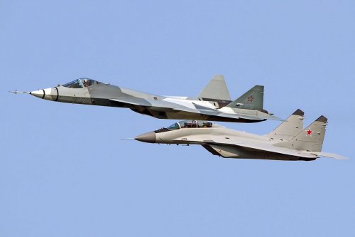

Hello boys...!
...one more, © Dmitry Yakovlev. Nice!
