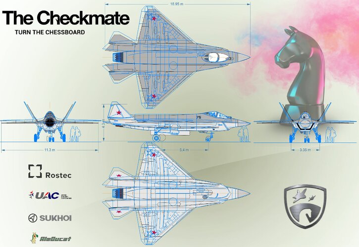

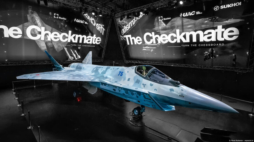

Have we seen a close up photo of the 'Checkmate' logo on the nose?
These images are the best I could find!
I couldn't find anything that let you read the script below (in grey) or see the detail of the logo.....
I have some pics I can't share where you can read the small text below, if I recall correctly it says "Turn the Chessboard". The logo has the knight chess piece at the bottom, and at the top a silhouette view of the Checkmate fighter from rear below chasing another fighter silhouette which was too small for me to identify but logically, probably an F-35?
Ah go on - why not share just a cropped piece of the pictures? In B&W if you like. Watermarked.
See private message. Its TURN THE CHESSBOARD in caps. In font Roboto Regular perhaps.
He's talking about the badge.
I already converted the SVG format logo from the page into a pdf.

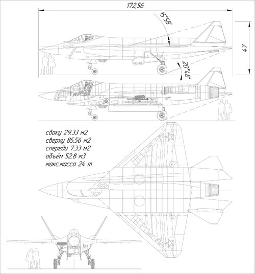

I wish Sukhoi would release a 3 view drawing of this airplane, it is hard to tell with the pictures we have because they look distorted by the camera lenses.
This image was posted earlier but on another forum there was discussion that this shows a possible mockup of kh58 and grom. Might give a good idea of its size. I really think it is just a modified weapons bay from su57 except it is obviously just one instead of two bays. It is awesome.

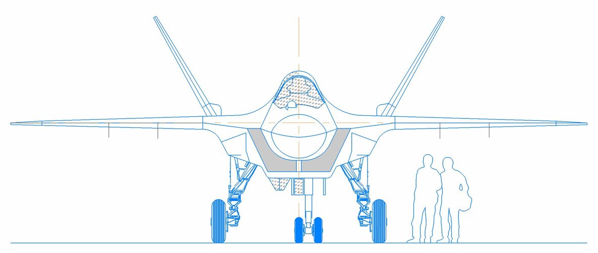

I just had a stray thought regarding the intake.
Sorry if what I'm proposing is utter nonsense. It has been pointed out that the intake area is rather small for such a powerful engine, but isn't it possible that the nose of the aircraft is designed so that it directs the air hitting the nosecone inside the intake? I know, that usually this is the last thing you want, since usually you don't want to direct turbulent boundary-layer air inside the engine, but I'm pretty sure that the shape of the airframe around the intake influences the thickness of the boundary layer. For example, I remember reading that the YF23 got away with a diverterless inlet in part because the intakes were placed backwards with a long flat surface in front of them, which reduced the thinckness of the boundary layer that needed to be dealt with. Imo, that would explain the unusually pointy nose on this sub-Mach 2 aircraft.
I think whats often not factored is that the intake isnt completely a chin intake. it goes out a little bit to the sides too, so there's a bit more air coming in than one would think
i also see the intake as a giant DSI duct, and one can see a slight bump too. some of the early fan made CGI and drawings may miss this, but its noticeable like in this picture
Considering the use of so many Su-57 parts (including literally the nose, apparently) in the mock-up it’s quite possible (probable?) that an actual representative aircraft will have the same general configuration of inlet but one that could differ considerably in final size and detailed shape.
I would have doubts about the current inlet size and geometry, at least in terms of what I have seen based on the current pictures.
Inlet looks plenty big enough to me - it only has to feed one engine. I think the tubbiness of the design make it look undersided.

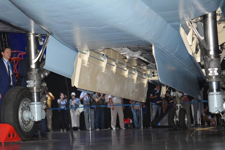

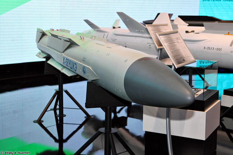

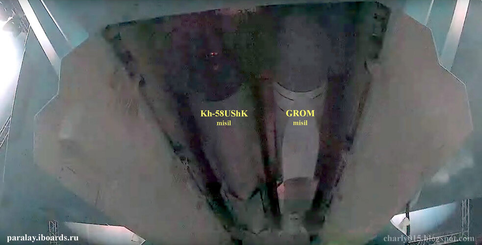

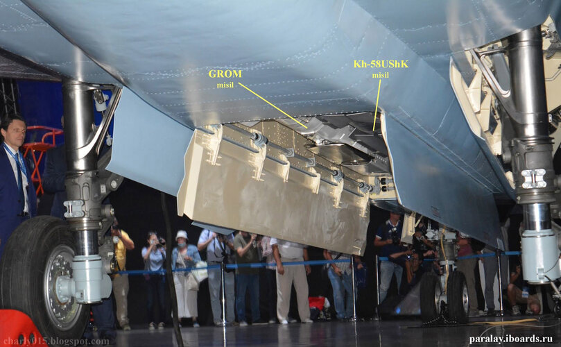

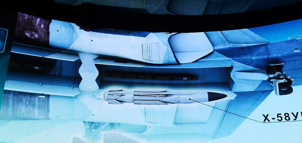

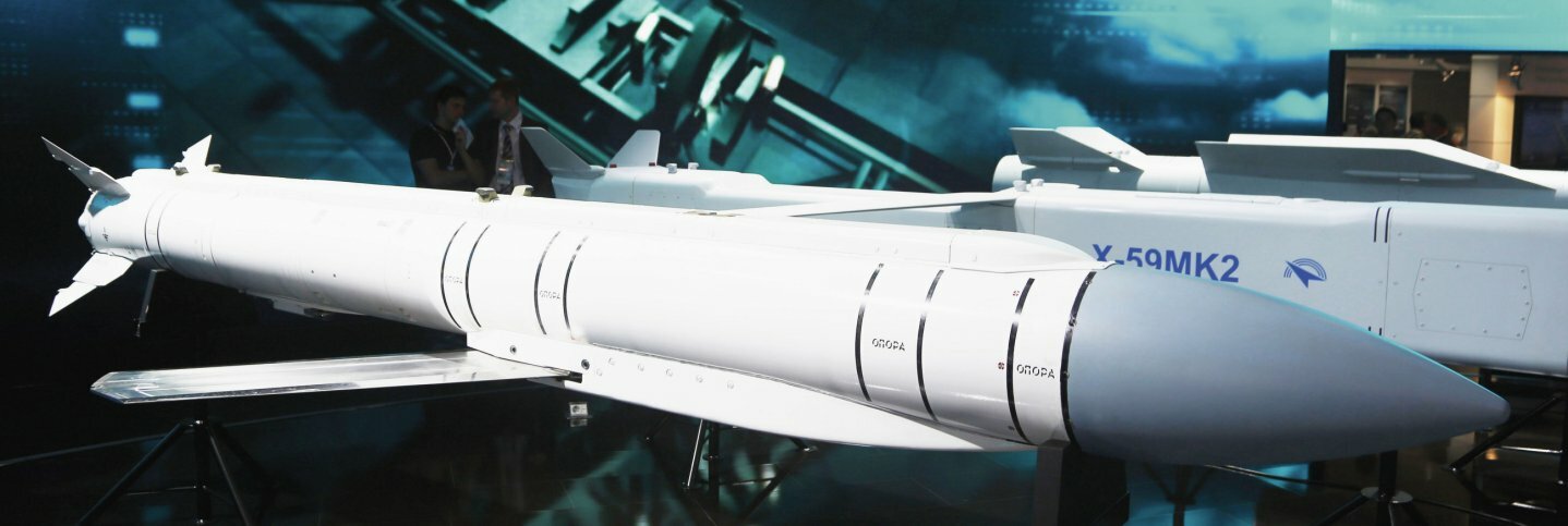

1 J-58UShK anti-radar missile (Kh-58UShK in English)
1 missile of the GROM family
Actually the Borisov model may be an early version, with a more straightforward DSI intake. This may be a further optimization where the nose is made thicker in the vertical plane for improved radar aperture. As a result, the intake is extended to the sides, and the result is an interesting DSI where the bump is in three planes at the same time. Also, the intake is brought forward for a less marked upside turning of the air duct, with the inled making part of that particular type of LERX. Not a trivial design at all...
length 17.25 m
span 12 m
height 4.7 m
So cross sectional area is 7.33 sqm? That is not small by any means...
engine compressor area- 0.67 m2
air intake area - 0.75m2
Much smaller than the Su-57... that reminds me of some discussions at the Su-57 thread xD

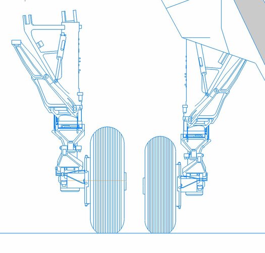

BTW, Paralay, are you using directly the landing gear of the Su-57? Does it fit? I mean, that landing gear is already big for a heavy fighter, for the LTS is pure monster truck style...
Russians have always been big on rough field take-off and landings though... they even put diverters in the Mig-29 and Su-27 to protect them from ingestion of debris.
I'm too lazy to draw , I changed the scale of the Su-57 chassis :)

Out of curiosity, how did you know the size of the wheel?
In general I think the sizing of the plane both based in the pictures with the tarp (it makes difficult to determine the scale using known parts since they are covered) and the pictures form the presentation (big distortion) is difficult to be made with precision, but I think the estimations between 17 and 18 m should be reasonable.
Another reference that can be used for placing the bay is that the engine needs to be afterwards, it measures ca. 5 m.
I read it somewhere, if I can found it again I'll link it here
