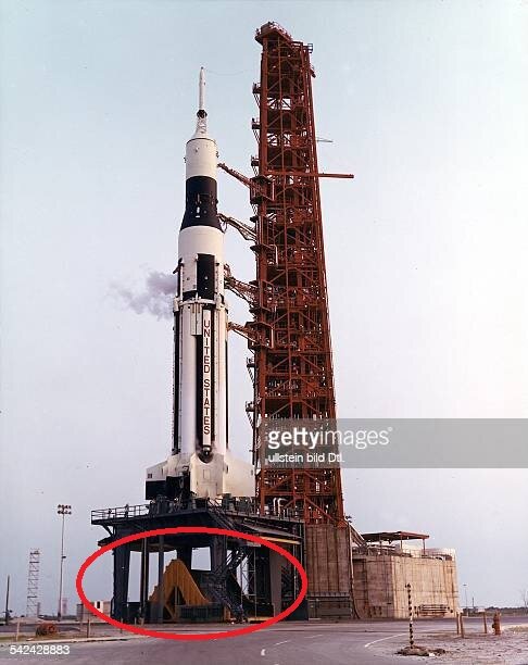

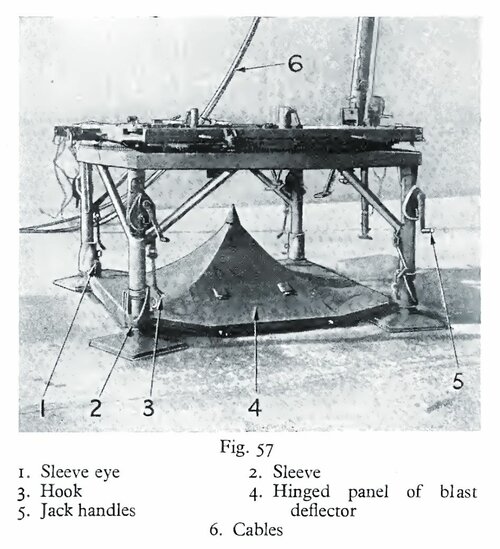

If nothing else, slide some engines over one of these:
If stand-alone Merlins were placed in an asterisk pattern around the existing pad and fired pointing away from it…might they form a “low” under the pad and help give SuperHeavy exhaust products some directionality?
I would think that might help the flame diverter.
