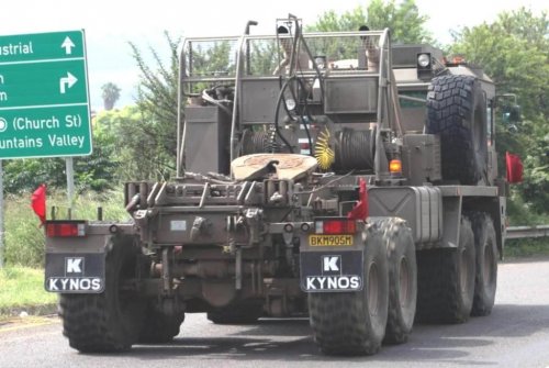

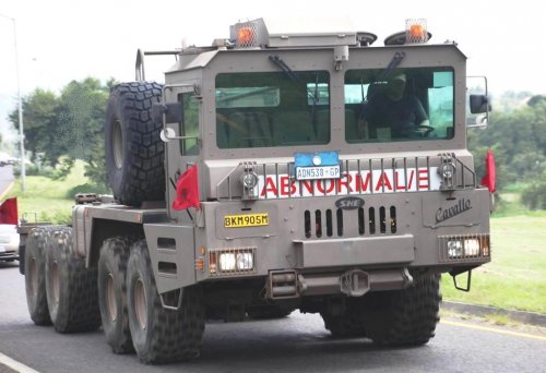

This is the Spanish Kynos Aljaba assembled in South Africa by SHE as the Cavallo (as seen by its badges) with a mine proof cab. These trucks entered service post Apartheid but were possibly selected before hand, or had some SA hand in their development, judging by their Deutz engines and SA-Spanish co-operation in the late 1970s, 1980s.

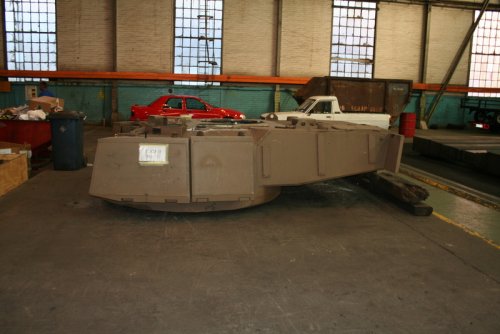

Plus here is a picture of a heavily modified Centurion turret before addition of appliqué armour for creation of an Olifant Mk 1B or Mk 2.
