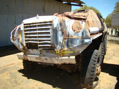

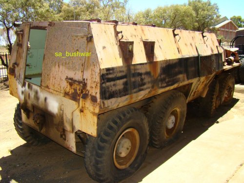

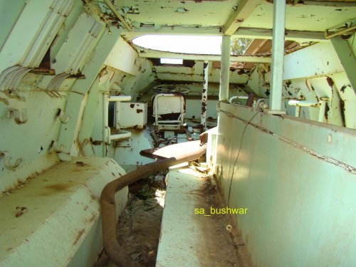

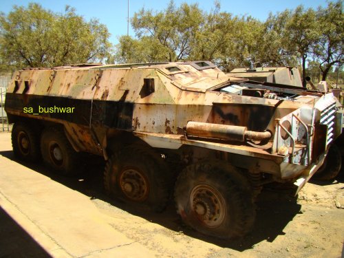

Anybody knows the history behind this prototype at the Bloemfontein armour museum? The 2 rear axles are from a 6x6 Magirus Deutz gun tractor used by the SA field artillery till replaced by the SAMIL 100's.

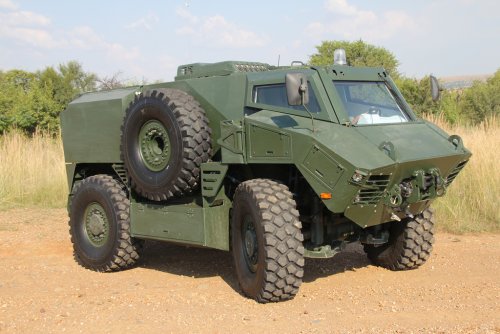

New BAE RG-35?
Thanks JAZZ. There's more difference between the original 6x6 prototype and the 4x4 then was first apparent.
Nice pics, sa-bushwar.
That last vehicle you posted, I've never seen it before.
It has vision firing ports on the sides, as well as bench type seats at the back, with outward opening roof hatches over the troop(?) compartment. Rear and side doors for dismounting. There also appears to be an aperture for a turret over the centre part of the hull. So probably an Infantry combat vehicle prototype? Maybe based on Samil components?
Fascinating.
I'm due to go to South Africa in December, and feel that a trip to the Armour Museum in Bloemfontein is an absolute must. Just got to keep the wife and daughter occupied with something else at the same time.... ;)
Thx for clearing up a mystery for me!(dankie M.) ;)
Always wondered about in the vehicle in the background...,I have to wonder tho if this proto took at least some inspiration from captured FAPLA BTR152's in Angolsch?

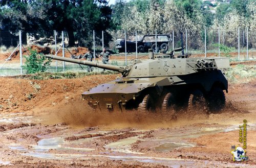

Hey, nice catch, curious george! I've seen that Rooikat photo before, but never noticed that vehicle parked in the backround. It appears to be the same vehicle.
My basic analysis above is just me guessing what this vehicles intended role was, going by what I can see on the photo.
I may be completely wrong though.

New BAE RG-35?
That, my friends, is the BAE submission for the Canadian TAP-V requirement. This is from the Ares article linked below:
We’ve known for some time that the company was submitting a refitted RG-35 to the Canadians, but the company said today that it’s 4x4 RG35 RPU is about 5.2m long, 2.6m wide, and with a ground clearance of 414 millimeters, and has a gross vehicle mass of 21,000kg with a payload of 3,000kg and seats a driver plus 9 crew members. The TAP-V, which is being pegged as the replacement to Canada’s RG31 and Coyote reconnaissance, will be used by Canadian forces in a reconnaissance role on the battlefield, and domestically as a general utility vehicle. An award for the TAP-V contract of 500 vehicles is due this fall.
http://www.aviationweek.com/aw/blogs/defense/index.jsp?plckController=Blog&plckBlogPage=BlogViewPost&newspaperUserId=27ec4a53-dcc8-42d0-bd3a-01329aef79a7&plckPostId=Blog%3a27ec4a53-dcc8-42d0-bd3a-01329aef79a7Post%3a94409f5d-37d4-4e87-8eb4-540cf7ed14c0&plckScript=blogScript&plckElementId=blogDest
Here's a bit more on the TAP-V requirement and it's place within the overall FLCS (Family of Land Combat Systems) program:
http://www.casr.ca/bg-army-combat-systems-flcs.htm#tapv
http://www.casr.ca/doc-dnd-armour-tapv.htm
Grey Havoc said:
That, my friends, is the BAE submission for the Canadian TAP-V requirement...
It is indeed. But, just to be anal-retentive, no hyphen in DND's TAPV designation (not sure if that errant hyphen got stuck in by Aviation Week or Defense Update).
It'll be interesting to see whether the Canadian Forces' overall experience with product support for the APV (RG 31) will be a detriment or work in South Africa's favour. It'll also be interesting to see what RWS BAE will pair the RG35 with. The SD-ROW is too small for TAPV and the TRT-25 may be too big.

Never seen this vehicle before. I would guess it might predate the Ratel, i.e. an ICV based on Magirus components (funny front axles though) in a conventional lay-out. Biggest problem is poor forward visibility; always the case with a front-engined vehicle with solid axles, unless the vehicle is very high.

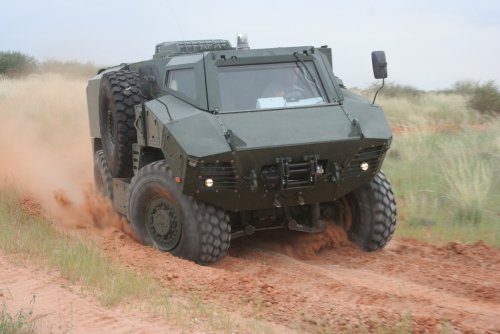

The TAPV has independent suspension, like the RG 41 and unlike the solid axles of the RG 35. The suspension units of the TAPV look a bit like TAK 4 units.
To me at least, the crew compartment looks narrower as well, there has clearly been a deliberate effort to make sure the wheels are outside the footprint of the crew compartment. The more I look at this vehicle the less it seems to have in common with its supposed 6x6 family member.

The vehicle in the background is the same one I posted photos of in post 205. it apears to have a Magirus Deutz aircooled V8 engine. The Rooikat photo must have been taken at Armour School in Bloemfontein.

Thanks for the reply RAD72. Good suspension is one of the definers for TAPV. The Mobile Survivable Vehicle has the same Timoney system as ASV. The Cougar 4x4 and Oshkosh prototype have TAK-4. The RG35 RPU has AxleTech ISAS, etc. I'm not sure that any of this independant suspension systems give an edge to a particular contender.
Reply to post #227
They are all double wishbone setups with coil springs. You're probably right; all much of a muchness.
Yes, that was my sense too Herman. The Timoney system has been around a bit longer perhaps. Has anyone heard of any problems with the Timoney suspension, Axletech 4500 series ISAS, or TAK-4?

That vehicle posted by sa-bushwar in post 205, the 8x8 vehicle that appears to be an ICV with Magirus Deutz components.
I wonder what time frame it is.
It could be, as has already been speculated, a prototype in the original ratel ICV competition, which is back in the 1970's. But I wonder also if perhaps it could have been part of an excercise in parts standardisation? The SAMIL's are modified "ruggedized" Magirus Deutz's, and much like the Buffel APC that was initially frowned upon in some quarters due to it's Unimog components, I wonder if this wasn't a stab at producing something with parts commonality with the large SAMIL truck fleet in the SADF? There was the project to design a Buffel APC type vehicle that used SAMIL 20 components in the Rhino and Bulldog APC's.
Again, just speculation on my part.
