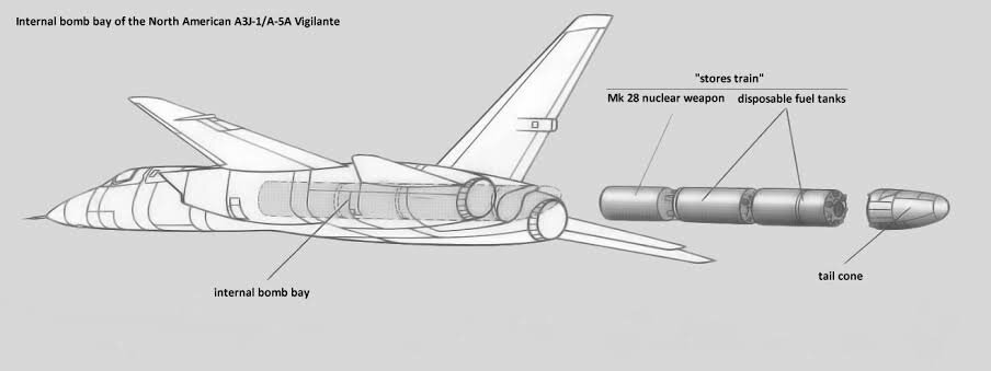

For now, I am rather suspicious of bay depth here. Length, no problem, but depth...
Here the space that bombers usually use for deep bay is taken by 3rd engine and its intake system.
Which, by the way, is also a strong indicator against a2g focus.
And, vise versa, bomber doesn't really need that high a T:W ratio.

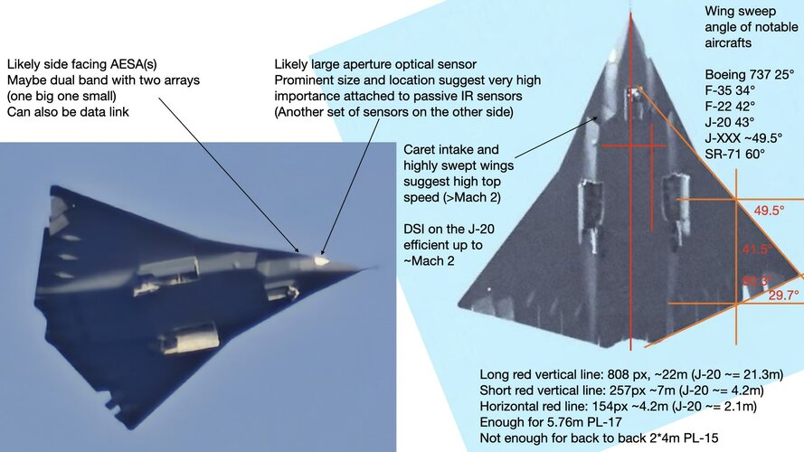

I think we can agree on cruiser; I am just not seeing why air targets would justify such a long ranged design. That would be a lot of effort to kills some E-2s, or alternatively pick a fight with tankers near Guam. Why would range be necessary over Japanese or Philippine islands, let alone Taiwan?

I would also add that people thinking this is primarily a bomber are overestimating its size a little bit and underestimating the payload you'd actually want for a proper bomber.
This thing is big yes with a voluminous fuselage and huge wingspan, but it looks only marginally longer than a J-20.

In the bomber version, the engine could be removed and replaced with a tubular bay, like in the A5 attack aircraft, so that it could be loaded with a large strike weapon the size of at least a Dagger missile, or something small

Not bad, but the lateral intakes are bog standard caret types, including diverter gaps toward both the fuselage and LERX. As red admiral points out the beam of the main landing gear bogie appears to be on the outside rather than inside, too.

Also the large delta is probably more for stealth and yaw control than speed as alleged here and there.
If speed was the goal, the dorsal intake would be rather different.
Seems that way to me as well. I agree that, while clearly supersonic, it's probably not as fast as some people appear to think. Going by the relatively steep angles of the caret intake lips (over which the shock will fit like a 'lid' at design Mach), this thing is probably intended to stay below Mach 2.0, but cruise there for long distances. I would not even be greatly surprised to learn that it doesn't have afterburners. That is more in line with a long-range strike aircraft than an interceptor, but of course one has to be wary about extrapolating conventional wisdom to a potentially novel concept. Maybe in an upcoming era of CCAs and possibly eventually DEWs, that's exactly what fighters are like?

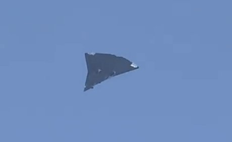

New Chinese combat aircraft broke cover in a flood of social media photos and videos on Dec. 26 showing them in flight and revealing two new examples of China’s evolution as an aerospace innovator.
One new aircraft appeared in social media posts revealing a large, three-engine warplane with a cockpit and diamond-style wing with no vertical tails. Yaw control appears to be managed by Northrop Grumman B-2-style split rudders.
The engines are fed by a single dorsal inlet and two ventral inlets, the latter using caret-shaped intakes. The dorsal inlet features a stealth-enhancing diverterless supersonic inlet, but not the ventral inlets.
The aircraft’s large ventral fuselage section likely provides room for an internal weapons bay. The main landing gear features two wheels each, a hallmark of heavy fighter-bombers, such as the Sukhoi Su-34.
The apparent test flight over a populated Chinese area included appearances by a Chengdu-manufactured J-20S fighter, possibly flying a chase mission.
“It’s size and arrangement tentatively suggests that this is the long awaited J/H-XX ‘regional bomber’, designed to provide a low observable high altitude precision strike capability against bases and possibly ships throughout the Indo-Pacific,” said Justin Bronk, senior research fellow for Airpower and Technology at the Royal United Services Institute. “However, it remains possible that this prototype represents China’s known 6th Generation fighter program.”
Hours later, further social media posts revealed images and video of a second new Chinese combat aircraft, also in flight test.
The images show a more traditional fighter design with a cranked arrow planform and possibly folding tailfins. It was not immediately clear when these images were captured, but one post marked the picture with a Dec. 22, 2024 time-stamp.
