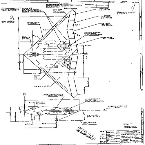

Incredible that if we remove one engine and cut off the "neck" of the SAC J-XD planform, we can arrive at this design that Boeing thought out... 20 years ago! Convergent engineering indeed.
The Boeing 988-123 is detailed in a NASA report linked to in this thread. You will find it is designed to be a highly manoeuvrable strike aircraft designed for a joint force customer (USAF and USN).

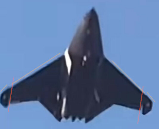

On another note, I wonder why the control surfaces actuator fairings are angled completely tilted from the air flow direction. Is there a particular structural/mechanical challenge here or they double as some novel lifting devices?

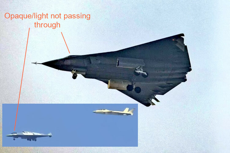

I think this might be a fake canopy painted black where the cockpit is located to fool observers.
The aircraft might have small slits like the ones seen on the B-21.
Fully movable wingtips on the other aircraft:

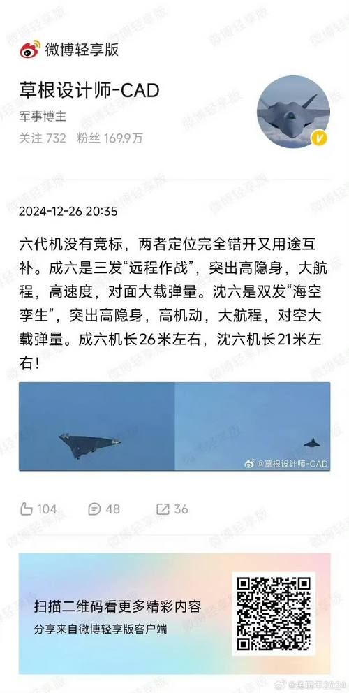

The designations being used are J-XDS (Shenyang) and J-36 (Chengdu).
There is a lot of speculation flying around an "insider" post saying that we've seen two of the "tea cups" from the "tea set" but not the "tea pot". Meaning like NGAD this is a family of systems and we haven't see the most important one yet.

"There will not be a bid for (the Chinese) sixth generation fighters. Both of them have completely different designated roles while complimenting each other. CAC’s sixth generation prototype is a triple powerplant (designed for) “long range combat”, emphasizing on high stealth, large combat range, high speed and high munition carrying capacity. SAC’s sixth generation prototype is a dual powerplant (designed for) “sea-air twinning (probably has a carrier-based version?)”, emphasizing on stealth, supermaneuvrability, large combat range, high AAM carrying capacity. CAC’s prototype is around 26 meters long, (while) SAC’s prototype is around 21 meters long!

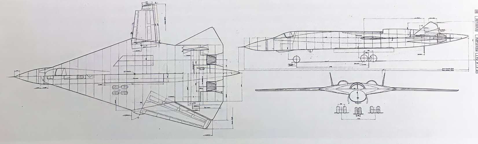

During the 2000s a medium size/medium range supersonic stealth fighter bomber concept (JH-XX? Project 176?) was studied by the 601 Institute. It featured a tailless swept wing design with a twin seat cockpit. A mock-up (head section?) was constructed at SAC during 2013. A recent rumor (August 2022) suggested that the JH-XX project might have progressed into the prototype manufacturing stage at SAC. The latest images suggested that another new 6th generation fighter prototype besides J-36 (see above) flew for the first time on December 22, 2024 over the sky of Shenyang. The aircraft appears more like a multirole stealth fighter (J-XX) rather than a traditional fighter bomber. It features tailless "lambda" shaped swept wings with two movable tail fins with adjustable slant angles, depending on the flight situations of the aircraft. This "adjustable tail fin" design has two main positions: the "horizontal" position allows J-XX to achieve maximum stealth and minimum drag, while the "vertical” position allows J-XX to achieve maximum maneuverability. J-XX also features two DSI engine intakes underneath the wings with an internal weapons bay in between. An EOTS is installed underneath the nose. The aircraft could be powered by two WS-15 turbofans, but it is unclear whether they have TVC nozzles or not. Compared to J-36, J-XX appears slightly smaller but is also capable of flying various air-to-air and air-to-ground missions. Currently it is unclear whether J-36 and J-XX will enter the service with PLAAF together or they will compete against each other.
