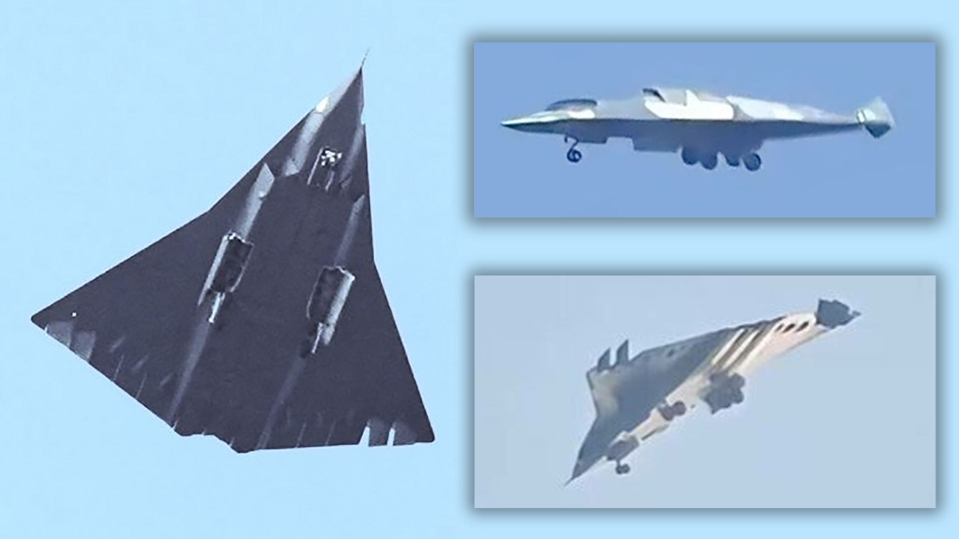

There are lots of interesting design choices on this aircraft...
View attachment 753717View attachment 753718

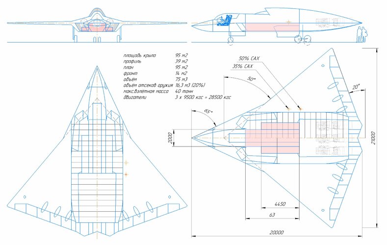

Edit: View attachment 753731

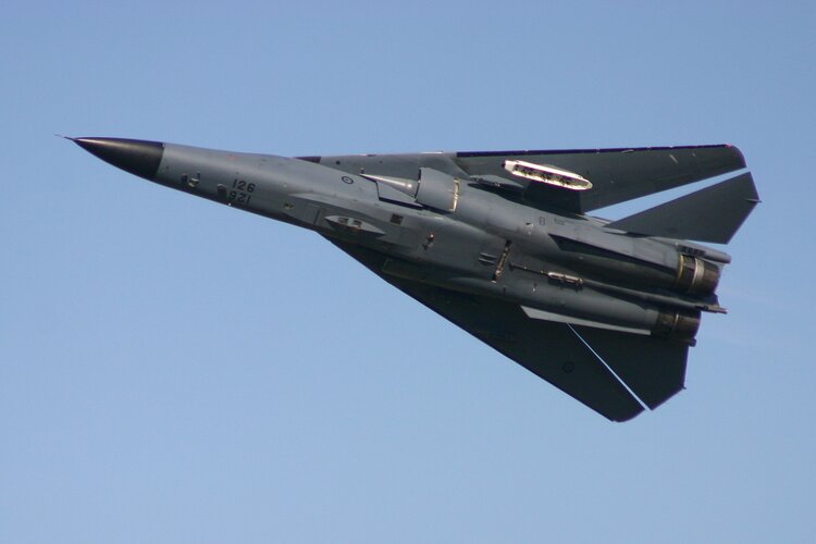

Looking at the trailing edge and wondering why they went with all the segments instead of a single, flexible trailing edge like the AFTI F-111.

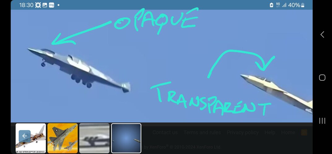

Looking at the size I think this is a strike fighter, analogous to the b-21 but faster. Might be more like a modern tu-22 design. What are the shinny windows on the side? Sensor windows? Side radars? Or actual windows?

Aside from the fact that they apparently decided to use three engines, it is really surprising that they use two different types of air intakes.
What can we conclude from this? Two different types of engines for different flight regimes as a workaround, because they currently don`t have variable cycle engines available?
Nevermind the small ones on the nose, side views show two huge light coloured panels running almost half the fuselage length. Embedded antennas, or perhaps the kind of reflective mirror-like panels seen on F-35 and F-22 recently?
I'm far from convinced as they have much lower fineness ratio and definely non-optimal area ruling. I would not expect great supersonic performance - possibly needed to add the third engine to get sufficient thrust? I also really doubt long range - with those intake ducts and engines and payload bay then I'd think fuel fraction would be low simply from running out of volume.
To me then these say TDPs - wonder whether they are demonstrating anything other than a "medium fineness" tailless configuration, like X-36 did back in the 90s
Yes, fuselage volume is EE Lightning-esque perhaps. I do wonder if the three engines and intakes are to allow a bigger/wider weapons bay.
Stealth generally means adding some bulk too so it's an interesting set of things they seem to be balancing.
Third engine maintenance challenges also makes me wonder if they got the balance right or are trying to trounce the competition in some key parameter.

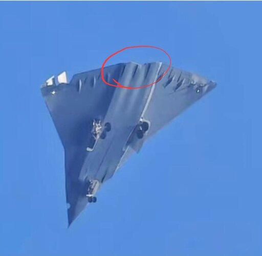

The tips aren't rounded that's probably compression or from ai image enhancers, from other angles the tips are flat
I just reviewed everything here from today, to include the artwork, it's appears that they are rounded, or atleast contoured

Good point. But if my bomber is optionally manned - and any satcom on something like this would be conformal these days, so that's a cockpit - wouldn't I put someone on board for the first flight? Or is it a light effect through a low-profile tinted canopy?

Approximately, the area of the side air intakes corresponds to a compressor diameter of 1050 mm
Isn't RD-33 class engines on the small size? Roughly the same power can be had from two AL-41/51 class engines, ie WS-10/15. Indeed, a 1050mm compressor diameter suggest AL-41/51 class engines, which also means the weight could be well over 50 tons. Maybe this can be judged as a sort of modern-day chinese T-60 concept?
