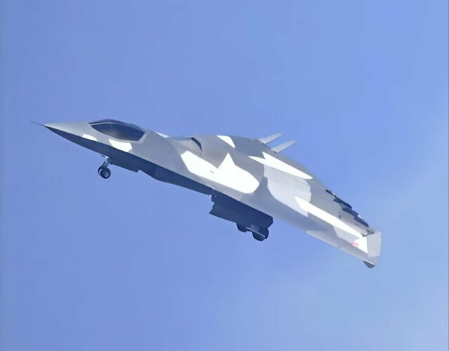

The combination of 2 x Caret and 1 x DSI intake is odd - I thought immediately that the Caret intakes suggests speeds above Mach 1.8 would be in play but then the top DSI inlet makes less sense.
Despite the radically different shape it does have something of a J-20 feel about it, so I wonder if there is some elements of commonality under the skin.
My gut feeling is this is something conceptually like the Sukhoi T-60 but designed with a greater understanding of stealth, but then I can't see the need for three engines. T-60 made do with 2 AL-31F for 60,000kg class aircraft. Maybe 3 x WS-19?
Brute force supercruise? But then why not make it longer and more slender?

3 engines, or 500+ kn of thrust for this J36 plane might make sense if one looks at it as a multirole fighter. That it absolutely needs to accelerate like hell, gain altitude quickly, fly high, cruise supersonically, perform well on a broad range of altitudes and speeds and use short runways on top of everything. Given the obvious range and payload requirement, to pull all that off, only a very very large plane would suffice. And to keep it fighter like, two engines simply might not have sufficed.
Alternatively, maybe it's not such a high performance fighter but then some engine/s are really there to be used for certain flight segments while others are used for remaining flight segments. It's highly inefficient, of course, wasting so much weight and room, but we don't know the requirements. It may've made sense to the customer and the desingers of the plane.
As said before, if that is a tri-engined aircraft, probably a twin Turbojet with a turbofan. You would use the fan as range extender and keep the Jets burning for performances domain (TakeOff, acceleration, combat).
Then if a twin, the dorsal inlet might add the airflow needed for cruise, keeping the carret inlets small enough to make the S-duct compatible with volume restricted arrangement.
Then people see the dorsal as a DSI. But if that was simply a wall that separate airflow from the left and right engines?
Caret intakes are not inherently more suitable for higher speeds, both types can basically be designed for whatever operating point is desired. The problem (shared by both) is that they are fixed-geometry, which means their performance deteriorates in off-design conditions, so if they (either type) are optimized for Mach >2.0, efficiency at M1.5 might drop to an unacceptable level. In aircraft expected to spend substantial amounts of of time cruising in the latter regime, accommodating speeds above M2.0 is probably not going to happen, or some form of variability needs to be introduced.
What type you choose mainly comes down to other requirements, including airframe integration. With the result that you might easily go for a different type on the same aircraft, depending solely on where it is located.

If the canopy is really that black thing and it's not painted over to hide details, they might have come up with something different (better?) than thin layers of gold or indium tin oxide.

I’m thinking this is a technology demonstrator, with the relatively known caret intakes in a low risk area, with the ventral DSI intake (kind of looks like an upside down Su-75 intake) in the high risk location. Simulations may say it works, but you don’t know how it will really behave at off design conditions. If the center engine stalls due to excessive inlet distortion, you have the two outboard engines to bring you back home. The upper inlet may even be designed as a modular system, where you can swap different variations for performance validation.
It seems to have bomb bays and nose mounted sensors. That seems like a lot for a TD, though perhaps those areas are mock ups just for intimidation. But would not so many operational looking features suggest more of a prototype?

As an aside, I don't think this specific airframe has any mission sensors installed, which is normal for the first prototype/demonstrator.
Those optics/radar cheecks may in fact be not empty. Otherwise could've been simply covers.

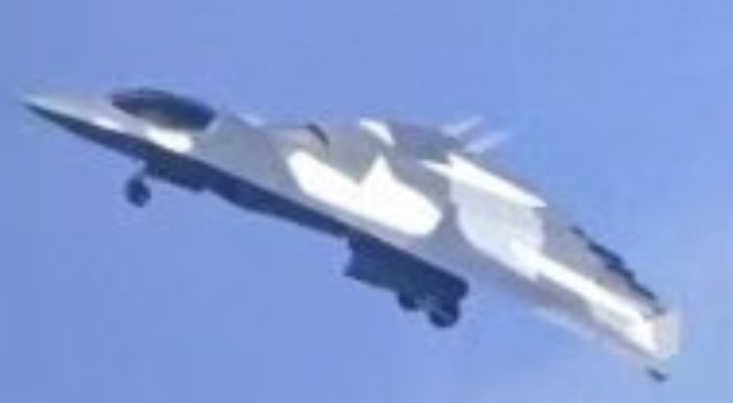

There is a very clear picture somewhere on the internet. I'm at work so give me some time before I can find it lol.
doesn't worth it as this is just enchanced or ai-ted original
