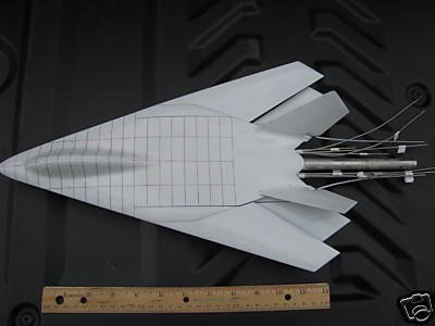

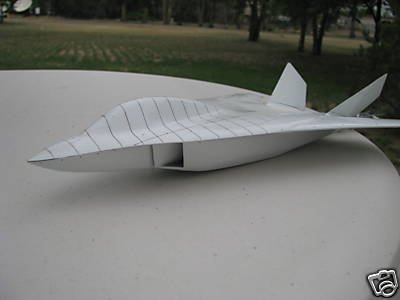

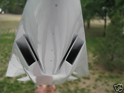

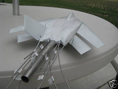

I saw a model of the Boeing AX (which it probably is, rather than an AFX) on the desk of their JSF program manager, Micky Michellich, around 1996-97. Sort of a stealthy A-6. AX, if I recall correctly, was an A-12 with some of the requirements, such as LO and internal payload, relaxed.
Currently up for bid on ebay. Item number 250258629386.

You know, looking at that model I think it resembles a naval version of the original Lockheed Martin ATF submission. Remember that back then NATF was in the mix so they'd have had to have at least SOME idea of what they were going to do in that area at the time of submission. Anybody know for sure?
Why is the nose so much shorter on the A/F-X compared to the earlier NATF concept and the F-22A? It does not look like there would be room for any form of the APG-77 radar.

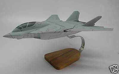

Saw this on ebay:
$165 is a little steep though.
another mahogany monster made after Flight International drawings
not 'original' one

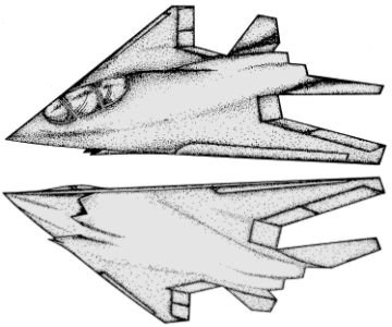

On the AWST article discussing the companies involved and their proposals, it says Northrop joined the General Dynamics and McDonnell Douglas team which was proposing the A-12 based design. Yet on Matej's website these pictures are shown of a different Northrop A-X (or A/F-X) model.
I will presume Northrop was working independently on this, so what led to them teaming up with GD and McDonnell Douglas on their proposal? Personally I find this a very interesting looking design.
This was the design that originated in Northrop, but they joined General Dynamics to work on it. Teaming was a very common word in that era and I think that there was not any company, that was able to win that kind of competition independently. Besides, name "Northrop" didn't have very good reputation then, mainly because the overcosts of B-2 (the same situation as with Lockheed during their C-5 program).
And please do not use hotlinking of the images from my web. If nothing more, than I am going to update this particular file, which change the paths and names of the images, so all your links wont work then.
According to the previous chart however they joined the GD and MDD team working on that A-12 variant. Did this separate proposal of Northrop and GD just happen to be not included on that list?
