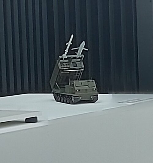

I mean theorie says there is a possibility of having the ability to fit 2 JASSM ER per pod.

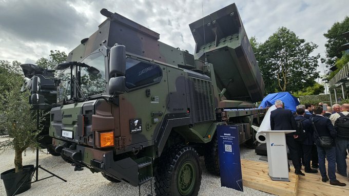

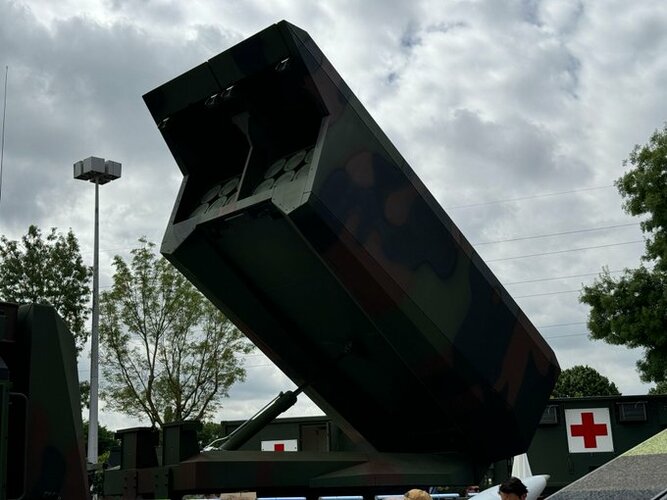

"At Eurosatory, first models of the MBDA-Safran proposal on the “French Himars” program, aka Long Range Land Strike (FLP-T)"
Seen here in the image to the left alongside the MBDA JFS-M proposed for Germany...and something else with a booster and waht appears to be a wing on top...
View: https://x.com/VincentLamigeon/status/1802603366364684465
It looks interresting. More conventional like EXTRA or GMLRS and Not Like GMLRS-ER.
Lets wait and see what they say are the capabilitys of that missile.
Looks like JFS-M has dropped from 3 a pod to 2.
Different point of view which makes the missile in the left look more like a cruise missile.
Really short wings for a cruise missile though, very intriguing

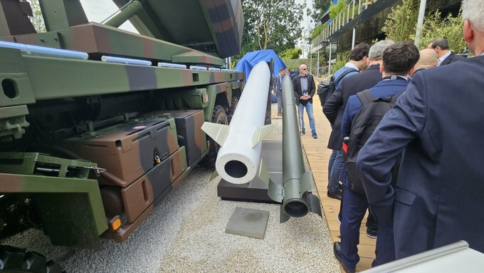

Well that settles the range question for LPS then...because thats not a 80km missile....thats more like 150km with the second stage...
Does it imply there is an unboosted version for other platforms as well....
EDIT - It's been confirmed it is in fact based on Spear....so it should have very long range, far beyond 150km...given its twice as long as Spear, and slightly wider its probably at least 250-300km
