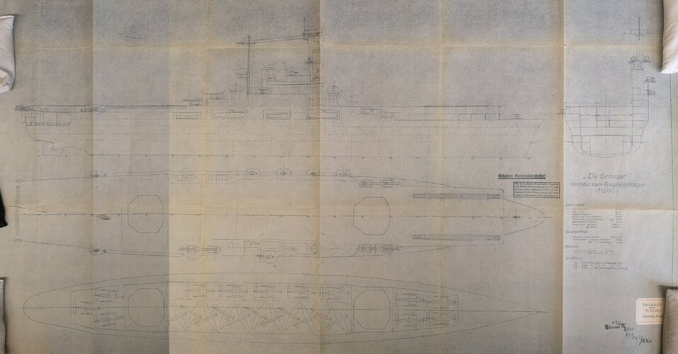

I have found these blueprints on the disc you have on first page. I thought that this is H-40 B but the length isn´t right and superstructure is same as on H-39.
Left one is steam turbine powered design and right side is H-39/42, bigger than H-39 (close to H-41 size), there's one preliminary H-39 with 16x15cm guns (only data) in RM-6.
Left one is steam turbine powered design and right side is H-39/42, bigger than H-39 (close to H-41 size) and have more AA batteries, there's one preliminary H-39 with 16x15cm guns (only data) in RM-6.
H-39/42? Is H-39 design redesigned in 1942? If I know correctly isn't construction of battleship 'H' already halted then?
A mistake on my part here, H-39/42 doesn't have more AA batteries, its identical finalized H-39, the hull is just bigger and longer, halted doesn't stop you from improving design though (H-42,43 and 44 say hi!), H-39/42 from my guessing is compromise between H-39 and 41, justify its massive size and weight and 42cm/48 if not make in time then 40cm/52 'll be used instead.
Here's dimensions compare with H-39 and H-39/42.
-Length: 266 m vs 282 m (at waterline only).
-Draft: 10 m vs 12 m
-Beam: 37m vs 40.5 m
H-39/42 have full load displacement at 79000 tons (slightly more than H-41), machinery same as H-39 (12xMAN diesels, 3 shafts), same horsepower just slower than 2 knots (28 knots vs 30 knots)
