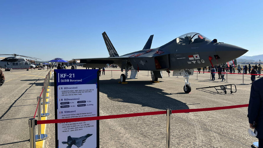

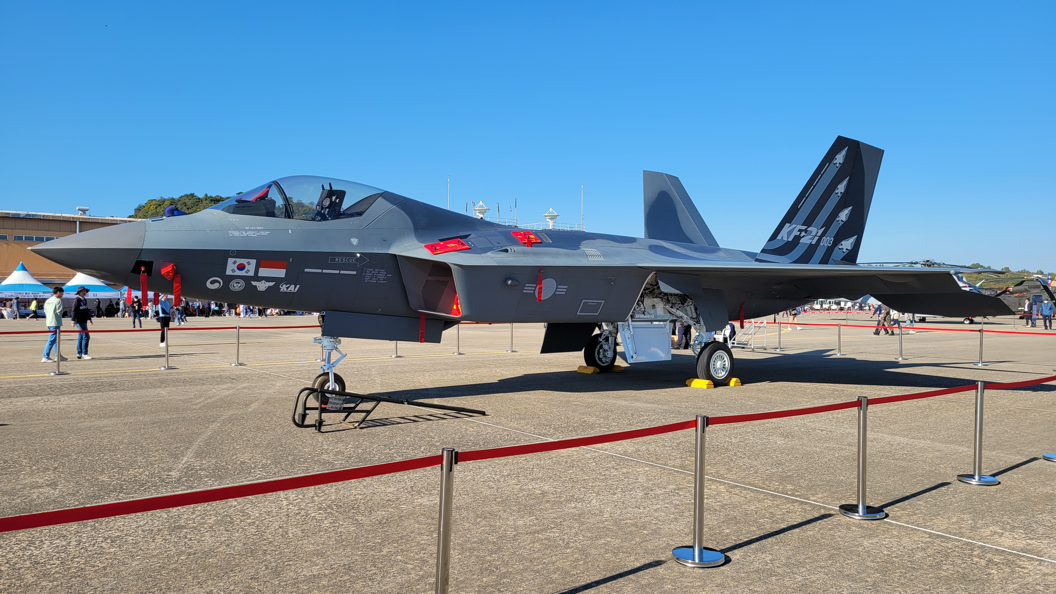

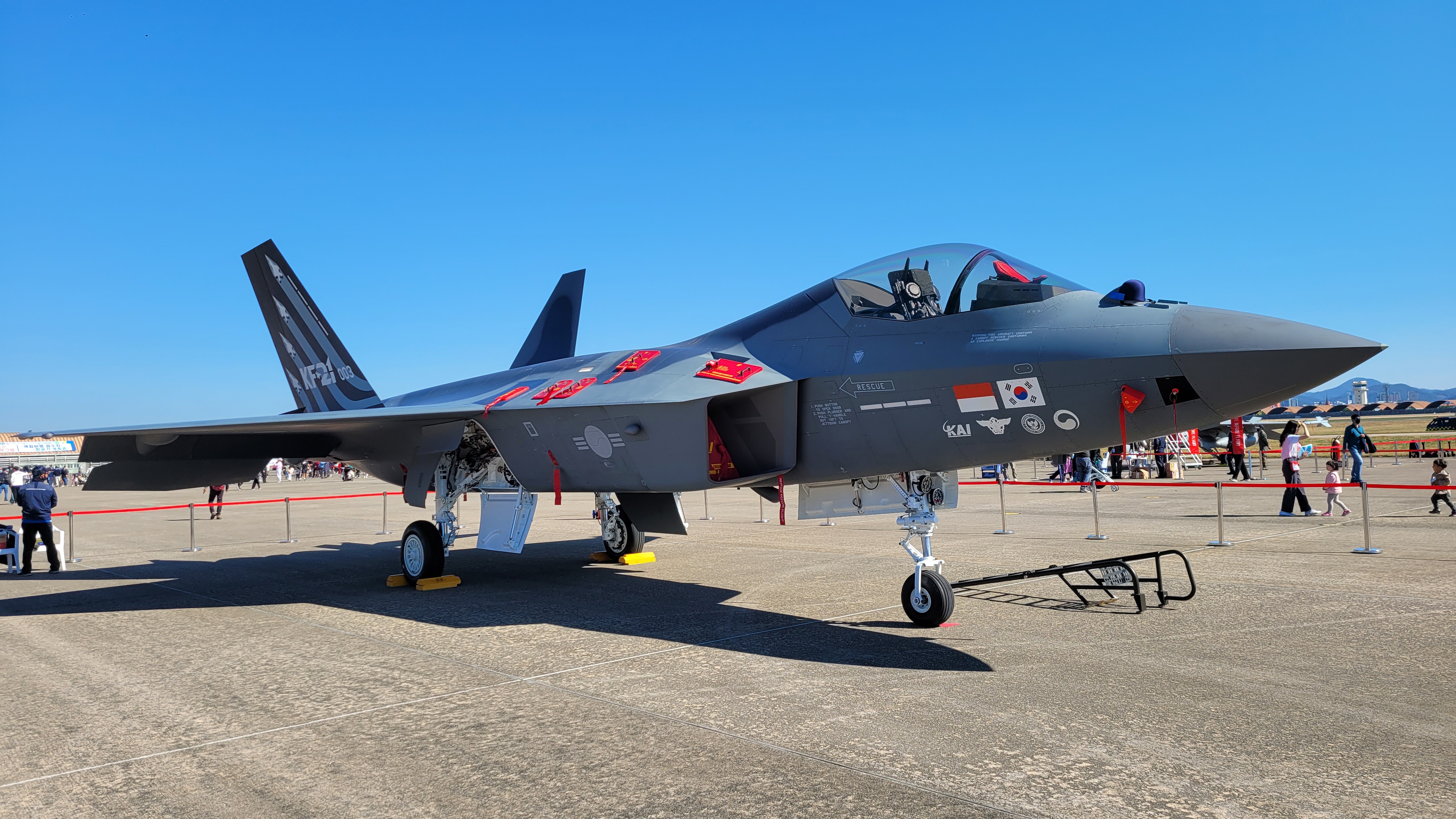

anyone here based in South Korea? looks like an opportunity to see the KF-21 in person will come soon
LAH's flight and static display of kf21 is planned
Source Bemil

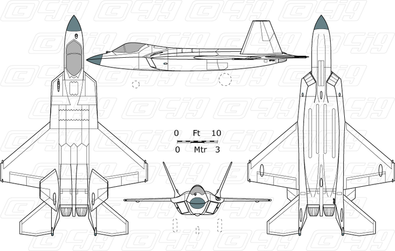

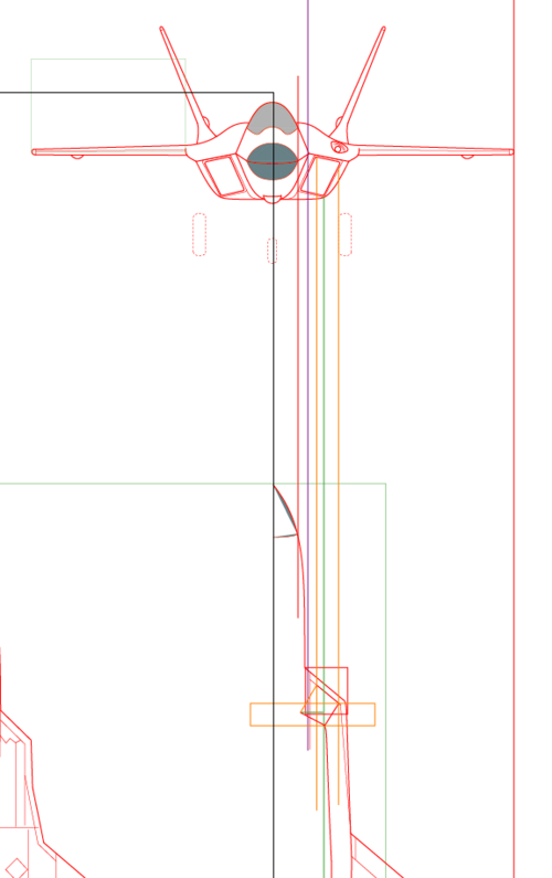

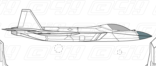

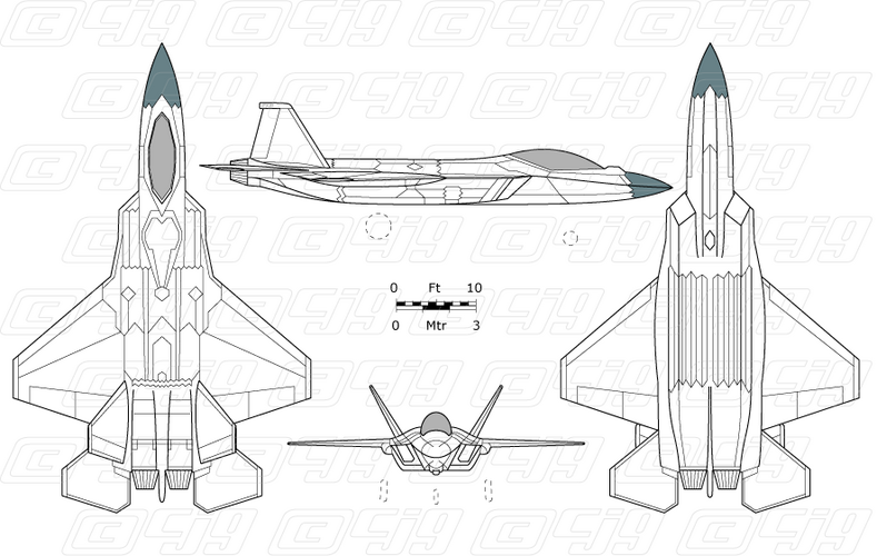

Since you're open to critique :) The canopy isn't quite right (see attached image) and the chine incidence angle should be near-horizontal (virtually the same as that of the LERX). I also suspect the leading/trailing edge sweep angles are a bit too steep, in fact on the vertical tails, the TE appears to be steeper than the LE. And of course the flap/aileron hinge lines are parallel to the wing TE.
Excellent! I'll have a look at those. Trouble with working from photos.

Vertical tails are bigger
Canopy too steep

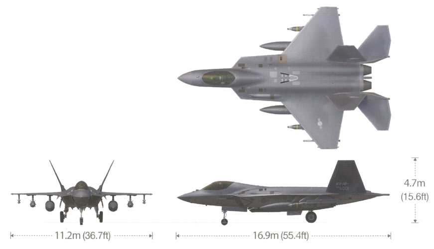

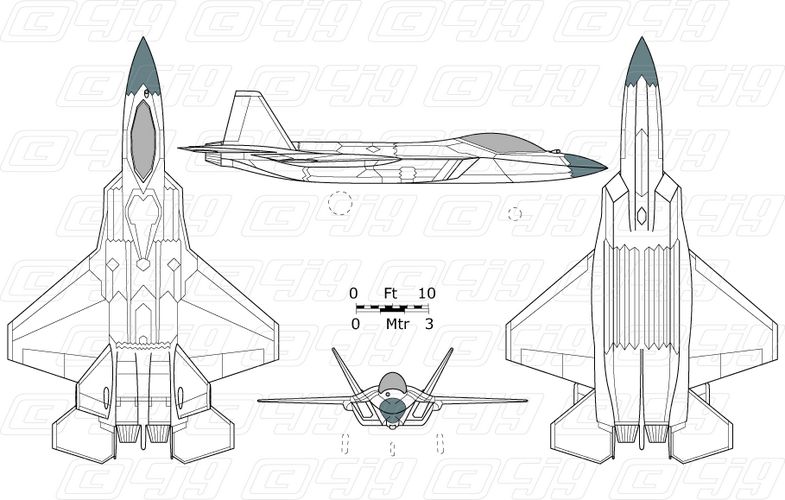

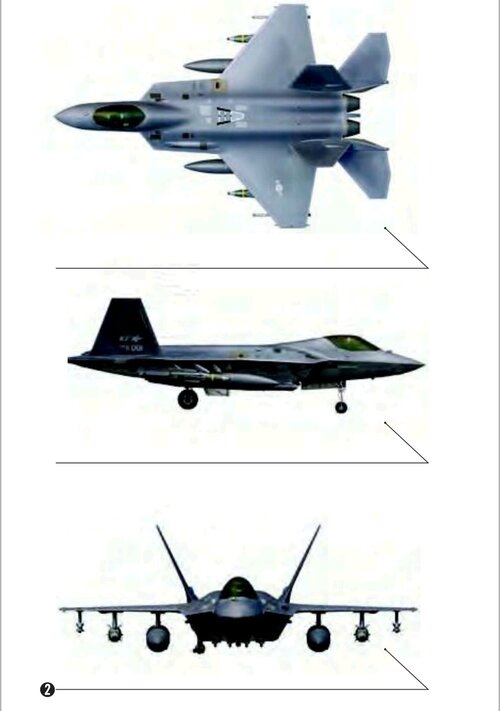

Well, the one from Yonhap News doesn't 'line up'. Spans don't match in plan and front elevation. What I'm finding is that they are all different, but that's always been the trouble with GAs. Why I prefer to use photos. Maybe I'm pedantitc.
Chris
Back to the drawing board. Work in progress.

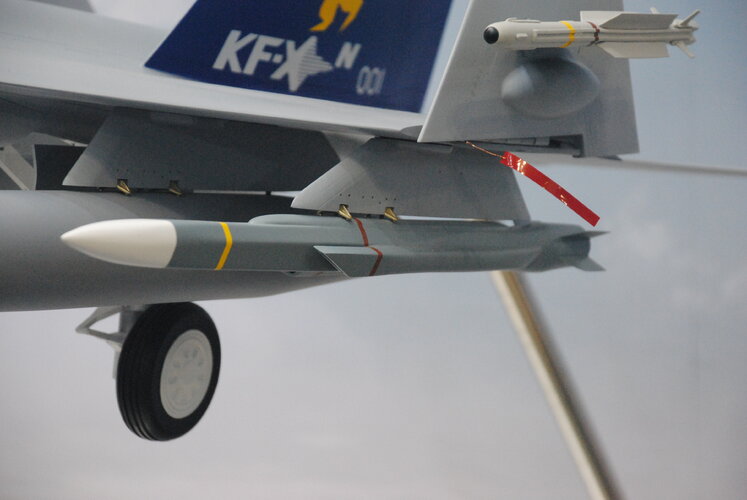

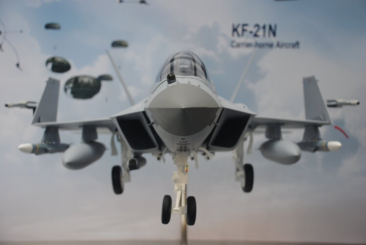

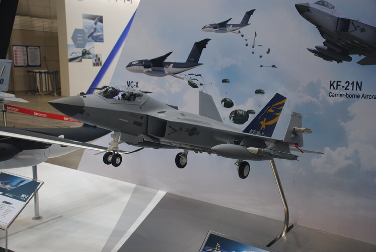

there is a KF-21N 1/10 scale model (proposal only)
Weapon on wing is ramjet-propelled-cruise missile
(proposal only)
First ever time that I have seen the cruise missile, any ideas as to the specifications of the missile?
Best guess is
https://www.navalnews.com/naval-new...p-missile-for-south-koreas-kf-x-breaks-cover/
specification is unknown

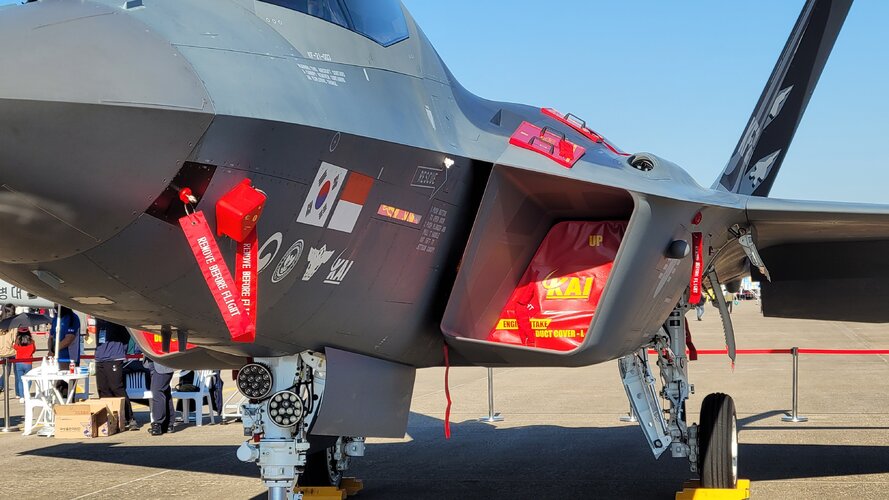

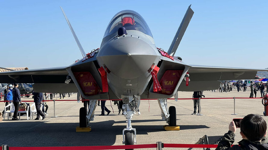

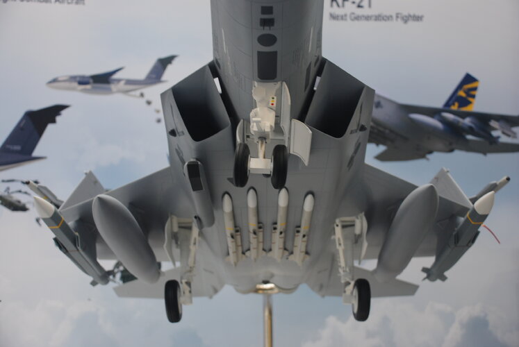

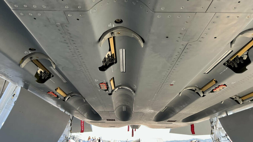

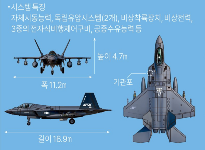

On the comparisons with F-35 and other aircraft, does anyone know what the internal payload bay capacity is? They look pretty small to me i.e. maybe 4 x AMRAAM-size weapons, but looks challenging to carry air-to-surface weapons or much of a mixed load.
here is the cut away of the fueselage showing where the bays are. Of course, this current aircraft covers the bay with those semi-recessed panels.
But assuming those recessed areas are the size of a Meteor, it looks like 2 each bay, maybe 3

Could you fit a 2,000 lbs jadam in there? It seems bigger the the f-22s Bay anyway.
Seems unlikely to me if it's designed around 2 X AMRAAM or 4xSDB. It's quite a lot smaller than F-22 bay. Probably need extra depth for 2k JDAM
