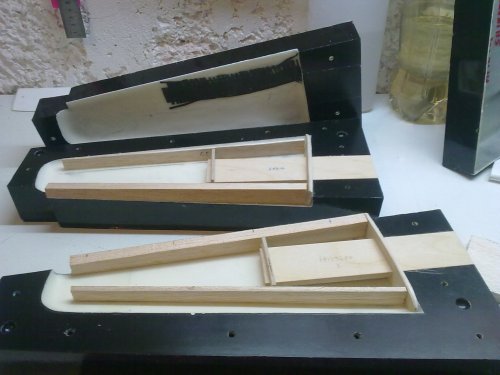

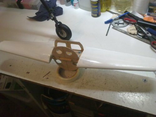

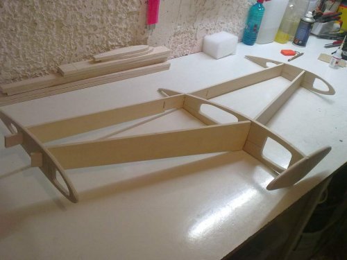

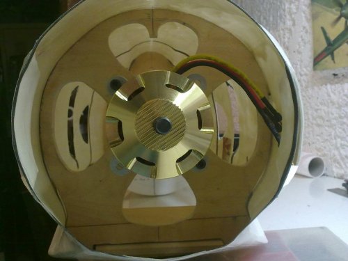

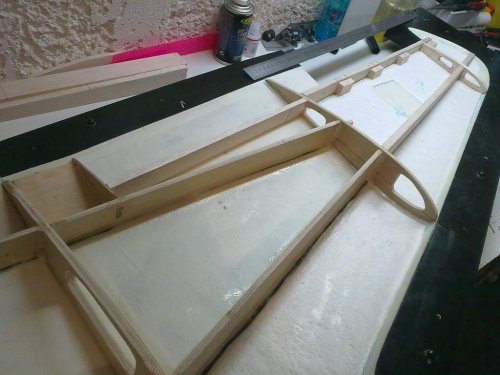

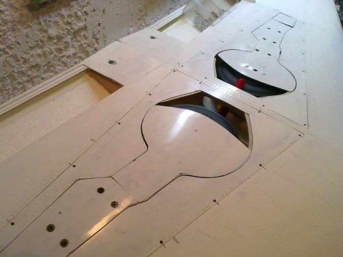

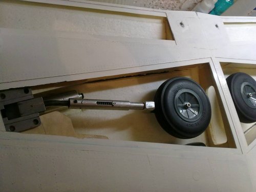

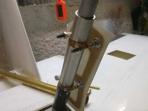

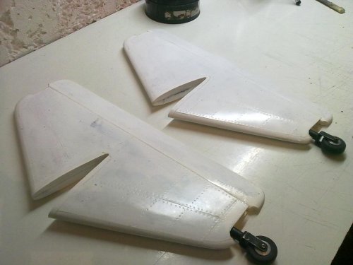

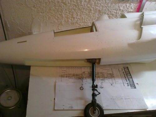

Some progress!

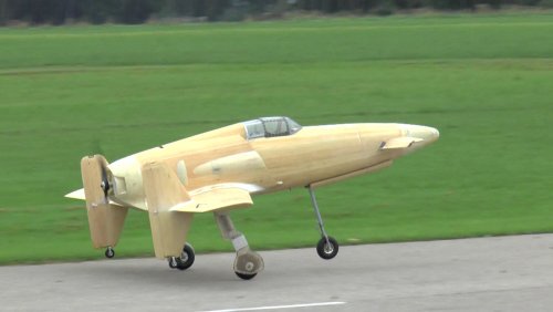

Here is the new video from josef and hartmut with 3 nd 4 flight of foam shinden!!!!!!
https://www.youtube.com/watch?v=takCR3JAyE0
Wow thanks. Amazing flight!! Looks like real aircraft flight demonstration. :eek:
We can see rapid nose down at front wing stall when mid air low speed high angle of attack flight.

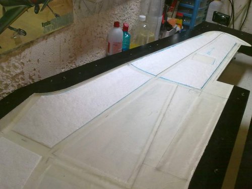

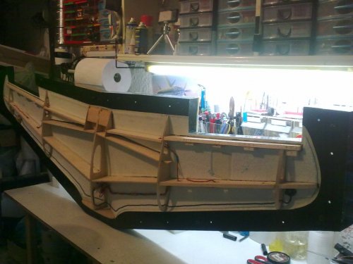

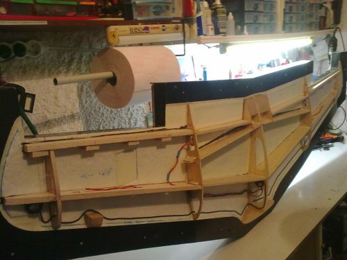

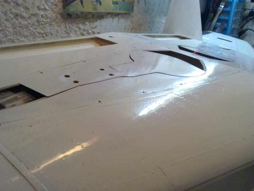

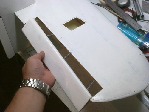

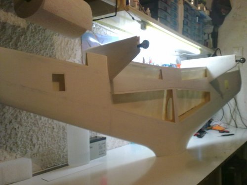

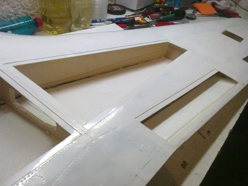

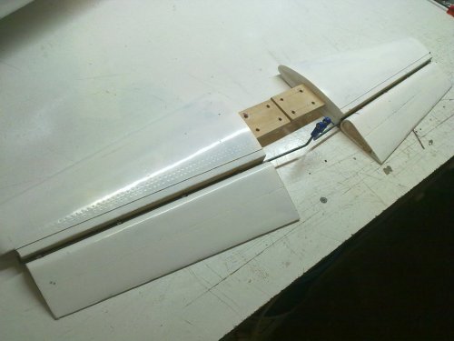

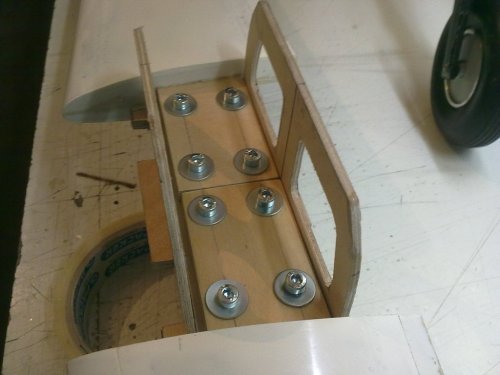

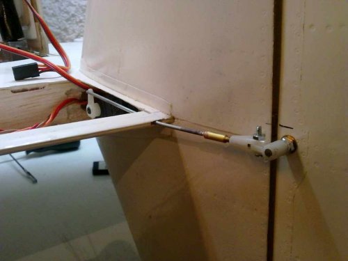

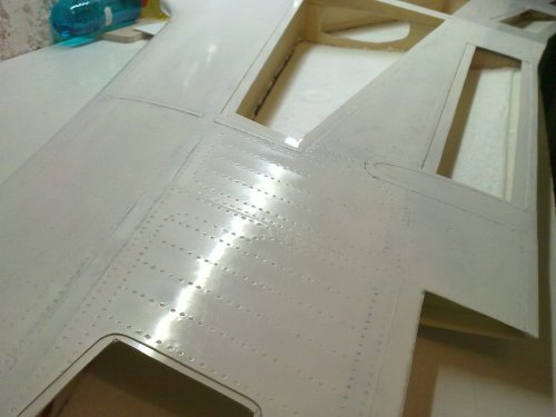

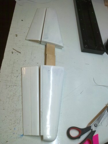

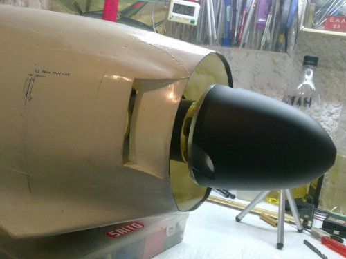

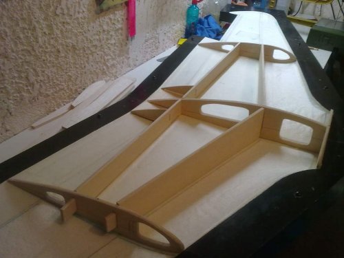

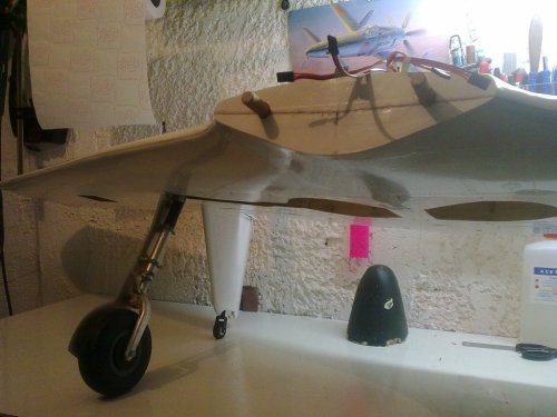

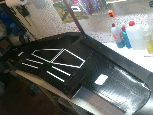

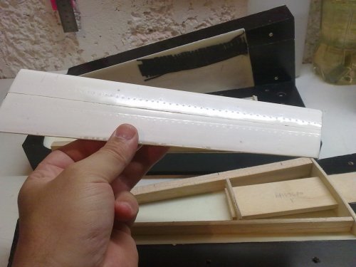

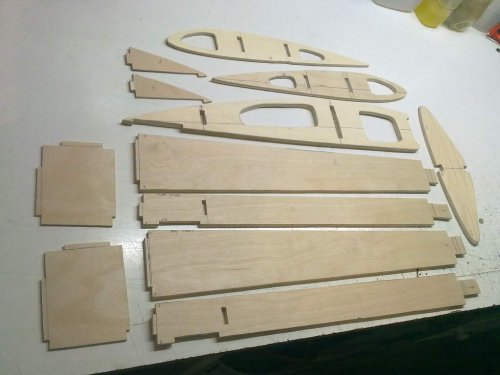

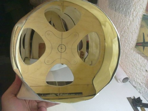

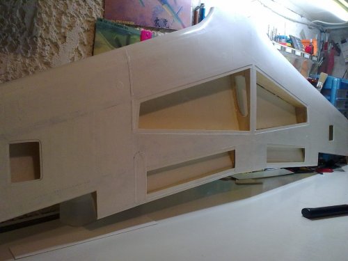

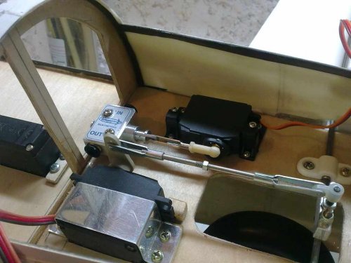

Some new progress! ;) ;)

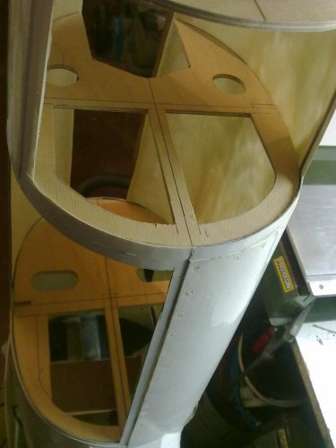

Systematic!! :)

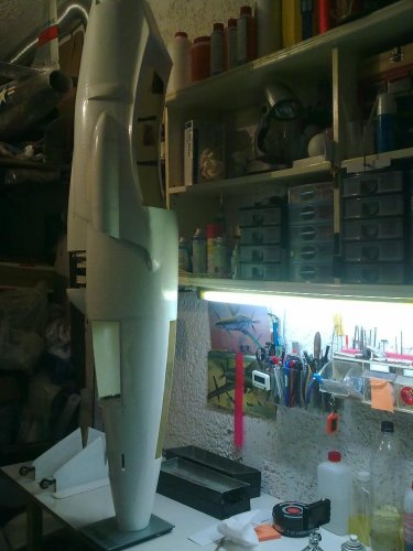

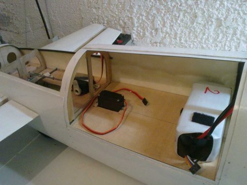

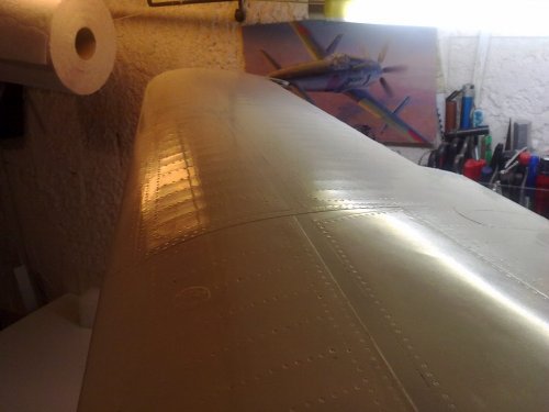

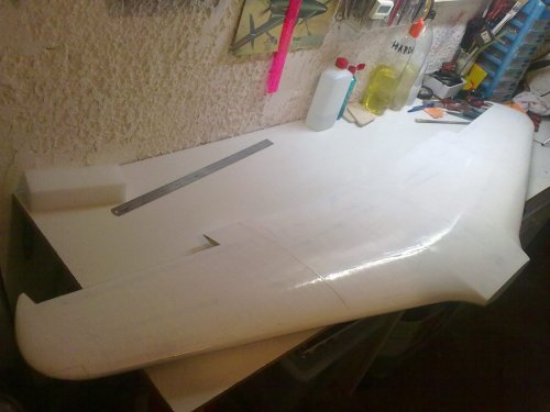

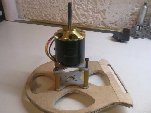

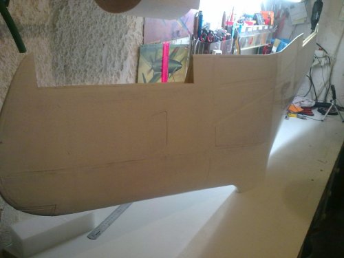

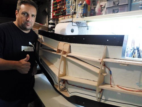

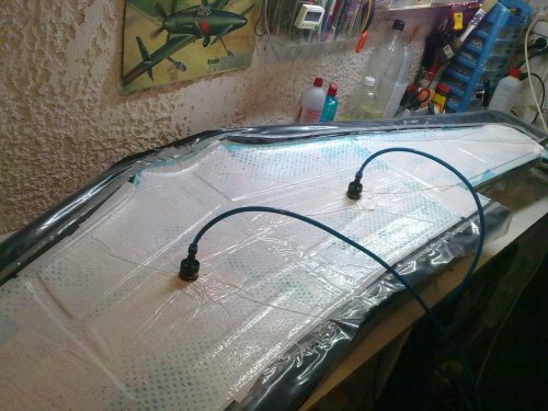

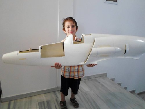

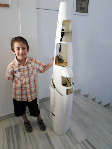

Some new progress!!!
Electric airplane!! It is wonderful accuracy. :eek:
I can't stop imaging jet powered model.

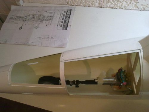

Hello !Sorry for delay.I'm near to start tests!
https://www.youtube.com/watch?v=bFNZ2kKYi2g
https://www.youtube.com/watch?v=LJm10lpaxgI
https://www.youtube.com/watch?v=VrZP2sxS-AA

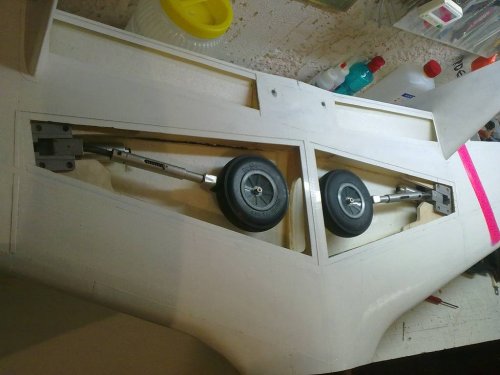

:-[Hello, here is Hartmut again with some news about Josefs Shinden, not really good ones. See the following URL:
https://www.youtube.com/watch?v=Yv_vAxDFQ3Y&list=UUrQO1hZqKQWVoYD_6NjtcBQ
After successful test flights with the styrodur Shinden (half size) Joseph modified his large Shinden with the same settings.
The test flight failed because the side thrust of the engine did not occur to the correct side, the model side sliped to the right). Furthermore, Josef did not correct the side slip by using the rudders.
In addition, Josef has added some elevator function with the ailerons to support the Canard. He is using an aileron system ‘Frise’ where their leading edges at upward deflection rises downwards from the wings underside, sticking out to support the rudder effect in turning flight. The admixing as elevators both lower edges of course slow the airflow under the wings, which lift is anyway already weakened by the landing gear openings and legs. The speed also was not increasing by that as Joseph gave a little more elevator because of the forest. Thus, the wrong side thrust was increasing more and more so that the side slide angle grow bigger andbigger, until then the strong side airstream turned the model. Thus, the speed was quite gone now and the Shinden crashed.
Joseph had at this time the feeling that the engine was not running at peak performance, he didn’t measure the revolutions of the engine again before the flight.
By a big chance the model crashed pretty much on the nose, this cushioned most of the impact. The fuselage nose was pretty smashed, the nose landing gear and right hand main landing gear were badly bent; the right hand vertical stabilizer was broken.
Meanwhile Josef has repaired his large Shinden, he is just waiting for the repaired landing gears.
Josef corrected the side thrust of the engine on his Styro-Shinden to zero and the engine down thrust to minus 2.5 degrees (Spinner upwards). The model now flies much better than ever before.
Regards, Hartmut
It was really good to restore the body.
A next flight will surely be successful.
Do your best, Joseph. :D
Better luck for the next time, such accidents are really a pity, but not always
avoidable, as the "real world of aviation" shows, too. :-\
I'm just wondering, if it wouldn't be recommendable for example just to fit a
kind of provisional landing gear, more primitive, not retractable but more sturdy
and maybe fitted with predetermined breaking points to safeguard the wing and
fuselage structure ? Saw something like that on a big scale helicopter model and
it looked somewhat strange, but as the owner told me, made test flying easier
and safer for the structural parts.

I made also some new test runs!I have to finish only the last cg balance.
https://www.youtube.com/watch?v=B44XzmJw7HQ
Hi AG! Very exciting movie. I feel that I myself became a pilot of Shinden completely.
:) :) :)Hello Argyris, on this place again, all the best for your first flight!!!! Regards, Hartmut and Josef
Dear Blackkite hello.I have some news , I made some new test runs!The shinden looks like he can fly!xaxa !I'm near to maiden flight.I hope you like it!
https://www.youtube.com/watch?v=KXPPph5oeDE
Looks like the nose wheel leg collapsed during the last hop ? All the best, that
this won't happen again and especially not during the hopefully succesful maiden flight !
