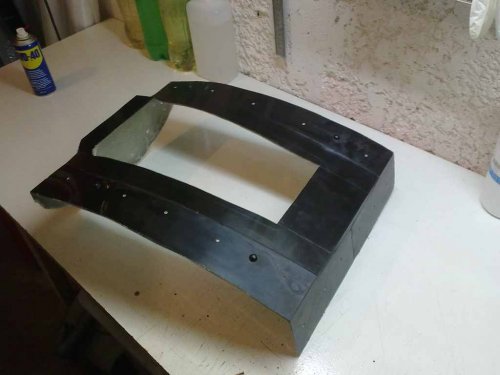

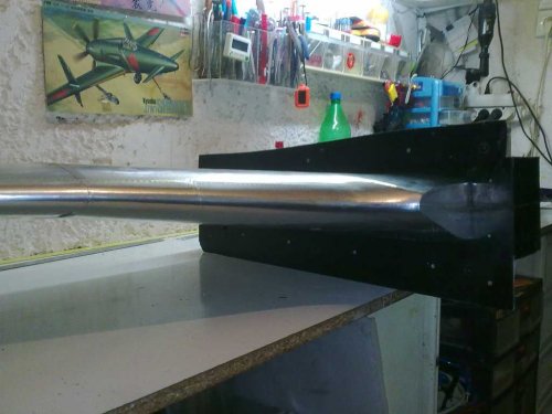

Some new progress.

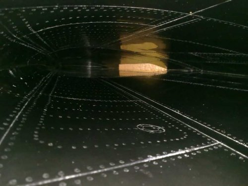

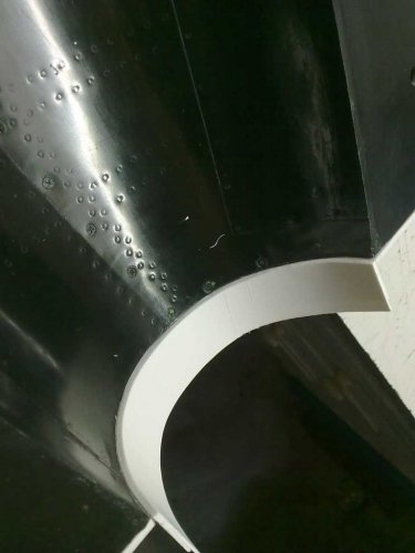

What a delicate, smooth and beautiful curve!!
Many thanks for sharing us a precious movie. What a hard procedure!
You are also excellent movie maker. :D
Thank you blackite!I 'm ready to molding the fuselage.

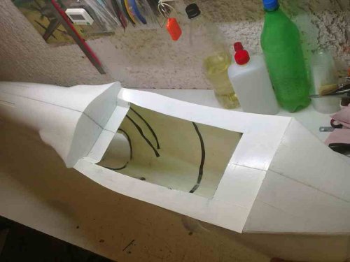

Hmmm....I can see engine cooling air intake and ejector type oil cooler air intake.

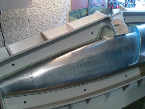

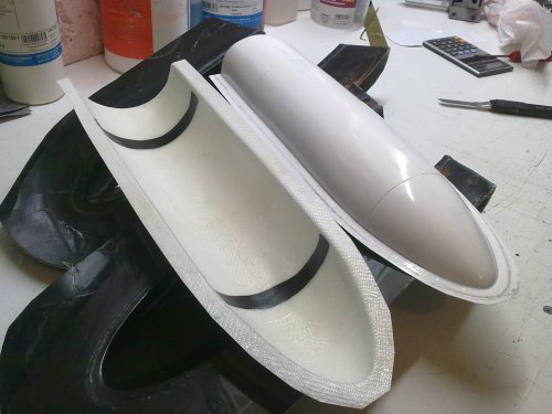

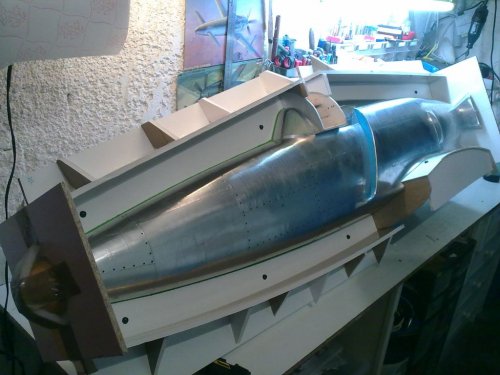

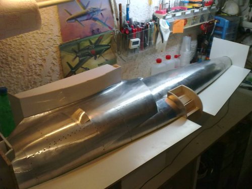

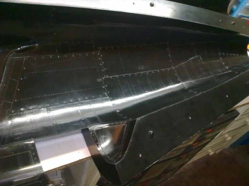

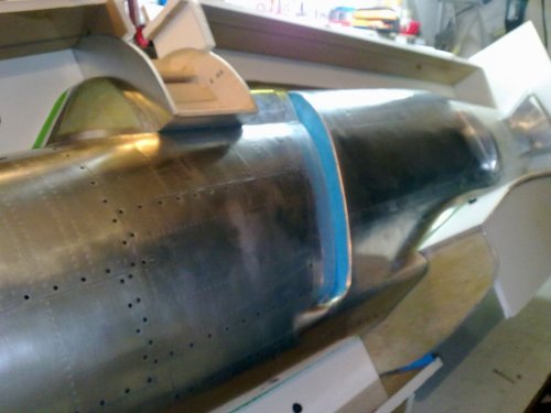

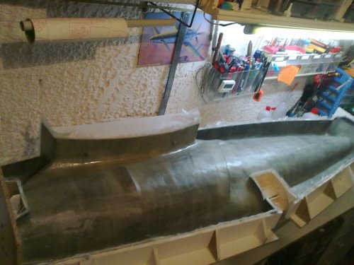

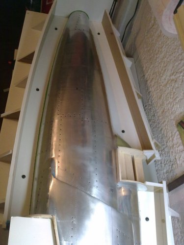

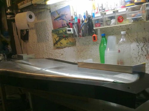

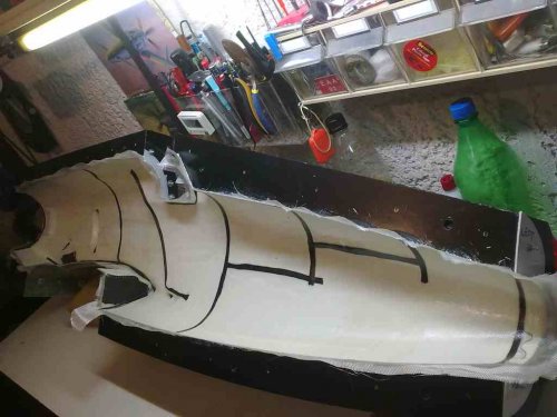

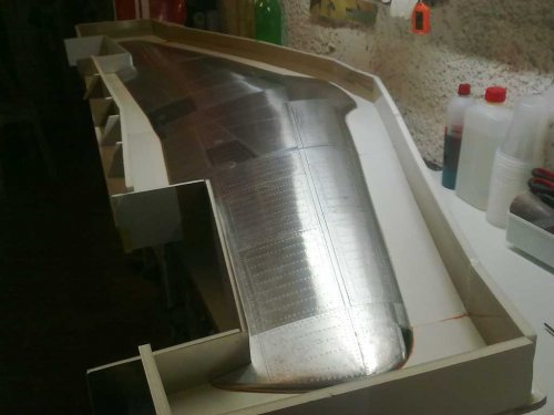

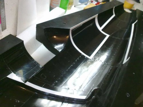

Sunday i mold the half one of fuselage!
Incredible totally. You are an engineer and also an artist. :eek:
The people from Greece are great, too.
Hi AG! I feel that the engine sound looks like piston engine not gas turbine engine. Is it right?
Your engine for P-80 is piston engine drive ducted fan engine?
Thank you very much Blackite!Yes one is with piston engine DF and the other two are with electric and jet engine.

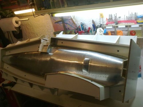

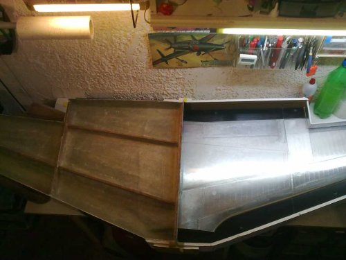

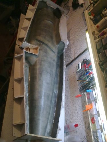

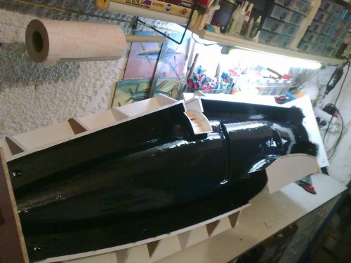

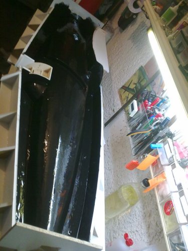

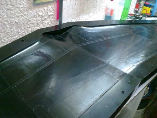

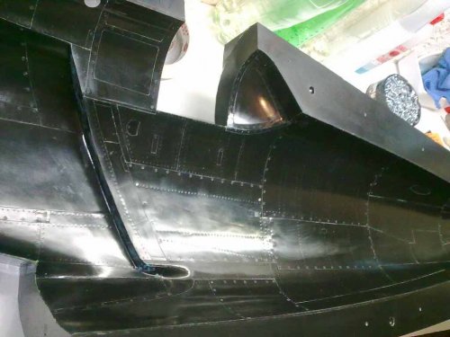

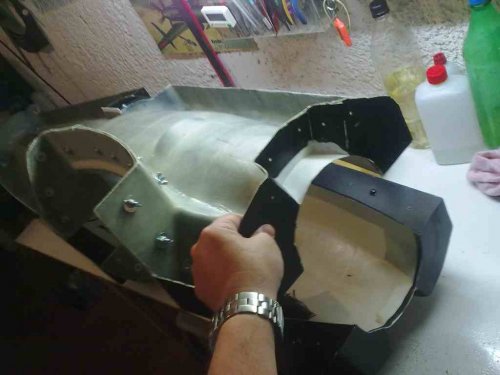

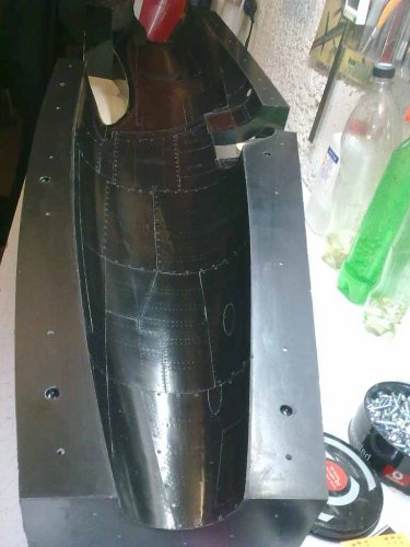

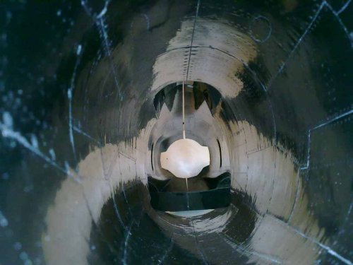

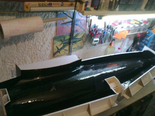

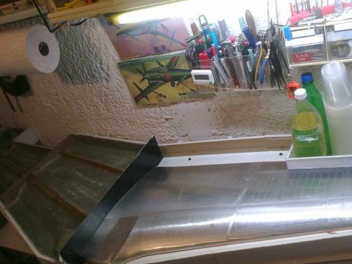

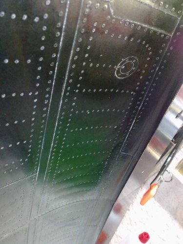

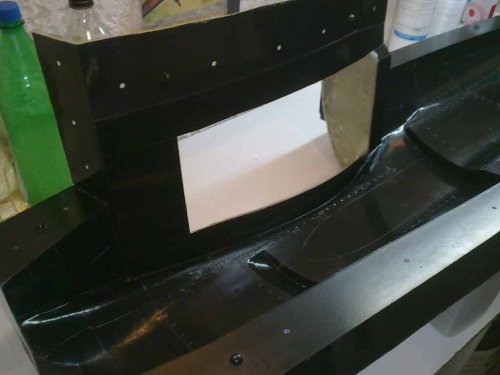

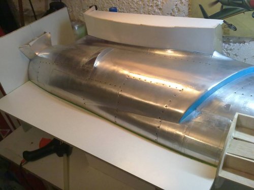

After 9 continuous hours of molding the one side of the mold is ready! ;) :p :p

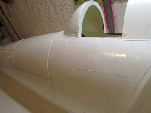

Excellent work!! Then you can make a one side of FRP fuselage and add airintake for supercharger.

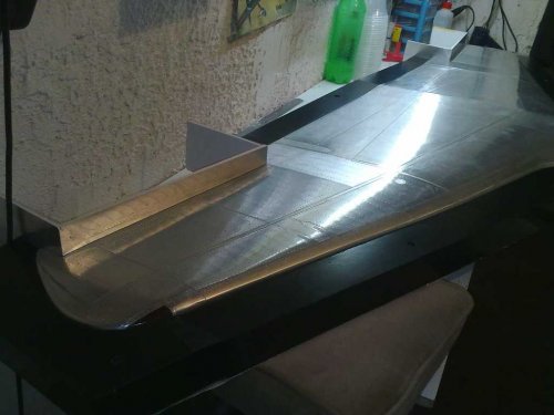

SOME NEW FOTOS AND VIDEO.

Thanks! Not only detailed, but also fly. Surprising model. :eek:

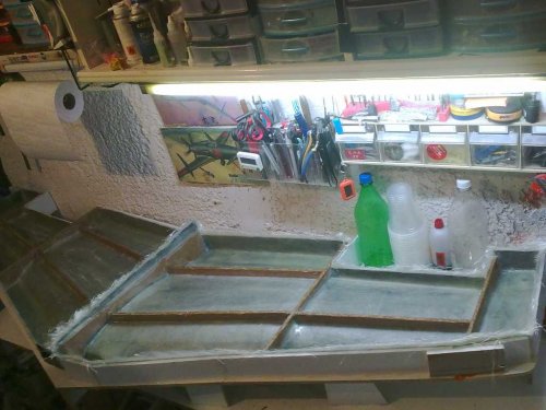

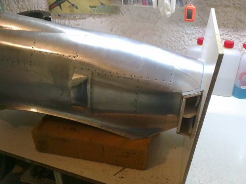

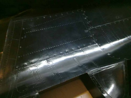

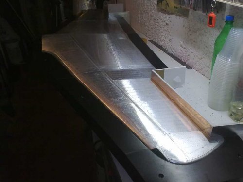

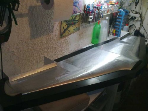

Some new progress
Oh wing!!
http://www.youtube.com/watch?v=eLn0jI-ZJQ8

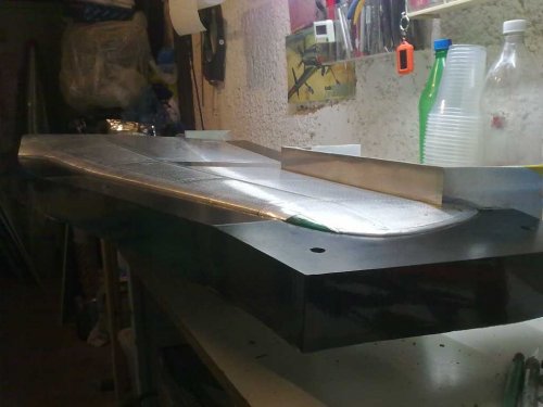

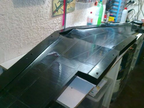

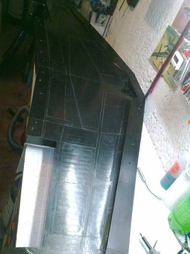

SOME NEW PHOTOS....

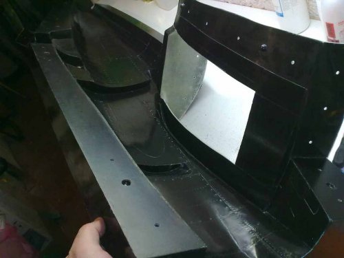

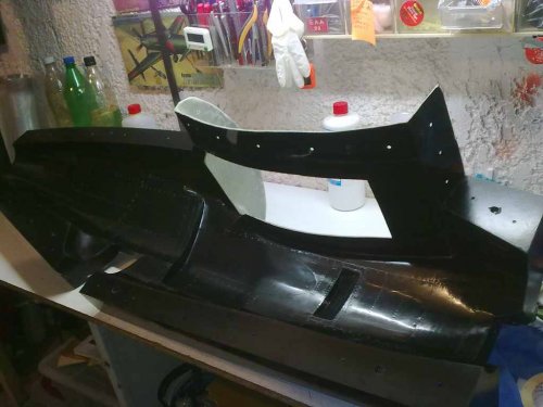

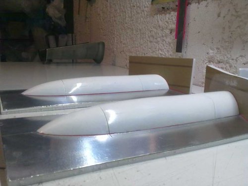

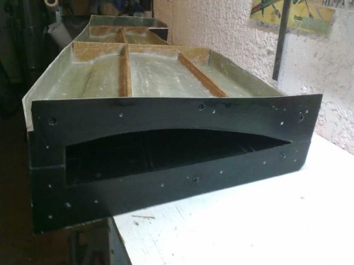

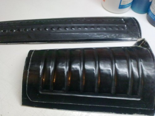

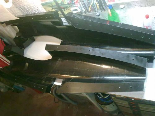

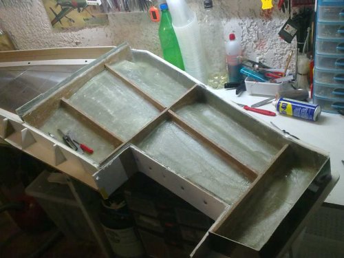

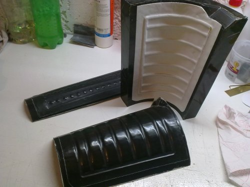

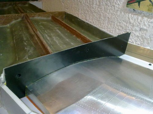

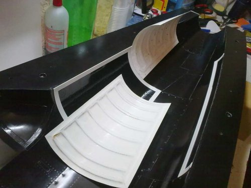

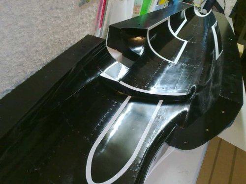

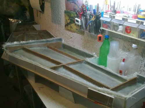

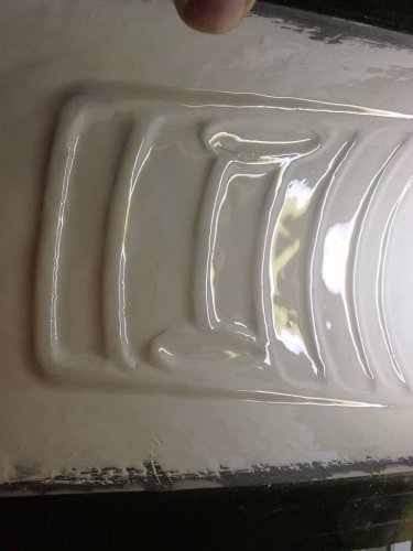

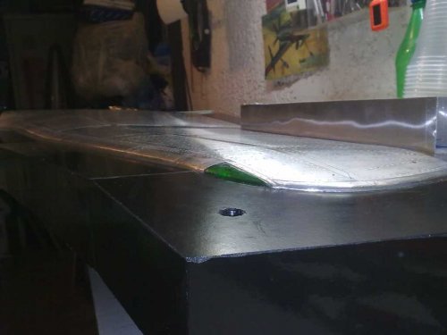

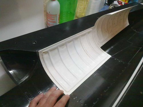

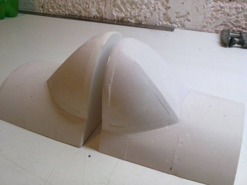

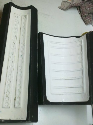

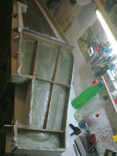

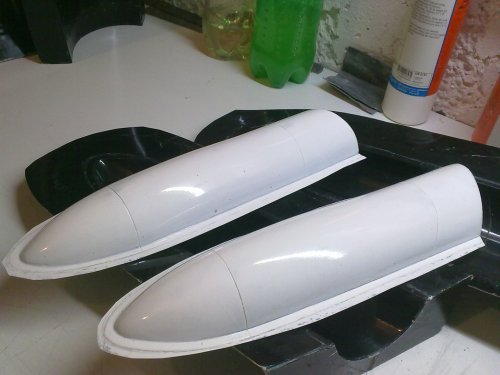

The molds are ready for parts!
Really great to folllow the progress of your work. Excellent craftmanship !
Are you planning a whole series of Shinden ? Should be no problem with the moulds you've made.

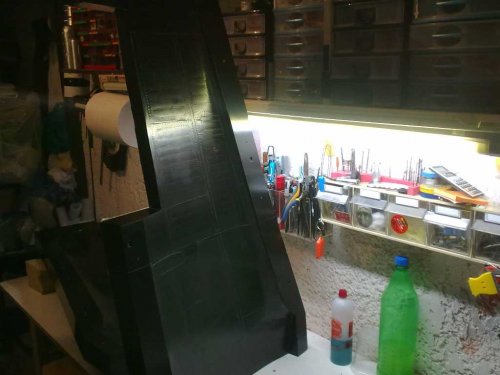

some news

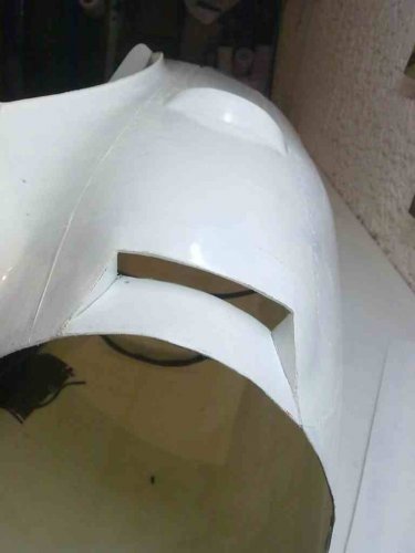

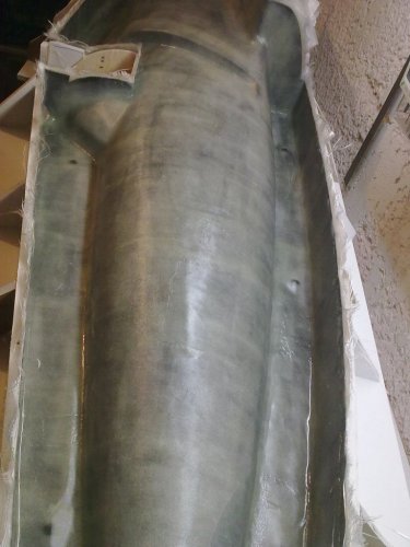

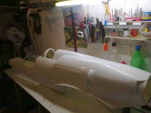

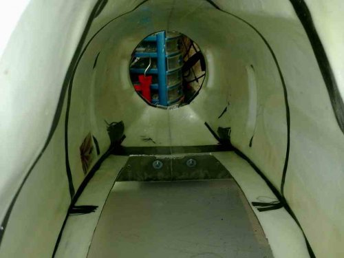

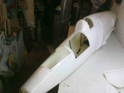

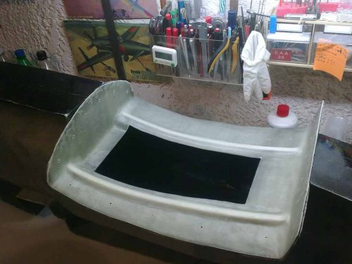

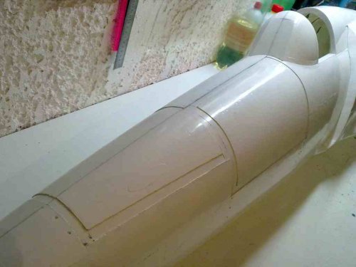

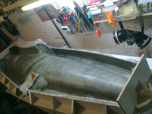

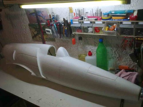

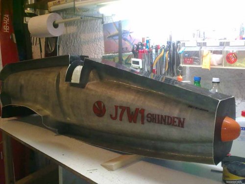

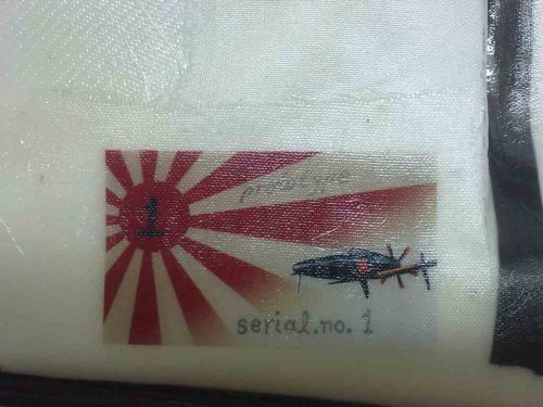

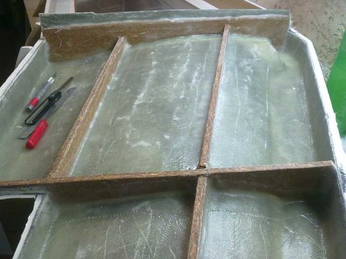

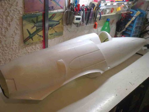

The first fuselage is ready!
And the video! ;)

Excellent!
