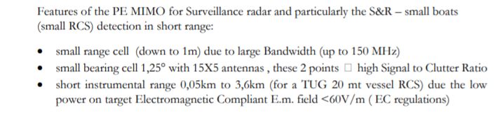

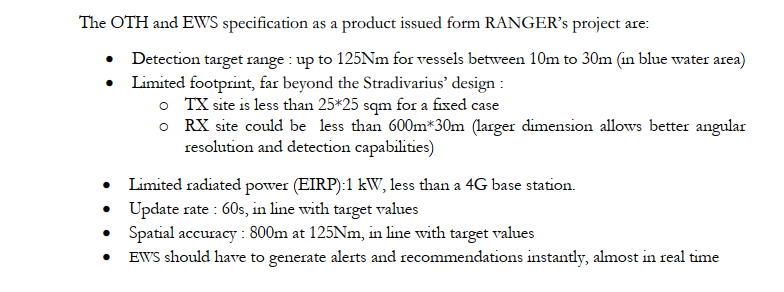

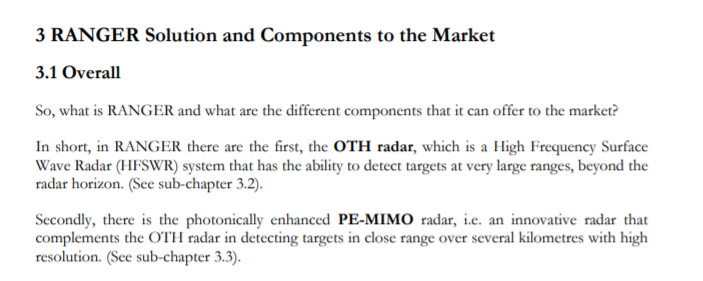

PE-MIMO has better spatial resolution but also has much shorter range.
Sarlio_Siintola_Tammilehto.pdf (theseus.fi)
Documents download module (europa.eu)

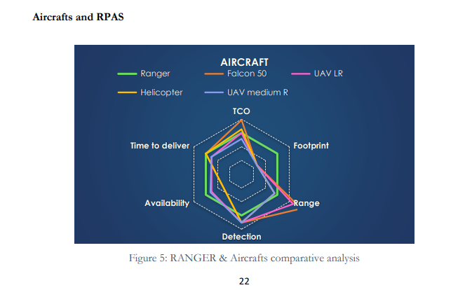

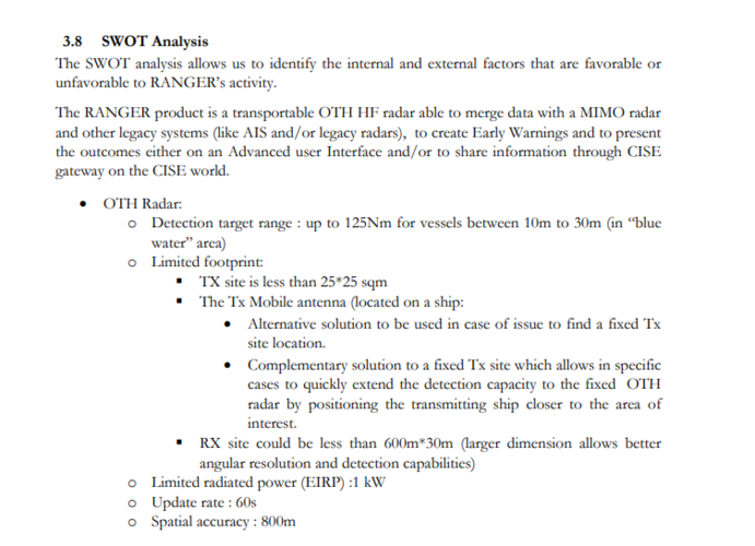

The spatial resolution isn't that bad, if not better than before. I am definitely going to lookout for this particular radar Радиолокационная станция "Яхрома" в Крыму будет работать в четырех диапазонах - Армия и ОПК - ТАСС (tass.ru)

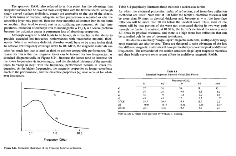

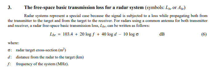

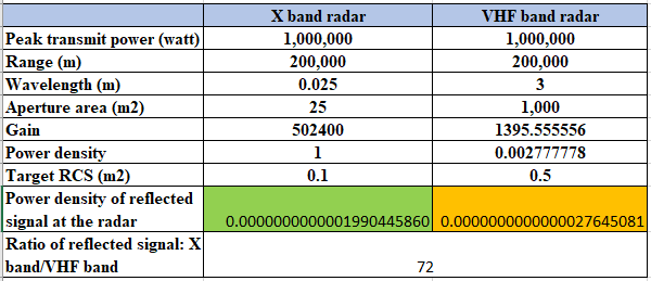

There is efficiency. At least because of poorly working in the long-wavelength range of radio-absorbing coatings on the aircraft. But they are not a panacea.

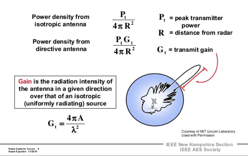

Firstly, there is no efficiency because the power density of VHF is much lower so a 5 fold increase in RCS is simply not enough for its to have detection range advantage over X band.

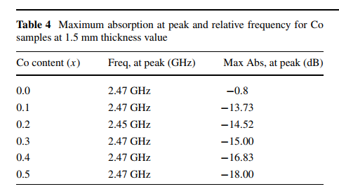

Secondly, magnetic RAM has decent absorbing capability in low frequency while still relative thin
And what should hinder this? Beliefs? Stealth has its effect, even in a fivefold decrease / increase in power. And reducing the distance by 1.5 times. I described to you above why it won't work! Radars are a compromise. It is impossible to increase all the characteristics without reducing others. This is life and the laws of nature
And your explanation is so obviously wrong

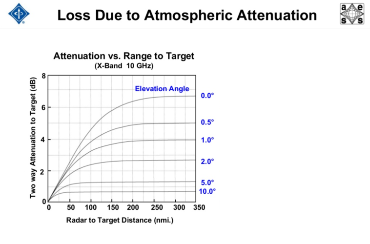

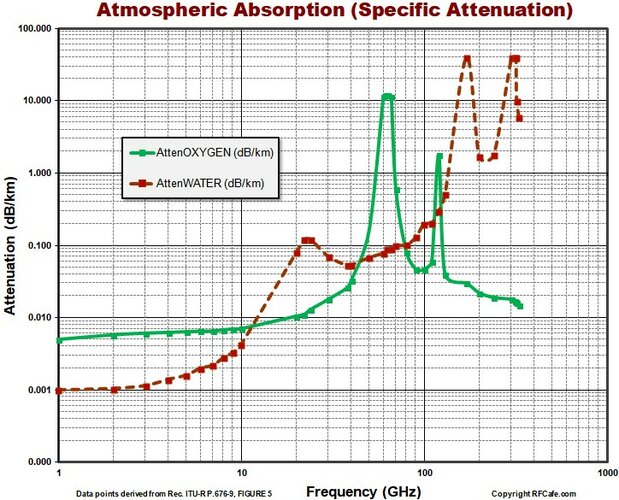

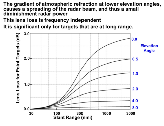

Firstly, what do you think the attenuation rate of X-band in the atmosphere is?. At 10Ghz, it is less than 0.01 dB/km, so for 400 km, it is only about 4 dB
Compare that to the different between the power density of X-band and VHF band radar of the same size. Gain is inversely proportional to wavelength, so by increase wavelength by 400 times, you will lose a lot more from the reduction in power density than you would gain from the tiny 5 fold increase in RCS and the 4 dB from reduction of atmosphere absorption. In other words, there would be no reason to use VHF radar against stealth aircraft if the RCS increase is only 5 times like you said. Normally, VHF radar have much worse accuracy, power density than X-band but it has advantage in the much higher RCS of target in that band. That the trade off. But if the value is just like you claimed, then VHF radar is worse in all ways
Data taken from tutorial. Not a journalistic article.

Oh no worries here, anything that beats a 40-50 km spatial resolution diameter is fine with me and gives me something to look forward to.
the spatial resolution is range dependent, for Ranger project, 800 meter resolution is for 125 nm for 600*30 meter receiving array

Funny that you talk about scan time, but the advertised quantity of VHF radar over X-band against stealth aircraft has always been much better detection range. But if what you claimed about the RCS was true then literally, VHF radar will be much worse than X-band radar against stealth aircraft
And, if you use X-band radar, you also don't even need a 12*12 meters radar, the only reason for the huge aperture of VHF is their terrible gain

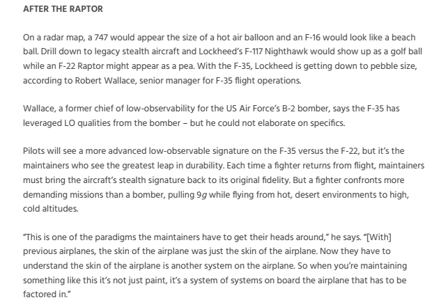

Believing that Russian can somehow magically know the exact future RCS of the F-22 before its shape even finished and 6 years before it flew the first flight clearly will require a lot of faith. Neverminded the huge contradictory with anechoic chamber measurement
Did you even followed the program at all?

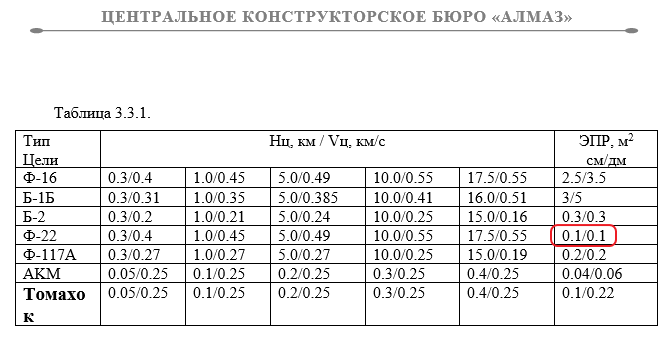

I am not interested in journalistic articles about "balls" and "peas". Please provide official figures from LM, Department of Defense or related organizations. That's exactly what you promised. :D
And frankly, if you use X-band radar, you also don't even need a 12*12 meters radar
You have set this condition. I just showed you how obscene your statements look from the side of scan time.
A large dimension is needed to make the beam reasonably narrow for scanning a space with a given resolution for a specified time. Naturally, the longer the wavelength, the larger the antenna size will be required. And naturally, this also affects the gain. Therefore, as the gain increases, the scan time will decrease.
You were provided with documents from different years (1991 - ATF to 2001 - F-22)
You were given a quote from Davidenko (on the first page) of the general designer of the UAC - 2010.
I can also quote Poghosyan (Head of the UAC) from an article on stealth technologies - 2003
In all of them the figure is 0.1 - 0.5 m2.
You, besides "balls", "peas" and articles of journalists, cannot cite anything.

Except you forget that VHF radar must be big because they must have enough gain for their radar beam to have at least some utility otherwise with small aperture then their beam is quite omidirectional but X-band radar doesn't need that, you can get quite focused beam even with relatively small aperture. But the thing is, if the X band RCS value of stealth aircraft is actually as high as you claimed, and the VHF RCS is only 5 times bigger than the X band value. There would be no use for anything like Nebo , JY-27 whatsoever, because they can easily build small X-band radar 1*1 m or 2*2 m that is not only have extremely long range against stealth aircraft, but also have very quick scan time.
Secondly, you seem to very conventionally forget the common stealth detection range advantage of VHF radar over X-band. I'm not asking you about scan rate, I'm asking you: " if RCS in VHF band is only 5 times better than in X-band, then what the point of VHF radar against stealth aircraft? How can VHF radar detect stealth aircraft from greater range?.
Indeed, these are questions of faith. So I shut up. :D

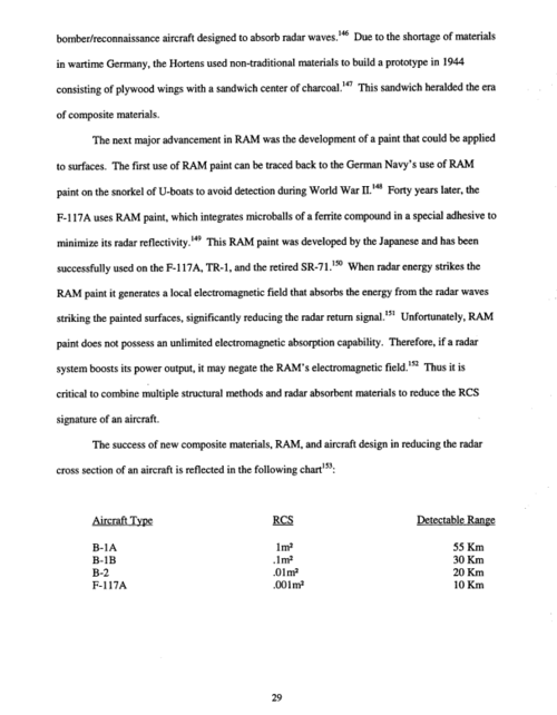

I love the double standard you are pulling here
When I gave you quote from Robert Wallace, you very quickly try to pass it off as journalistic articles, but you have no problem quote Davidenko and Poghosyan eventhough, their quote are also on articles of some sort ;)

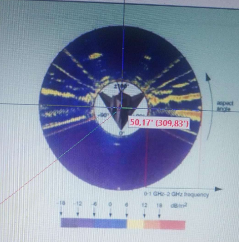

When I gave actual anechoic chamber measurement of F-117 metal model, you comment that it isn't accurate but yet you have no issue believe the Soviet guesstimate of F-22 RCS even though that guesstimate was done before F-22 finalize its shape and 6 years before it made the first flight.;)
In addition, you also lied. I didn't just gave you citation of article, I also gave data from varius radar scattering simulation and even one actual chamber measurement as well as one detection range graph given by Wu Jian Qi, the chief engineer of the CETC group

Когда я дал фактическое измерение в безэховой камере металлической модели F-117, вы отметили, что это неточно, но все же у вас нет проблем верить советской оценке F-22 RCS, хотя эта оценка была сделана до того, как F-22 завершил свою форму. и за 6 лет до своего первого полета.;)

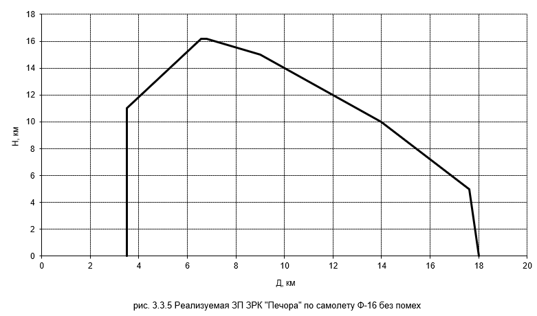

The science review "FUNDAMENTAL AND APPLIED PROBLEMS OF STEALTH TECHNOLOGIES" Pogosyan wrote in collaboration with the Director of the Institute of Theoretical and Applied Electrodynamics of the Joint Institute for High Temperatures of the Russian Academy of Sciences Andrey Lagarkov and presented at a meeting to the Presidium of the Russian Academy of Sciences is hardly may be called a journalistic article.
Based on these data, an assessment and further ways of modernizing the S-125 Pechera were carried out.
Some more.
Data for assessment, heading parameter 0 (target flies to the radar).
Why are there two band in the table?
СНР-125 operates in the centimeter band (8.9-9.46 GHz).
Also, for early detection, the P-15 of the decimeter band (810-950 MHz) is attached.
So, the RCS data (0.1m2 for F-22) in the table can be viewed for these bands and from the front side of the aircraft.

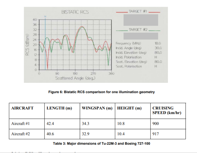

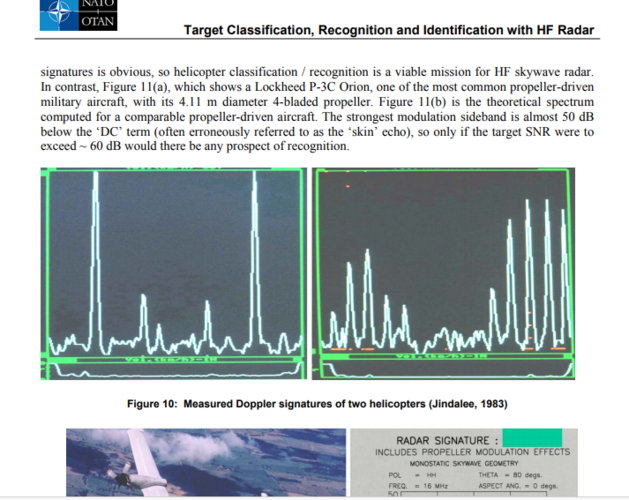

@Ronny

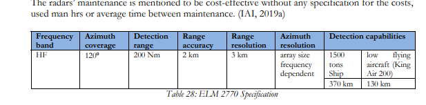

At most they can classify aircrafts and helicopters Countries integrating Over-The-Horizon (OTH) radars into air defence networks to detect and track stealth Aircrafts, Aircraft carriers and hypersonic missiles | International Defense Security & Technology Inc. (idstch.com)
I cant copy and past so had to image upload.
Their current target spatial resolution at most was 7.5km JORN: a world leading OTHR capability - Australian Defence Magazine

Роберт Уоллес привел какие-то цифры ? RCS измеряется в м2, дБсм и т. Д. Я дал вам цифры , вы - шары, горошины и камешки. Абстракции, которые можно трактовать как угодно, мне не интересны.

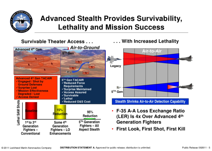

Firstly, there isn't many way to interpret the golf ball, marble. The reason they often used that analogy is because a ball have same RCS from all direction, and therefore easy to grasp
Secondly, Lockheed Martin give the exact amount of detection range reduction due to stealth many times, so it is quite clear and easy to work out the RCS

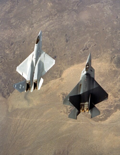

You know there was the YF-23 competing with the YF-22 for the ATF program right?. And the YF-22 also changed a lot when it become F-22.
So not only that data is purely speculation, it also made at the time the actual F-22 didn't even take shape yet.

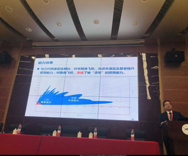

Catchy however, the slide shown by Wu Jian Qi, the chief engineer of China Electronics Technology Group Corporation is not a journalistic article, the F-16 radar scattering simulation from department of aeronautical science of Hellenic Airforce academy isn't a journalistic article, the actual F-117 metal model measurement in Bremen anechoic chamber isn't a journalistic article. The slide about radar detection range reduction from Lockheed Martin also not a journalist article.

"Northrop constructed the B-2 with materials such as carbon-fiber composite plastics and covered the aircraft with an anti-thermal coating to absorb acoustic, infrared, visual and radar signatures, which greatly reduced the possibility of being identified by various types of detection systems. According to the Air Force in 1990, the RCS of the B-2 is the size of an insect"
We got supposed sources "from experts" saying .01 and .0001m2 all over the place for the B-2. If this is suppose to be a serious thread on stealth RCS than carry on you guys. ;)

Let's take a look at longwave radars. Imagine a radar with a circular antenna.
Beam width = 6 degrees
Wavelength = 1.1m
These are our constants.
Find the diameter = (65 * 1.1) / 6 = ~ 12m
Area = ~ 111.5 m2
Gain = (4 * PI * 111.5) / (1.1 ^ 2) = 1158.3 or 30.6 dB
Frequency = 272.5 MHz
The task is to find the level of the returned signal in front of the antenna.
Options.
Power 20 kW (73 dBm), Range 100 km, RCS of the target 5 m2
x = ((30.6 * 2) + 73 - (103.4 + 20 * LOG10 (272.5) + 40 * LOG10 (100) -10 * LOG10 (5))) = -90.8 dBm
Remember this figure.
We do the same only for the X-band radar.
The beam width is the same. We don’t want to change the space scan time.
Wavelength 0.03 m.
diameter = 0.325 m
Area = ~ 0.082 m2
Frequency = 9993 MHz = 10 GHz
x = -122.1 dBm
As you can see, the gain and width are completely interconnected.
But that's not the point. The signal level at the same levels dropped by 31 dB. This is atmospheric attenuation. 1,260 times.
How can we fill this gap?
We cannot change the gain. This will require a change in area and hence diameter. Which will change the beam width. But we don't need it.
Therefore, we need to increase the power. And it should be increased by 1,260 times.
I hope you understand that longwave radars are a trade in power for size.
This is the main benefit of longwave radars.

Insects, balls and peas
Journalist Articles
Articles of Chinese non-military organizations
Retired employees
Screenshots from LM, but no numbers.

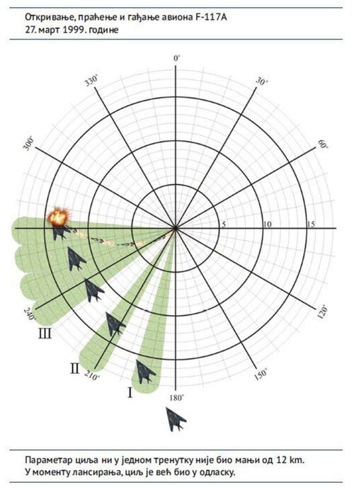

From an interview with Dale Zelko (F-117 pilot)
The clouds were very low. I saw the rocket when it had already crossed the cloud layer, immediately after launch. She walked at an angle of 50 degrees to me. And as soon as I saw her, I realized: they had figured me out.
Let's take your picture. There are no peaks at the CHP-125 (8.9-9.46 GHz).
I don't think they will appear with an even greater decrease in wavelength.
Everything is ilac in your picture. -18dBsm or 0.0158 m2
A volley was fired at a distance of 13 km, defeat 10-11 km (from the report of Djordje Anichich).
Here is the F-16 affected area by the same SAM (Flight to the radar).
The range = 18 km.
RCS F-16 in the centimeter band of 2.5 m2. I think you will not argue with this.
Further, we count through the fourth root.
(0.0158 / 2.5) ^ 1/4 = 0.281
0.281 * 18 = 5 km
As you can see, if you believe your picture and the low RCS, then the Yugoslav anti-aircraft gunners had to launch missiles from a distance of 5 km. Before this distance, the missile guidance station (CHR-125) should not have seen it. But we know that the salvo came from a distance of 13 km.
Those models, do they have internals? Gaps? Fasteners and rivets? They can give any RCS as ridiculously low as you want, it will all be BS when real world issues kick in.
Wavelength = 1.1m
Area = ~ 111.5 m2
Options.
Wavelength 0.03 m.
diameter = 0.325 m
Area = ~ 0.082 m2
x = -122.1 dBm
I didn't tell you to keep the same beam width between the two radar, of course the X-band radar will have narrow beam, but you don't need to go overboard with it.
In your example: the antenna aperture area of the VHF radar is 1359 times bigger than the X-band radar ;) ,Is Nebo SVU that much bigger than an SPY-6? ;)
Try with a more realistic example:
X band radar:
Dimension: 5*5 meter -> Area: 25 m2
Operating frequency: 12 GHz - Wavelength: 0.025 m
Peak transmitting power: 1 MW
VHF band radar:
Dimension: 31*31 meter -> Area: 1000 m2
Operating frequency: 100 MHz - Wavelength: 3 m
Target RCS at X band: 0.1 m2 , Target RCS at VHF: 0.5 m2
We have the equation for power density so just put all in the excel:
In short, if what you said about RCS was correct, the X-band radar with 40 times smaller antenna will still have 72 times better power density of reflected signal compared to the VHF radar. VHF wouldn't be anti stealth, in fact, it will have inferior detection range against stealth aircraft compared to X-band.

I don't know who taught you that about atmospheric attenuation but you should have your money back
Atmospheric attenuation of 10 Ghz band when it travel 350 nm two way (or a total of 700 nm = 1296 km) is only 6.5 dB and that assuming the elevation is 0 where there is lens loss effect, with even a slight elevation angle of barely 5 degrees, the atmospheric attenuation is less than 2 dB
Because you said: "Lockheed Martin not only have access to all three aircraft but also developing them"
So I'm waiting for the figures from the LM or at least from the Ministry of Defense.
But figures are not.
Instead of this,
Journalist Articles
Retired employees
ETC
1- The insect, ball, pea comments was given by Robert Wallace, the senior flight operation for F-35 and former chief of low observability for the B-2
2- The journalist articles are quoting people of authority in the matter rather than doing their own analysis
3- CETC group isn't a non-military organization, they are a state owned corporation that manufactured many military equipment. As a matter of fact, YLC-8B radar, JY-27A radar and Silk Road Eye radar on KL-2000 were all made by them
4- 95% reduction in lethal SAM shot, and don't tell me that is the amount of RCS reduced, because right next to it, they also have the graph showing 5 fold decrease in air to air detection range. You simply can't achieve that with a only 10 times reduction in RCS
The clouds were very low. I saw the rocket when it had already crossed the cloud layer, immediately after launch. She walked at an angle of 50 degrees to me. And as soon as I saw her, I realized: they had figured me out .g
Not realistic !!!!!
You are constantly forgetting about the beam width.
Under your conditions for the x-band, the beam width is 0.3 degrees. It takes 34,000 steps to scan a 60 * 60 sector. Modern radars scan this sector in about 10 s with a range of 150 km on average. The full view for the APG-81 is 19 seconds at a distance of 160 km. This is approximately 0.02 seconds per step. 34,000 * 0.02 = 654 s or 10 minutes.
Yes, but I would not like to be the operator of such a radar station, in a combat situation, which scans the 60 * 60 sector in 10 minutes.
:D :D
These are the recommendations of the ITU. The International Telecommunication Union (ITU) is the United Nations specialized agency for information and communication technologies – ICTs.
ITU-R P.525-2
I hope you won't argue with ITU.

This is a monograph by an Air Force major who refers to some other writer. I never found the original source. But the author writes everything about everything.
Also, are you not confused by the B-2 figure? In all sources that give a low RCS level - This figure is much less.
The RCS of a stealth aircraft is typically multiple orders of magnitude lower than a conventional plane and is often comparable to that of a small bird or large insect. "From the front, the F/A-22's signature is -40dBm2 (the size of a marble) while the F-35's is -30 dBm2 (the size of a golf ball). The F-35 is said to have a small area of vulnerability from the rear because engineers reduced cost by not designing a radar blocker for the engine exhaust." [Aviation Week & Space Technology; 11/14/2005, page 27] The F-35 stealthiness is a bit better than the B-2 bomber, which, in turn, was twice as good as that on the even older F-117. B-2 stealth bomber has a very small cross section. The RCS of a B-26 bomber exceeds 35 dBm2 (3100m2 ) from certain angles. In contrast, the RCS of the B-2 stealth bomber is widely reported to be about -40dBm2 .
I have the video of the interview, he didn't mentioned anything about the angle of the missile, only that it penetrated the cloud, and let be real, F-117 didn't have a radar, a missile warning system, or a radar warning receiver. So at best, he was estimate the angle of the SAM with his naked eye, and on a high stake situation like that I don't expect anyone to have a highly accurate naked eye estimation of anything. He likely can't even distinguish between 30-50 degree at that moment
Here is an interview with Zelko in 2009.
Given to Aye Kuge.
Зелко Дейл: Была очень низкая облачность. Ракету я увидел, когда она уже пересекла слой облаков, сразу после запуска. Она шла под углом в 50 градусов ко мне.
Translate:
Zelko Dale: It was very cloudy. I saw the rocket when it had already crossed the cloud layer, immediately after launch. She walked at an angle of 50 degrees to me.
Yes, I admit that he could be wrong, but by + -10 degrees.
Otherwise, he would simply say that the rocket came from the right.
But there are no peaks in the 40-60 sector either.
