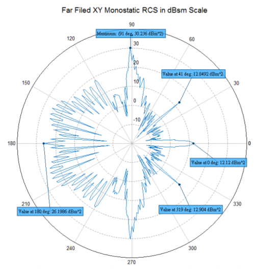

Well, I assume such simulation is going to be reasonable to assess the basic geometry of a plane, but to analyse real world complexity, or when people are discussing abut RCS of 0.0001 sqm for a house-sized plane, this kind of simplified approach is not accurate enough.
The "basic geometry of a plane" is what determines almost all of the RCS. You can reflect far more energy than you could possibly absorb. That was the real innovation of the XST studies.
There are many free and commercial software packages (and services) for RCS prediction. POFACETS is just one, though one that is very easy to access. It is used by many universities and defense contractors performing "military grade research". There are certainly others that can do things that POFACETS does not do.
It is certainly more "accurate" than pasting "RCS" numbers found on the internet to compare two aircraft!
But to get back on topic, someone has already done public RCS prediction of the T-50 for you:

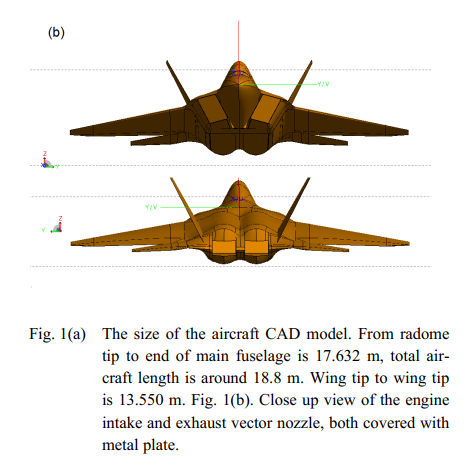

(PDF) Constructing a 3D model of a complex object from 2D images, for the purpose of estimating its Radar Cross Section (RCS) (researchgate.net)
I think it depends on who does the public RCS prediction, such as you brought up POFACETS while others that have used such a software gave mean frontal RCS of F-35 model as -11dBsm and that there were a couple of higher RCS peaks in the aircrafts frontal arc. I have heard people tell me in the past that Aus Power has like some bias with the F-35, but not with the F-22(is that correct?) there might be a chance LMFS might dismiss it for reference purposes if he comes back online anyways because I assume he does not trust how aus airpower is more favorable of one US aircraft over the other, than he will have doubts Russian aircrafts based on aus air power's RCS analysis would be any better.

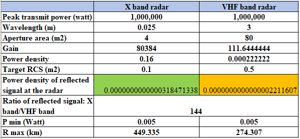

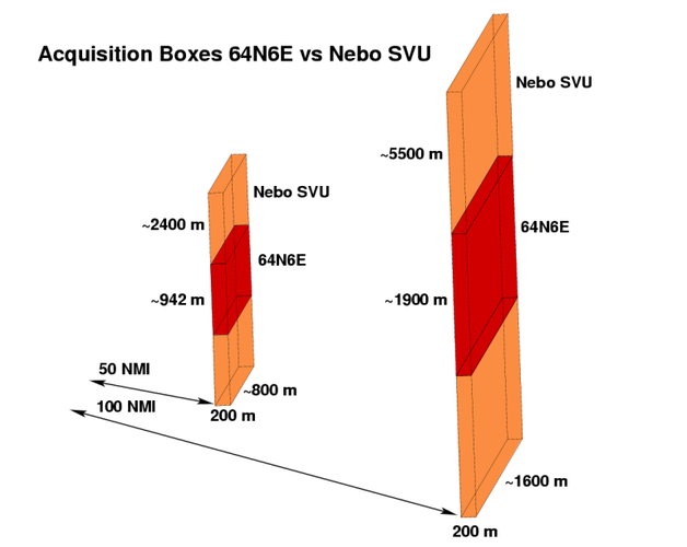

X band radar:
Dimension: 2*2 meter -> Area: 4 m2
VHF band radar:
Dimension: 20*4 meter -> Area: 80 m2
This time I added Rmax row for illustration ;) so tell me, how can they get superior range from VHF radar?
:D :D

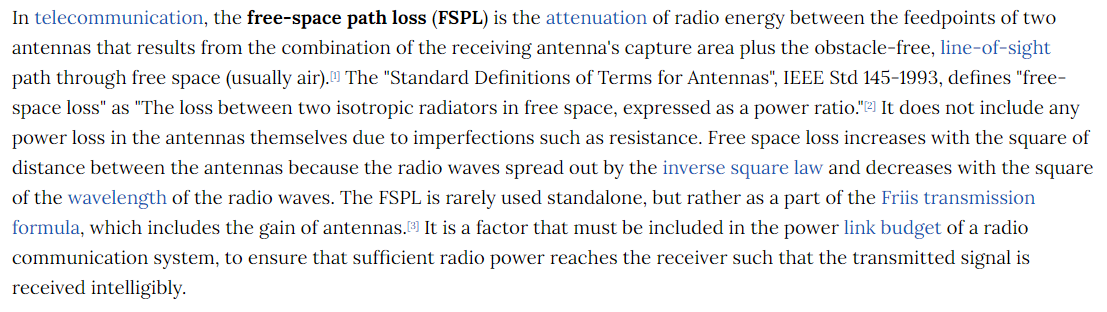

These are the recommendations of the ITU. The International Telecommunication Union (ITU) is the United Nations specialized agency for information and communication technologies – ICTs.
ITU-R P.525-2
I hope you won't argue with ITU.
Firstly, the chart I gave you came from IEEE
Secondly, I don't have to argue with ITU, you should open a book and learn the different between free space basic transmission loss and atmospheric attenuation.

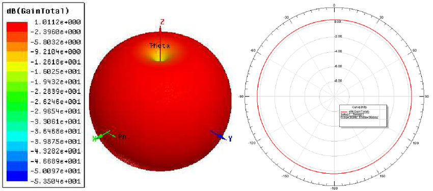

Free space basic transmission loss has nothing to do with atmospheric attenuation, the free space path loss come from the spread out of signal, also known as the inverse square law
Thirdly, your equation is for isotropic antenna. Meaning it radiate in all direction

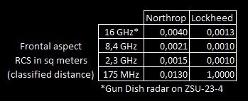

The comparison by Robert Wallace, the senior flight operation for F-35 and former chief of low observability for the B-2 is official, the chart given by Wu Jian Qi, the chief engineer of LC-8B, JY-27A manufacturer is official, the chart given by Lockheed Martin is also official .
This is a monograph by an Air Force major who refers to some other writer. I never found the original source. But the author writes everything about everything.
Also, are you not confused by the B-2 figure? In all sources that give a low RCS level - This figure is much less.
The RCS of a stealth aircraft is typically multiple orders of magnitude lower than a conventional plane and is often comparable to that of a small bird or large insect. "From the front, the F/A-22's signature is -40dBm2 (the size of a marble) while the F-35's is -30 dBm2 (the size of a golf ball). The F-35 is said to have a small area of vulnerability from the rear because engineers reduced cost by not designing a radar blocker for the engine exhaust." [Aviation Week & Space Technology; 11/14/2005, page 27] The F-35 stealthiness is a bit better than the B-2 bomber, which, in turn, was twice as good as that on the even older F-117. B-2 stealth bomber has a very small cross section. The RCS of a B-26 bomber exceeds 35 dBm2 (3100m2 ) from certain angles. In contrast, the RCS of the B-2 stealth bomber is widely reported to be about -40dBm2 .
I thought you only believe official source?. For me it is more believable that at some frequency B-2 has bigger RCS than F-117 than to believe Eurofighter and F-16 pretty much have the same RCS as F-22 and F-35

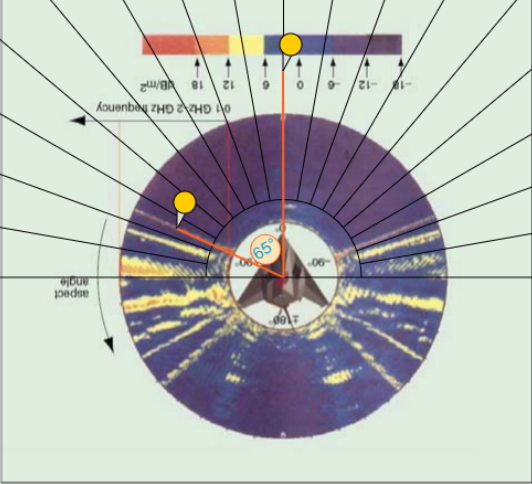

Here is an interview with Zelko in 2009.
Given to Aye Kuge.
Yes, I admit that he could be wrong, but by + -10 degrees.
Otherwise, he would simply say that the rocket came from the right.
But there are no peaks in the 40-60 sector either.
There is quite a big peak at around 65 degrees. Nevertheless, it quite an impossible task to ask someone to make an accurate angle estimation with his eye when is literally being attacked by a missile the size of a telephone pole coming at him through the cloud cover. So +- 15 or even 20 degree inaccurate is understandable

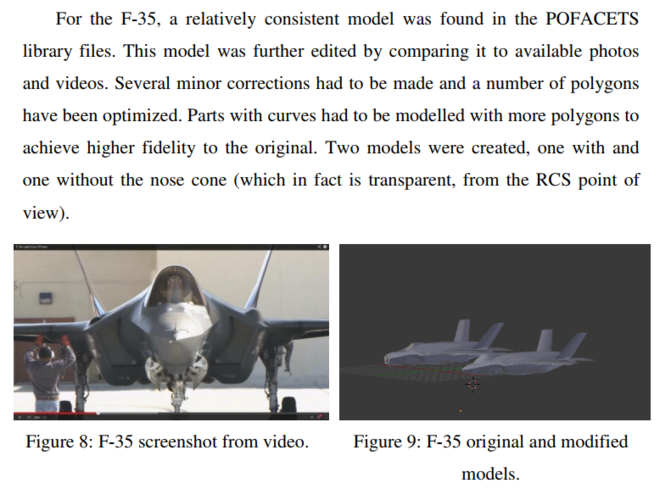

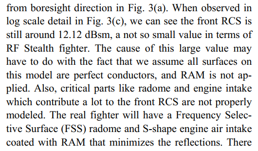

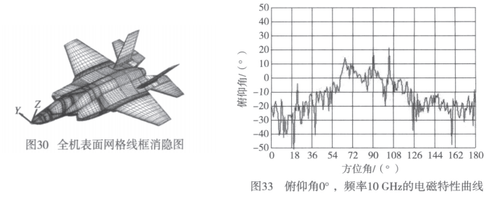

Small note: in that study, the F-35 model used for RCS simulation is the one without radome nose cone and canopy (they are assumed to be transparent to radar wave).
studies where radome nose cone and canopy is model look like this

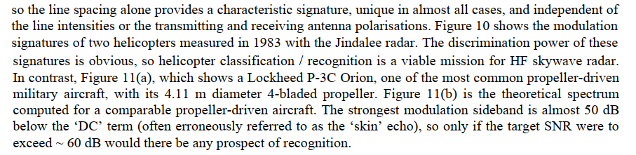

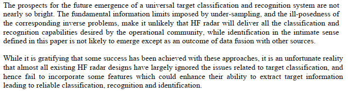

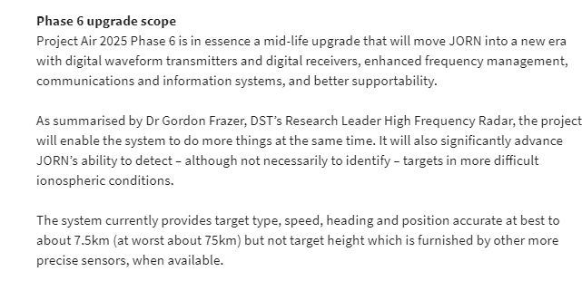

They can distinguish helicopter, but not aircraft. Secondly, distinguish 2 helicopter at 2 locations is quite different from distinguish them while they are both inside the cell
and their conclusion
I cant copy and past so had to image upload.
Their current target spatial resolution at most was 7.5km JORN: a world leading OTHR capability - Australian Defence Magazine
The resolution is range dependent, at best is 7.5 km, but at worst is 75 km. Also no height
You don't need to get the VHF range! You need to bring your x-band radar to its normal scan time.

You can take this formula and substitute the same values, and get the same thing.
I'll get back to the conversation when there are figures from LM or the Ministry of Defense.
There are NO figures yet.
I never found the source from the link in the article. Therefore, I cannot judge how official it is.
First, you got the sides mixed up.
Second, don't think that the US Air Force pilots are topographic critins. The cockpit is full of landmarks to determine the angle.
Thirdly, if you imagine the flight of the F-117 relative to the radar, you will understand that 50 degrees is the maximum at the end of the trajectory. The detection took place at a lower angle.

That's interesting. I have not read that paper, but back in 2010(?) a forum member did basically that for the J-20 around the time of its first flight. Generated a model from photographs and predicted the RCS as part of a discussion thread here on the forum.
So the assumption is that the RCS prediction was somehow tampered with?
Anyone can attempt to reproduce those results by using the same tools to predict the RCS. Again, I encourage those participating in this thread to do so. They will learn quite a bit in the process.
Look above the RCS calculation of a ball based on different methods... enough said.
That statement reinforces just about every point I have made in this thread. I again encourage those participating in the thread to learn about the underlying science.

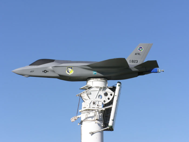

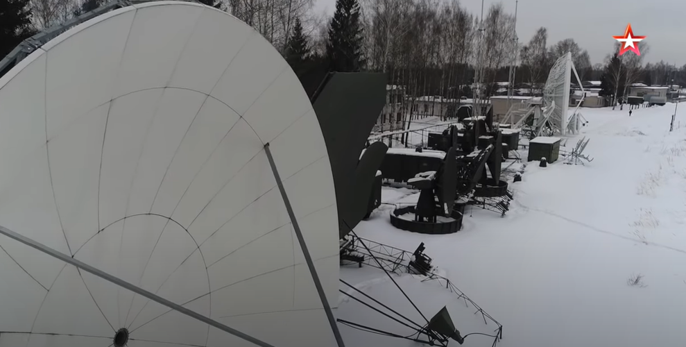

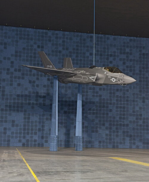

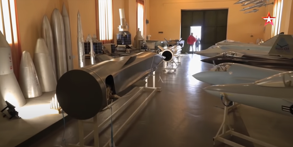

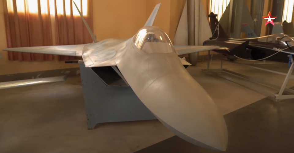

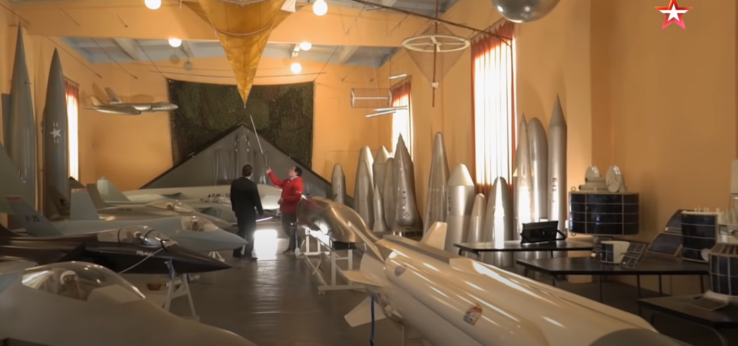

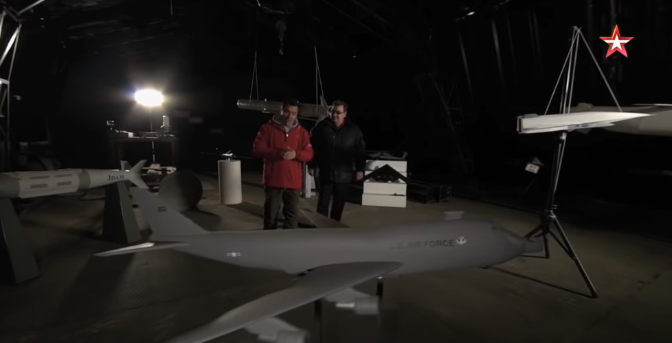

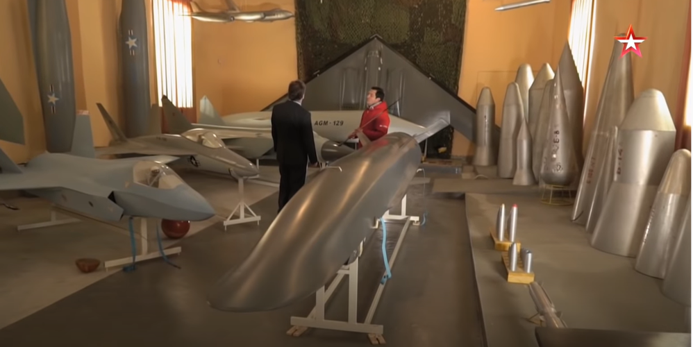

Models studied at the Central Scientific Research Institute of the Aerospace Forces of the Ministry of Defense of the Russian Federation (NII VVKO). Former name "2nd Scientific Research Institute of the Ministry of Defense"
This is how full-size models are suspended on a rotating platform.
And irradiated in different wavelength bands
I mean, any computer simulation does not give high-quality results.
I didn't engage in any dispute with them , if you took my advice and opened a book, you will see that free space basic transmission loss and atmospheric attenuation are completely different things. Atmospheric attenuation is caused by the energy absorption of gas and molecules in the atmosphere, if you transmit radio wave in a vaccum, there is no atmospheric attenuation. Free space basic transmission loss is the lost caused by the spread of the radio beam over distance, you still have that even if you transmit radio wave in space vacuum.

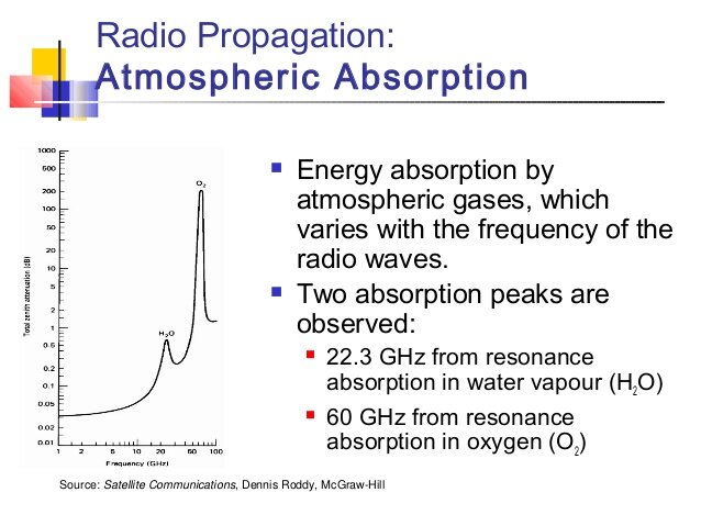

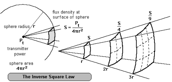

Atmospheric attenuation:
link-power-budget-calculation-and-propagation-factors-for-satellite-communication-3-638.jpg
vs
Free space path loss
There are already more than enough overwhelming evidences. You are just quibbling

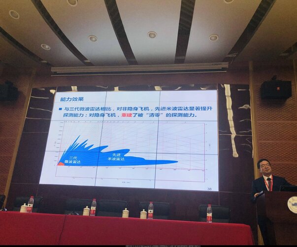

The chart given by Wu Jian Qi has number on it, which can be used to deduce the stealth quantity
The comparison by Robert Wallace is straight forward and can be used to deduce the RCS
The charts and reduction percentages from LM slides are very straight forward and can be used to deduce the percentage of RCS reduction
The number given by Michael Hake is straight forward.
All these evidences support the same conclusion.
Firstly, the aircraft is pretty symmetrical so it doesn't matter
Secondly, when there is a telephone pole flying at you through the cloud cover at two - three time speed of sound then anyone can make inaccurate estimation, let alone something as small as the different of 50 and 65 degrees.
Thirdly, no. The detection was done by the P-18 radar, when the airplane got close, they tried to track it with the fire controlled radar, falling several times before finally acquired a lock and launch missile immediately. And also the aircraft was extremely close to the site, so even a small bank angle can lead to its tail making a 90 degrees with the ground radar

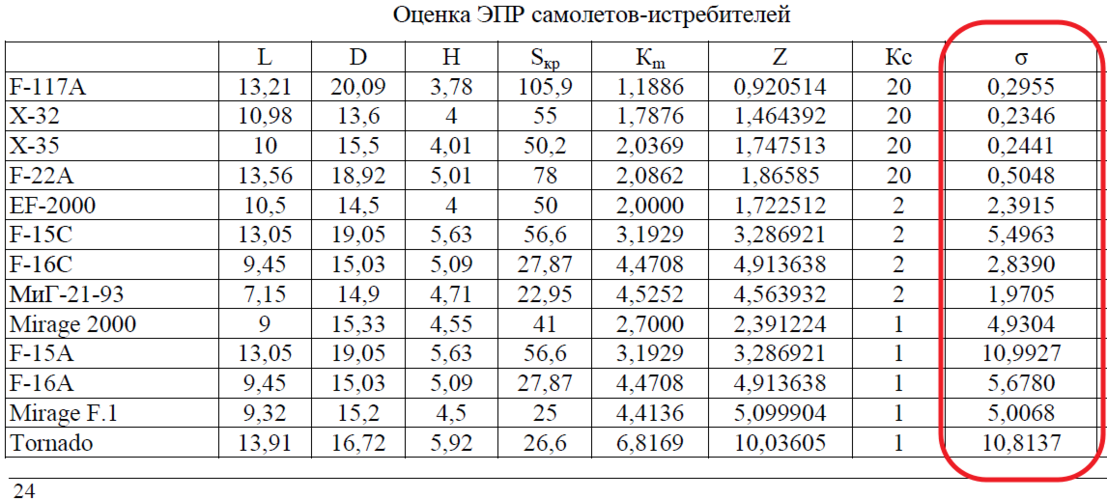

studies where radome and nose cone is model look like this
If you believe the Chinese experts, then maybe you will believe the Ukrainian ones too.:D
The thing is, how did they arrived at these numbers? did they made individual models for each airplane then test?, I don't think they did. And even if they do, what does their model look like?
And what does these number mean? average? min? max?

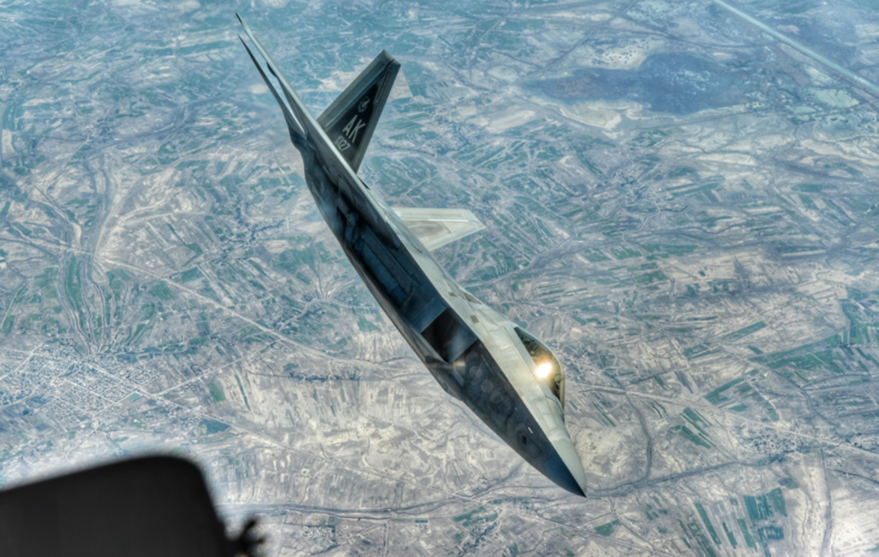

F-22 in Syria
Spoiler: +
Luneberg lenses are not observed.
Yes but is there any Russian airplane close by to analyze their RCS and are they tracked on Russian air defense radar?[/spoiler]

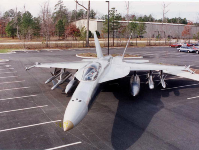

That actually look quite cheap and inaccurate compared to the kind of model USA used in their RCS test pole
The actual plane is used sometime
As satisfied as I am about the more than 1000fold improvement for smaller target detection with the usage of a sapphire crystal for targets from the achievements of that photonics team in Australia I have some following questions below here which relate to the last posts being discussed here.
At 100 nautical miles if using a low frequency aerial target it will be seen as a 5.5km tall, 1.6km wide and 200 meter depth target. F-35 is claimed as 1200mph max speed, it covers 20 kms per minute(can use the Su-57 as an example to), And since the Nebo-M is considered a circular scan that gives target updates every 5-10 seconds if its travelling at a speed of 1200 mph pulling a hard left or right 1.66 to 3.33kms. So we can add 3.33km for height and width of the box to 8.83kms by 4.93kms.
https://en.topwar.ru/168498-sistemy-pvo ... k-buk.html "The characteristics of the ARGSN used on the 9M317MA rocket make it possible to capture a target with an EPR of 0,3 m² at a distance of up to 35 km."
35(.0001 ÷ 0.3) ^.25 at a 4.73km distance a .0001m2 target can be tracked with a buk-M3’s missile autonomously by the missile itself. http://www.1728.org/angsize.htm if we assume that the radar beam angle 120 degrees with a 4.73km distance the size of the entire radar beam horizontal angle would be 16.73kms with 8.83kms covered and if the Elevation angle is the same or smaller the 4.93km height can be covered. However the only thing I did not take into account is
1. 9M96MD and 40N6 are not only new missiles with active homing capabilities like the Buk-M3 missile but bigger in size which I assume they will see something smaller and farther than 0.3m2 passed 35kms.
2. Considering the flight ceilings of the 9m96MD and 40N6 it seems that more than half their flights they will be able to fly above the max flight ceilings current aircrafts are capable of. Meaning these host radars will be pointing their radar beams on top of highly reflective topside surface of aircrafts which could be considerable in RCS size compared to pointing a radar beam at the front of an aircraft.
Everything is cheap in Russia! We sleep in the straw and scratch our backs with our teeth.:D

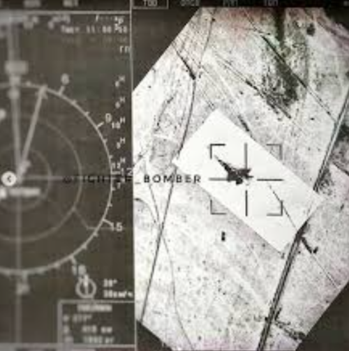

F-22 on the screen (OLS) of the Su-35 in Syria.
Probably the same as the Chinese experts.
You have another problem. If you like the figures, you write it down as proof, if you don't like it, then you reject it.
I didn’t understand this document.
And the Chinese experts, what are the numbers for the F-22? Average and minimum?

Firstly, you are still confusing between the free space path loss and atmospheric attenuation. They are completely different things as I already taught you earlier. free space path loss is very significant because it is the spread of signal density and you will have it even if you transmit in a vacuum. Atmospheric attenuation is the absorption of atmosphere and very small for frequency like X band and lower, it also doesn't exist in a vacuum.
Secondly, I already used the Dmax formula for the calculation that I gave you earlier.

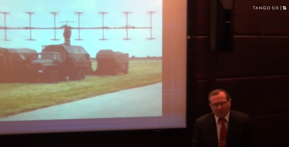

Nope, it was P-18. I have the presentation given by Zoltan Dani himself

No, it is the same. For the chinese radar scattering simulation, I can at least see what their model look like. In the simulation cited by tequila, I can also see the model and the method they choosen for simulation which is without canopy and radome cone. In both case, there are radar scattering graph to see the distribution of lobes. In case of the chart given by Wu Jian Qi, there is no number for the aircraft RCS, but there are comparative detection range and also the actual event where only the VHF radar detected the fighter and nothing else. Whereas in case of Ukrainian experts, they only given a generic value, since they aren't the one who made the fighter, how they get the value is important.

A computational electromagnetics model is used to predict the radar cross section of an object in software.
Scaled testing in chambers and full scale testing on outdoor RCS ranges is used to *validate and refine* the computational electromagnetics model. If the prediction does not match the measurement you go back and work on it until it does! That's the secret, and how the prediction gives high quality results.
This is exactly what some of the strange shapes seen at outdoor RCS ranges are for. Validating computational models with measurements.

I'm tired. I showed you that two radars with the same scanning and energy properties, but different in wavelength (1.1 m and 0.03 m) will have different losses. This difference is 31 dB.
Do you agree with that?

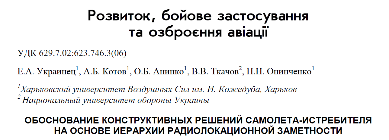

1. Chinese experts are not an official source, just like Ukrainian experts. The point is simple. You like the Chinese number, but not the Ukrainian one.
2. LM presentation, does not contain figures. The air defense loss graph cannot be compared with the RCS numbers.
3. The words of the LM representative do not contain figures, but only abstractions that can be interpreted as you like.
4. The article of the Air Force Major, has figures. But they were taken from a certain writer. Where did the writer get these figures- I don't know.
In addition, these figures do not agree with other sources for a small RCS. They claim that the RCS B-2 is less than the F-117.
I will not argue about this. Although Anich in his book talks about the P-15. It is the P-15 that is attached to the S-125 divisions. The P-18 is assigned to the S-200 divisions.
Well, experts from two Taiwanese institutes believe that the RCS of the F-22 from the nose, at a frequency of 2 GHz is 12 m2
I understand that you will now say that they are complete fools, because you will not like this figure. But they did the same as the Chinese specialists.
We have already found out that we do not know which radars he is comparing on his diagram. And to estimate the RCS from this picture is like looking for numbers in the LM presentation by the percentage of losses from air defense. There is nothing that one could catch on to get at least some numbers. There are not even indirect signs by which something could be determined

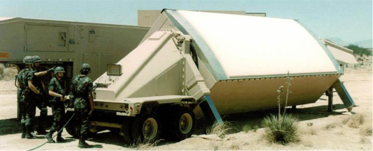

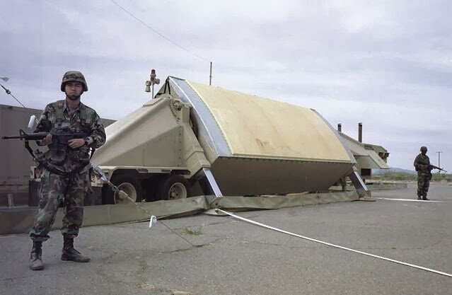

Secondly, the area of TPY-2 isn't 6 m2 but 9.2 m2.
and its side isn't 1.4 meter unless you think these guys in this photo are all dwarf
SBX radar is even bigger than TPY-2

No one with experience would confuse between atmospheric attenuation and basic free space basic path loss
I'm tired. I showed you that two radars with the same scanning and energy properties, but different in wavelength (1.1 m and 0.03 m) will have different losses. This difference is 31 dB. Do you agree with that?
You wouldn't be tired if you just took my advice, open a book and learn the different between atmospheric attenuation and basic free space basic path loss ;)
Secondly, as I explained earlier, the free space path loss is caused by the spread out of radio wave as they propagate through space, it is literally the inverse square law working.
Before you argue "why does the loss increase with frequency if they both follow the inverse square law", remember that you compared the two radar with same beam width, but one radar use VHF frequency and the other one use X-band. That lead to the aperture area of your VHF radar being 111.5 m2 and the aperture area of the X-band radar being 0.082 m2, in other words, the VHF radar in your example is 1359 times bigger than the X band radar. Because this free space path loss is literally the spread of beam over distance, a bigger radar aperture will collect signal from greater area, and that why the loss is less for bigger antenna even though both follow the inverse square law principles. I repeat again, this has nothing to do with atmospheric attenuation
However, when you put everything inside Rmax equation, and there isn't an insane size different between the X-band and VHF radar then X-band radar win hand down in term of detection range. That why your claim that RCS at VHF is only 5 times bigger than in X-band make no sense, because if that is the case than X-band is a much better anti stealth tool.

1. Because the Chinese number actually reference a real life incident ;)
2. Yes , it can be compared with number, they very carefully divided the graph into equal section, 5 folds reduction in detection range can be translate to percentage reduction in RCS
3. There is nothing particularly abstraction about golf ball or marble, they have explained before that they often used a ball to talk about RCS as the RCS of it is independent of aspect so easier to imagine.
4. The Air Force Major with all his experiences certainly think the numbers are accurate enough to cite;)
5. Depend on frequency, at lower frequency it isn't hard to imagine B-2 will have much lower RCS
Understand, if the person was not sure, then he would have picked up a more general word. But he indicates exactly the value (figure).
At the same time, non-standard direction angles, such as 45, 90, etc. And clearly 50.
He gave his estimate by his naked eye, that it. There is no requirement for him to be absolutely accurate with his estimate and given the condition he was in, it is quite impossible for him make super accurate estimate. In high stake situation, people have been shown to misidentify criminal suspects, pilots have been shown to mistaken between the sky and the ocean and die. Those are the things which are much harder to mistaken and people still misidentify them, nevermind something small like a different between 50-65 degrees or even his bank angle.
Let it be a poorly photoshopped picture. Like this one. :D
And as we can both see in that one, the F-22 carry not just 1 but 2 fuel tanks ;)
https://www.researchgate.net/public...sign_Key_Factors_and_Limitation_of_Simulation
On the other hand, I would say that their simulation certainly better than the vague number from the Ukraine. But unlike you, I look deeper than the surface, I care about the model as well
At first, the number seem weird for a stealth aircraft, 10 dBsm at front aspect is quite high even when consider that the model is a perfect conductor and has no RAM or edge treatment. Then I look at their scattering chart and even the breakdown between vertical and horizontal polarization and I find another strange characteristic. The very strong 12 dBsm scattering lobe is directly at the front with very narrow angle. What type of reflector has that scattering characteristic? A flat plate.
Then I look at their model and it all clicked ;) instead of modelling an S shaped inlet duct, they literally covered it with a flat metal plate. That is why they have such a strong reflection lobes directly in front of the aircraft an in such a narrow angle.
Isn't it strange that they spend such a long time to do such a detail simulation but overlook such obvious detail? Then I read their study and realize that they mentioned that as the primary reason for the high RCS. If you read their study, then you should know the reason for the high RCS value as well.;)
The S-duct is very important in RCS simulation because not only that it is a strong source of reflection, it is probably the only place on the stealth aircraft where the RAM absorption rating get accumulated to extremely high value of 50-60 dB due to multiple bounce of the signal. I don't blame them though, most simulation doesn't do the inlet correctly or just out right ignore it
There detection range show as km in the photo so you can't say there is no number. The VHF is JY-27, and while there is no mentioned of the exact type of the cm band radar, it is quite safe to conclude that it is something that does similar task to JY-27 and not some crazy comparison like a VHF air defense radar and a missile seeker.
A properly designed and written simulation will give results that are very close to reality. I don't know what your experience simulation is with computer modeling systems, but they are used because they do give high quality results.
American Physical Society, Report of the APS Study Group on Boost-Phase Intercept Systems for National Missile Defense, Vol. 2, July 2003, p. 177.
Specifically, this study says an effective aperture of 6 m2 and a physical aperture of 9.2 m2
See the message above.

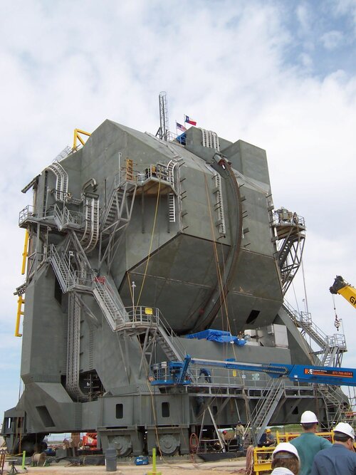

Honestly, I don't understand what kind of monster it is. And what is its purpose. They say that this is generally a radar for the HAARP project.
It is also known that not all modules are installed, so it is difficult for me to determine the exact dimensions of the antenna.
Of course, I took with the same beam width and gain. How else?
Listen to yourself ...
You make an x-band radar so that its energetic characteristics coincide with the long-wave radar, you increase the gain by increasing the area. Thereby reducing the beam width.
Yes, you have created an x-band radar that has the same size, range, but very long scan times.
And now you say that this radar is better than the long-wave one. Than? The size is the same, the scan time of the standard 60 * 60 sector is 10 minutes instead of 10 seconds.
Don't you find it funny yourself? :D
Show me in any of the simulations you have given before, is the air intake plugged?

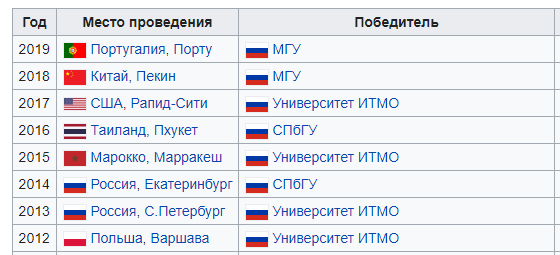

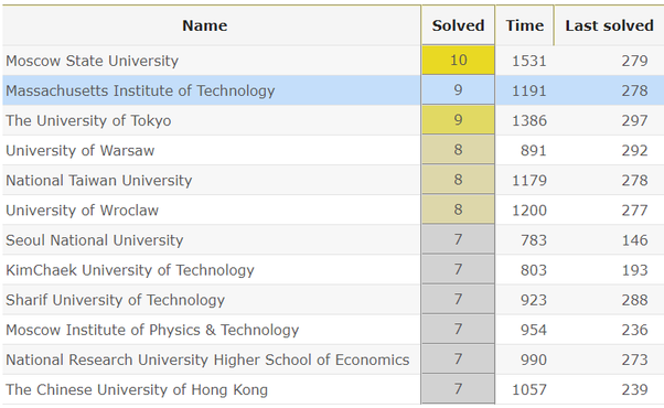

But we have been taking the first places in programming(ICPC) since 2012.
2nd place in 2018 and 2020. Just saying.
You referring to the Chinese or the U.S.? sorry if I am being oblivious.
Yeah I know
Maybe that is why they are doing better with autonomous flights with the Su-70 because that involves high level of programming for everything to work right.
