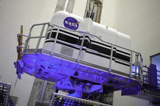

07.21.11
Control Allocation for Pilot-Induced Oscillation (CAPIO) Simulation on the Vertical Motion Simulator (VMS)
This pilot-in-the-loop simulation evaluated CAPIO's effectiveness in alleviating pilot-induced oscillations that occur when control surface actuators hit rate limits typically during aggressive maneuvering. The Cruise-Efficient Short Take-Off and Landing (CESTOL) mobility concept aircraft developed by Boeing Research and Technology (BR&T) for the Air Force Research Lab's Speed-Agile Concept Demonstrator (SACD) Program was used and the NASA-developed CAPIO controller was integrated with the SACD baseline flight control system. The system was evaluated using aggressive and precision maneuvers that were specifically designed to expose any Pilot Induced Oscillation (PIO) tendencies in the system in a controlled and repeatable manner. Seven experienced test pilots evaluated the system in a total of 647 data runs. The Principal Investigator for the study stated that, “The VMS staff support was excellent. Their dedication made this an outstanding experiment.”
http://www.aviationsystemsdivision.arc.nasa.gov/news/highlights/af_highlights_20110721.shtml

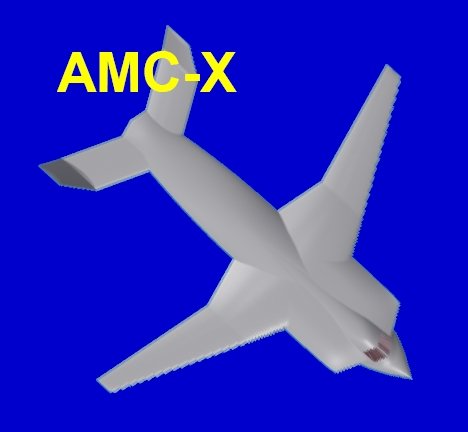

Not a very good picture, but the first top view I've seen of the Lockheed's AMC-X (Speed Agile) project:

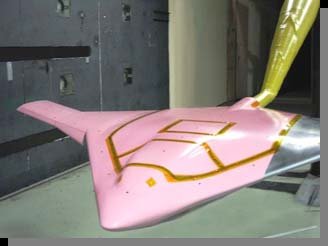

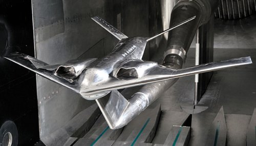

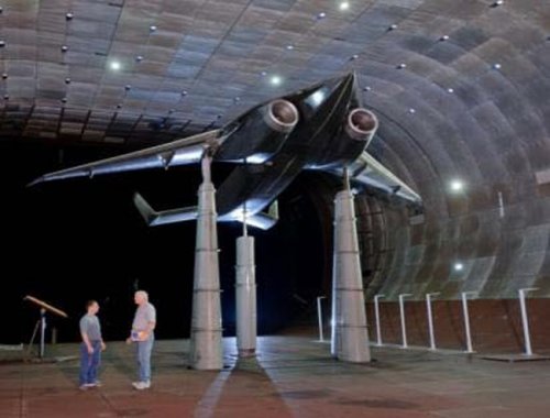

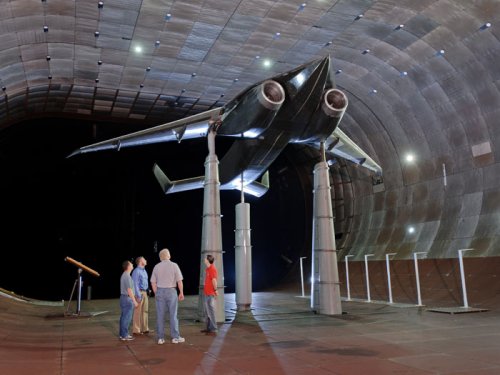

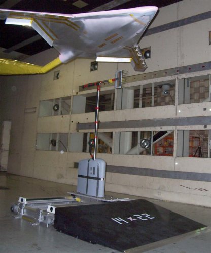

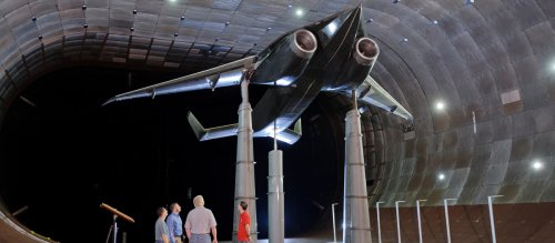

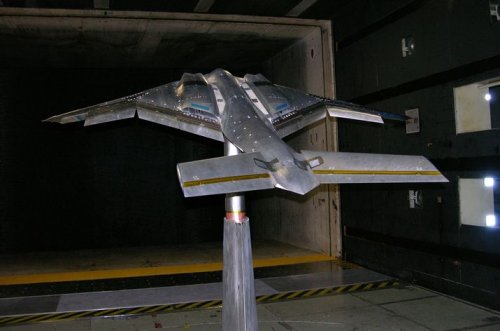

Speed Agile Concept Demonstration (SACD) powered model in Arnold Engineering Development Center (AEDC) National Full Scale Aerodynamics Complex (NFAC) WT and model of production configuration in Langley National Transonic Facility (NTF) WT
For better quality first photo see last AWST issue

I enjoyed reading the patent, Thank you Flateric
As is often the case, function defines form and I have to admit Boeing's configuration is quite elegant.... I doubt I'll ever see one of these flying however for the reasons stated earlier in this discussion.

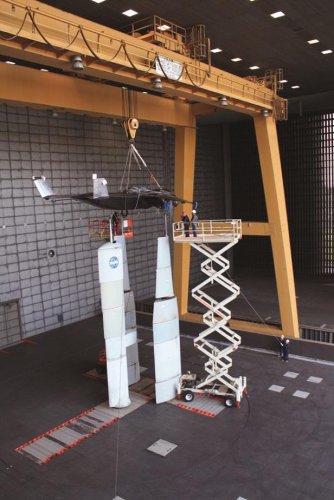

AFRL researchers are testing this 23 percent scale model of the Speed Agile vehicle at the Arnold Engineering and Development Center’s National Full Scale Aerodynamics Complex, the world’s largest wind tunnel. (AEDC/NFAC Photo)
http://www.wpafb.af.mil/news/story.asp?id=123281015

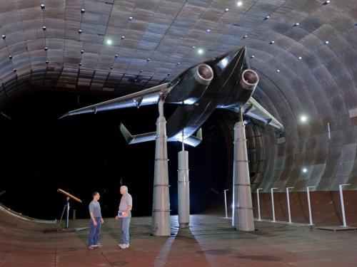

A 23%-scale turbofan-powered model of Lockheed Martin's Speed Agile powered-lift STOL airlifter concept for AFRL was tested in the National Full-Scale Aerodynamics Complex (NFAC) at NASA Ames Research Center in California. This consolidation effort brings together experts in scramjets engines, alternative fuels, unmanned vehicles, hypersonic vehicles, collision avoidance, and aircraft energy optimization.
http://www.wpafb.af.mil/news/story.asp?id=123307634

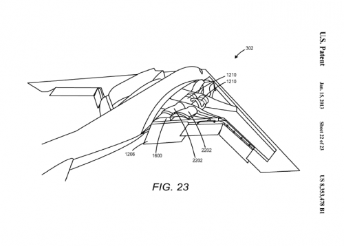

thanks to Stephen Trimble, a new Boeing's Speed Agile patent
http://www.freepatentsonline.com/8302908.pdf

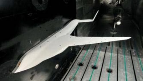

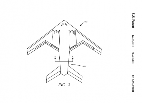

Boeing was issued a BWB Aircraft Patent # US8256706.
It has some interesting illustrations.

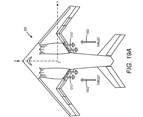

A.

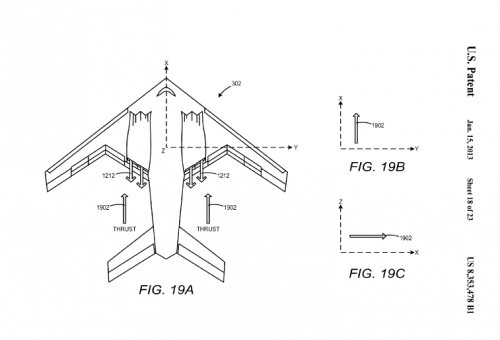

antigravite said:
WOW! almost perfect match. Your version seem to be the civilian chapter.
A.
There's a thread here somewhere with that design in it but for the life of me I couldn't find it. IIRC it's a Lockheed design.
edit: Here it is http://www.secretprojects.co.uk/forum/index.php/topic,215.195.html (Post #196. You'll also like posts #201 & 202.)
It's the advanced cargo design being looked at by the USAF. Isn't the program called FAST or something like that?
It's the Boeing AJACS.
Indeed those two projects are related, both the Boeing and the Lockheed model were part of the Speed Agile Concept Demonstrator program. I know the Lockheed model very well as I was one of the primary engineers for the physical design of the wind tunnel model.
