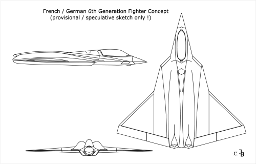

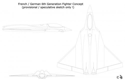

First attempt for a provisional 3-view, clues and corrections welcome.
For those of you, who want to change the drawing by themselves, the
svg-file is attached, too.
svg-file is attached, too, just change the suffix .txt to .svg (svg-files aren't
allowed as attachements).
Looking good so far Jemiba, I notice that you have designed the fighter to have the EOTS as standard. I take it that all future fighters from the 6th generation will have such a system as standard thus removing the need for anymore external targeting pods.
thx for your effort for this drawing
width of body including inlet seems to be too narrow compared to width of lex and nose

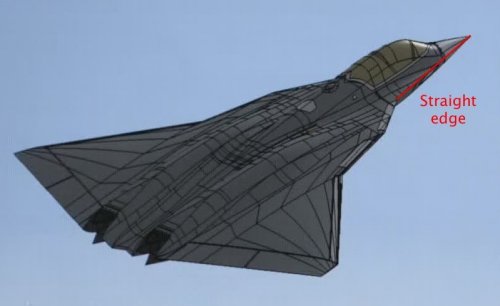

Nice Jemiba ! :°

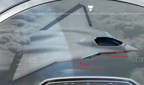

I think the nose edge is a straight line. see.
Also the funny thing , to have less angles difference, that LERX outer edge would logically be paralel to the nose edge...
It's not.

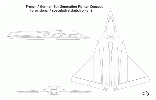

Second attempt:
It's not.
You're certainly right, changed.
That change additionally widened fuselage and inlets, although only very slightly.
  • F-G-Fighter.svg

Thicker lines...
  • F-G-Fighter-thicker.svg

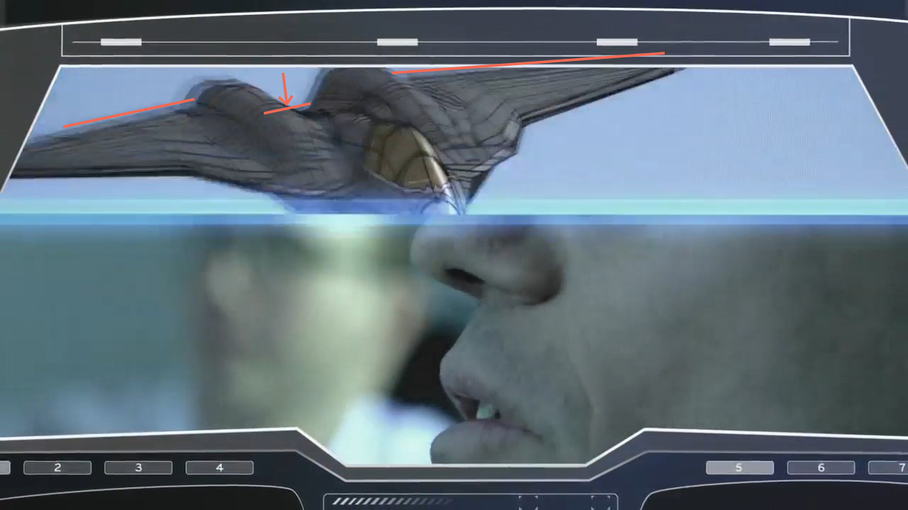

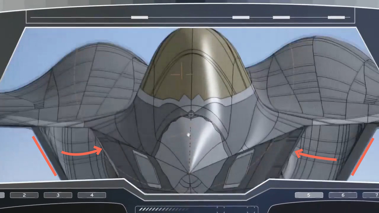

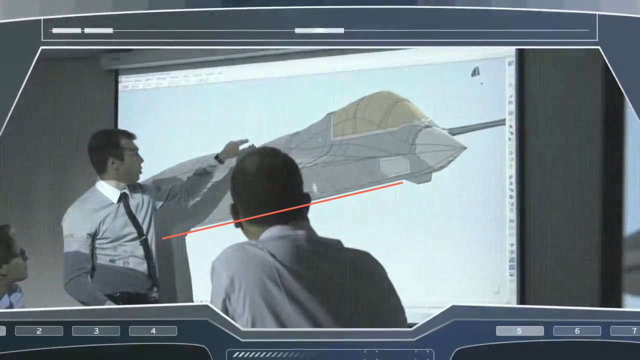

Front View
  • Wings for Europe - Dassault Aviation.mp4_snapshot_03.19_[2018.07.04_16.31.17].jpg
Great but this model is what Houdini could do best: a stealth blanket only to hide from the press the embarrassing decade of BS from the EU industry ("stealth is dead", "there would be no more wars but with spear handed savages" (well we had the savages for sure), "Drones are only gadgets")...
I call this aircraft the dodge fighter because it allow everyone to look sideway while we are committing the future generation to pay for to an huge load of money at the higher risks ever seen on the market.
If you are skeptical, look at the side wall of the from section that without rudder will induce a divergent beta for very small angles.
This thing has Rafale (=M2k) wings, Rafale stylized faceted front section and no tail without any inherent search for induced stability. As a fun factor it has LEVCoN's and f-23 hype (without any apparent understanding if the usefulness of this aero configuration).
Up to to you to make your own informed opinion....

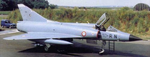

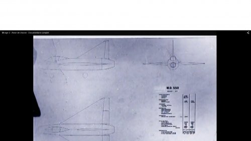

-Very first known drawing of the future MD 550 (picture 1)
-MD 550 in service... (picture 2)
Maybe the final shape will not be like the first picture (trick, BS and press or not)... What a scoop...
-Rafale had bad directions too... (picture 3)
--Dassaut studies the next french fighter since decades, yes, with stealth, yes, and pilot, yes, with almost no money (except for the UAV Ducs and the NEURON), yes... (pictures 4 and 5)
For my own I am interested in the successor of the Rafale since decades... And all that I can find about this, here or elsewhere, is interesting for me. But to know the final shape of the plane, I'll do like everyone : wait and see... And only then I will say what was exact or not, whatever anyone else said/says/will say.

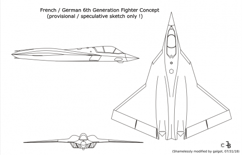

Spend some time studying the few available images as I really like the shape of this thing.
Took the liberty to modify jemiba’s drawing and post the result here.
I think the engines are more widely spaced (not by much) , the wing is something like between a diamond and double-delta with lerx. Also the nose is very much like a bird beak. Added the canopy frames, but don't know if they should be , or if they are just geometry lines (beziers ?) on the CAD images.
Still , I don’t really understand the engines pipes geometry .
  • JemibaSCAFproject-mod073118.svg
The inlets ducts goes inward to the center , so i suspect eventual weapon bays to be on fuselage side on these flat faces, after the inlets turns ?
Or in the space between the engines, before these ducts turns ? Also the wings are quite high :
One image shows a very flat underside too :
Even more so that the bottom edge of the space between the engines seems to go down to fit a flat under fuselage surface :
Yes, radome is very small, even by "rafale standard" ;) Wonder if they had the same carrier landing view requirement in mind as the Rafale...
Note also there seems to be "cheek" antennas on the nose sides. So maybe a distributed antennas radar system.
Great, thank you !
About the canopy frames, I'm not sure, too. If there are frames, it really could be, or at least would
look like a two-seater. But the middle line of the "windshield frame"touches the most forward line.
The F-35 has a frame, the F-22 not ...
But apart from that uncertainty, you're much closer to the "real thing", than me !
The F-35 frame is an internal brace supporting the canopy from inside. A similar solution might be intended on this concept.
