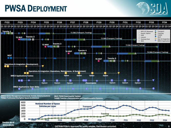

insidedefense reporting MDA FY2025 GPI plans, expected to pick a winner soon between Raytheon and Northrop Grumman, cutting near term funding overall by $700 M, MDA hoping Japan will pick up the slack as they did with the Raytheon/Mitsubishi Heavy Industries SM-3 Block IIA , fielding of GPI expected to slip a year to 2035

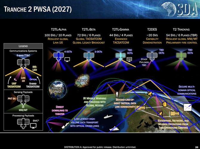

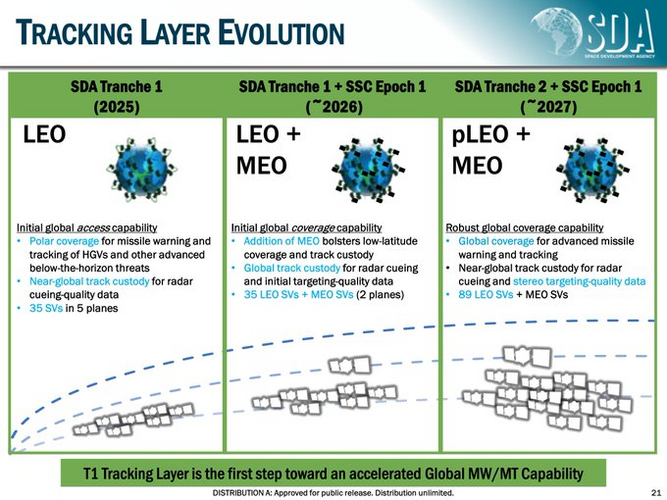

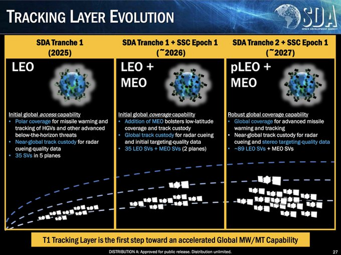

Is there a thread dedicated to the Proliferated Warfighter Space Architecture or should I just put anything regrading hypdersonic defense here? Or start a new thread? I feel the PWSA is going to go way, way beyond merely tracking hypersonic weapons. In fact I do not even think that will even be the primary mission of the coming LEO constellation; I think it is a lot bigger than that.
