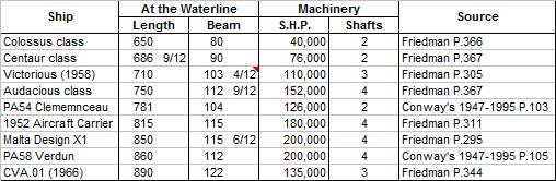

Four 35,000 ton carriers were built in the HMS Glorious thread and five or six 1952 Carriers were laid down from 1950 in this timeline and completed 1955-61. They would take the names of the first 5 or 6 RN aircraft carriers. That is Argus, Courageous, Eagle, Furious, Glorious and the sixth if built would be called Hermes.
All would be built with a pair of BS.4 steam catapults with a stroke of at least 199ft (and preferably 250ft) and a fully angled flight deck. It might not be possible to complete the first ships with the Type 984 radar, CDS & DPT and if that was the case they were fitted with the Type 984M radar, ADA & DPT during their first major refits. The reason why they were all completed with fully angled flight decks was that that someone had the idea four years earlier.
They also had a modern torpedo defence system, AC electrical systems (which Ark Royal, Centaur & Eagle didn't) and modern accommodation for the crew. The latter may have helped the RN recruit and retain more men over the coming years.
Due to the theory that "steel is cheap and air is free" they don't cost 50% more to build than the 35,000ton design and some of the money used to build the fifth ship came from what was spent on Albion, Ark Royal, Bulwark, Centaur and Eagle 1950-55 in the "Real World".
The 5 or 6 ships built form a homogenous class with hulls and machinery that should have had at least 20 years of life in them & even more if they had SLEP refits like the contemporary American super carriers. Therefore, a replacement class wasn't required until 1975 at the earliest. Furthermore, unlike the 5 strike carriers that the RN had in 1960 in the "Real World" these ships were capable of being made to operate the Buccaneer and Phantom at a price the British taxpayer could afford.

name builder laid down trials com decom
Argus 195? 58? 61? 70
Crgus 195? 60? 62? 74
Eagle 195? 60? 62? 74
Furis 195? 61? 63? 83
Glrus 195? 61? 63? 85
Herms 195? 61? 63? 85

I wrote those from memory. Since then I've checked my copies of Brown and Friedman.
Dimensions of British and French Aircraft Carriers
The lengths of PA54 and PA58 are their lengths between perpendiculars. However, I have been informed that France measures it differently and the between perpendiculars length is the same as the waterline length. I haven't included the 1954 Medium Fleet Aircraft Carrier because I don't know it's dimensions. However, it was intended to have boilers producing 135,000shp driving 3 shafts so my guess is that it would have had 3 sets of the Y.300 machinery projected for the 1952 Ship.
The 1952 Aircraft Carrier was smaller that I expected.
  • It's length was nearly half way between the Audacious class and CVA.01.
  • It was only 2ft 3in wider than the Audacious class and 7ft narrower than CVA.01.
  • Most surprising of all was that it was 45ft shorted than PA58 and only 3ft beamier.

I ran the estimates through the Bank of England inflation calculator.
  • £26 million in 1953 was worth:
    • £27.7 million in 1955 when I think the first pair of ships (Argus & ALT-Eagle) would have been completed.
      • These ships would have been completed to Standard B, i.e. no Type 984 radar, CDS & DPT (because I think they wouldn't have been ready in time) which would have reduced their cost somewhat.
    • £31.1 million in 1958 when I think the third ship (ALT-Hermes) would have been completed.
    • £31.2 million in 1959 when I think the fourth ship (Courageous) would have been completed.
    • £31.5 million in 1960 when I think the fifth ship (Furious) would have been completed.
    • £32.5 million in 1961 when I think the sixth ship (Glorious) would have been completed.
  • £18 million in 1954 was worth:
    • £18.8 million in 1955.
    • £21.0 million in 1958
    • £21.2 million in 1959.
    • £21.4 million in 1960
    • £22.0 million in 1961.
According to Brown & Hobbs the 1950-58 rebuild of Victorious cost £30 million. However, Marriott, Jane's and Hansard say what I sometimes refer to as her "great rebuild" cost £20 million. I'm inclined to believe the lower figure. I ran that through the Bank of England Inflation Calculator too and £20 million in 1958 was worth:
  • £16.8 million in 1953 which is £9.2 million less than the projected cost of the 1952 Aircraft Carrier in 1953.
    • And.
  • £17.3 million in 1954 which is £0.7 million less than the projected cost of the 1954 Aircraft Carrier in 1954.
However, all that was left of the original Victorious after she was rebuilt was the hull and the turbines. Everything above the hangar deck was brand new and (according to Marriott) below the hangar deck virtually every compartment outside the machinery spaces was rebuilt, all wiring & piping was renewed and new auxiliary machinery was installed. Plus the boilers were replaced (but he wrote that it was as a result of the existing boilers being damaged in an accidental fire) and bulges were fitted.
Much of the above would have cost the same regardless of whether it was installed in an existing hull or a new hull.
  • E.g. the Type 984 radar, CDS, DPT and the twelve 3in AA guns in six twin mountings.
  • The steam catapults, arrester gear and lifts of the same capacity would have cost exactly the same too.
  • But more powerful steam catapults, arrester gear and lifts of heavier capacity would have been fitted to the 1952 & 1954 Aircraft Carriers. They would have been more expensive, but the cost may not have increased in proportion to the increase in capability.
  • On the other hand the 10 steam catapults fitted to Ark Royal, Centaur, Eagle, Hermes & Victorious 1955-64 in the "Real World" were 4 different lengths (2 x 139ft stroke, 2 x 145ft stroke, 5 x 151ft stroke and one x 199ft stroke) and in this "Version of History" the 6 new strike carriers that were completed 1955-61 were fitted with a total of 12 x 199ft stroke catapults which might have cost less per unit due to more being built and to the same design.
  • It might be a similar story for the lifts because more units were built to fewer designs.
  • And maybe the arrester gear too due to making more units to one design too, but I don't know as much about arrester gear.
Plus the cost of building a new hull might have been less (or at least the same) as rebuilding an existing hull and the cost of fitting it out might have been less (or at least the same as installing them in an existing hull) despite the new hull was larger.
This may be a false memory, but wasn't the cost of Eagle's 1959-64 refit (£31 million) the same as building a new ship with the same capability?
Therefore, my opinions are:
  • That the 1952 and 1954 Aircraft Carrier projects can be regarded as the same "insides" as the rebuilt Victorious in a larger and completely new hull with new turbines.
    • The "insides" cost about the same.
    • The "outsides" (i.e. the hull) costs, more but we can can deduct the cost of rebuilding the hull of Victorious from that.
    • The cost of fitting the new boilers for Victorious can be deducted fro the cost of the machinery of the new ship.
  • That a new ship built to the same standard as the 1952 and 1954 Aircraft Carriers 1950-58 might have cost less than the £20 million spent on rebuilding Victorious.
However, I'm sticking to the 1953 estimate of £26 million for the 1954 Aircraft Carrier. Therefore, the 6 ships that I want to be built would have cost a total of about £156 million at 1953 prices and £181.7 million after allowing for inflation if laid down in two batches of 3 in 1950 & 1954 respectively and completed in one group of 2 in 1955 and a second group of 4 completed 1958-61. That's not allowing for the pair of ships completed in 1955 having less expensive electronics.
Another thing that might have helped was "multi-year funding" because the Nimitz class ships Abraham Lincoln & George Washington were ordered together using this system and according to my copy of Jane's 1986-87 this reduced their cost considerably.
Originally it was estimated that a split buy of Abraham Lincoln (CVN 72) and George Washington (CVN 73) in two separate annual procurements would cost $8,024 million. The multiple-ship award in FY 1983 reduced the estimated cost for the two ships to $7,270 million, and it now appears that improved management practices and lower-than-estimated inflation will reduce the estimated cost still further to $6,516 million, with the prospect of even greater savings. It is also estimated that CVN 72 and 73 each will be delivered 22 months earlier than would have been the case had each ship been procured separately, and that Theodore Roosvelt (CVN 71) will be delivered in September 1986, 17 months earlier than originally scheduled.
Or put another way the original estimate was that $754 million would have been saved and the revised estimate was that $1,508 million would be saved. They were reductions of 9.4% and 18.8% respectively.
In my "Version of History" they ships were ordered in 2 batches of 3, with the long-lead items for the first 3 ordered in 1948 & the ships themselves ordered in 1949 and the second 3 were ordered in 1951. That may have been cheaper than ordering one a year 1949-54 and laying them down one a year 1950-55.
    • And.
The final settled cost for the Victorious rebuild was £19 million, the figure given in Hansard having been rounded up. The £30 million stated by Brown is erroneous.
Unfortunately, Brown's section on the medium carrier also confuses matters. In actuality, the ship estimated at £18 million is from 1953 and was almost certainly a two shaft design, probably a modernised Hermes in concept, not a three shaft medium carrier of the variety that made its way in to long-term planning in late 1954.
