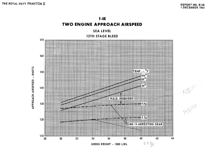

One problem with a 1962 UK F-4 - RN in 1964 , as quoted here https://www.secretprojects.co.uk/th...order-of-battle-1975.20517/page-2#post-420283 :
1701329128749.png #
Why were the drooped ailerons essential? 3 kts less for catapulting is nice, but even more important, the F-4J with them had a much lower landing speed, about 5-8 kts.
The original F-4B had a single engine approach speed of 150+ kts in hot conditions, the original mk13 arrestor could only take ~105 kts at that weight. An uprated version maybe 110-115 kts, but still no way to compensate with ship speed. With the F-4J, the gap would just shrink enough to get it into the 30 kts region.
The solution would be the mk14/dax2 arrester gear as in Ark Royal, but that was still several years away - Eagle trials in 1967?
Btw, I think that landing speed also eliminated the Phantom for the Clemenceau class at the time of the F-8 decision, along with the lack of money.
View attachment 712966#
By one small problem do you really mean one very important problem? And does that make my proposal impossible?
The first flight of the F-4J was 27.05.66 with the first flight of the F-4K prototype was exactly one month later (27.06.66) and the first 3 production FG.1s arrived at Yeovilton on 29.04.68.
However, the first flight of the F-4K prototype was behind schedule because the reheated Spey took longer than expected to develop. This is why I expected the main objection to getting the F-4K in service in 1967 instead of 1969 to have been getting the reheated Spey engine ready by 1967 and that's despite starting development of the engine in 1962 instead of 1964.
I thought that the Spey-Phantoms had boundary layer control and the standard-Phantoms with J79 engines didn't. However, when I checked my copy of Roy Boot's "From Spitfire to Eurofighter" it said.
Both aircraft used boundary-layer control by blowing engine bleed over the flaps and leading edge.

MACAIR then also discovered that the tailplane maximum lift was inadequate. They added a fixed slat to the tailplane leading edge, and were very interested to find that we had applied leading-edge blow to the Buccaneer tailplane to achieve the same objective. At a later date MACAIR introduced a wing leading-edge slat to improve combat manoeuvrability, reminding us of our original proposal for the Buccaneer wing.
Does that mean that the cause and effect was the opposite. That is Hawker Siddeley Brough (the sister design firm for the British Phantoms) used their experience on the Buccaneer to add drooped ailerons to the F-4K which MACAIR thought were such a good idea that they added them to the F-4J.
Spot on. The Aéronavale badly wanted the Phantom, but it was marginal if not dangerous on Clems (just like A-7s, Hornets and Rafales).

Another reduction in approach speed with the F-4J came through an "Approach power compensator". Not much information available on this one.
The problem with the scenario is that the RN would have to risk a Phantom license production in 1962 knowing that their carriers could not handle landing until the aircraft modification or dax2 solution were available. Dax2 would probably be needed anyway as the weights and approach speeds of the F-4K, especially single engine, increased a good deal. If dax2 fails the RN would have to wait for US mk7-2 on CVA-1.

Do you have any information on DAX2? Could it have been developed sooner? After all necessity is the mother of invention. I think it's been mentioned here or on alternatehistory.com that development had been underway for some time before the decision to buy F-4K was made because it was designed for what became the CVA.01 class.

As for dax2: Not much. It was under development in 1962, maybe 1961. In december 1964, McD used the mk14 characteristics. First actual ship trials on Eagle in 1967. The system adapted a method used on airfields to ship use if I understand that correctly, so you could argue it's a low risk development.
Capacity is pretty steady, the F-4K was extra strengthened to 4.8g:

I originally suggested starting development of the Spey Phantom in 1962 instead of 1964 so it could enter service with the RN in 1967 instead of 1969. However, it looks as if the DAX.2 arrester gear can't be put into service earlier than 1969 so there's no point in starting development of the Spey Phantom 2 years earlier so that it can enter service with the RN in 1967 instead of 1969.
However, when the DAX.2 arrester gear became available would have been irrelevant to the RAF. So development of the Spey Phantom could have been begun in 1962 instead of 1964 with the F-4M entering RAF service in the ground attack role with No. 6 Squadron in May 1969 and the F-4K still entering RN service with 892 NAS in March 1969. But, it doesn't automatically follow that starting development of the reheated Spey in 1962 instead of 1964 results in the F-4M being ready in 1967 instead of 1969.
