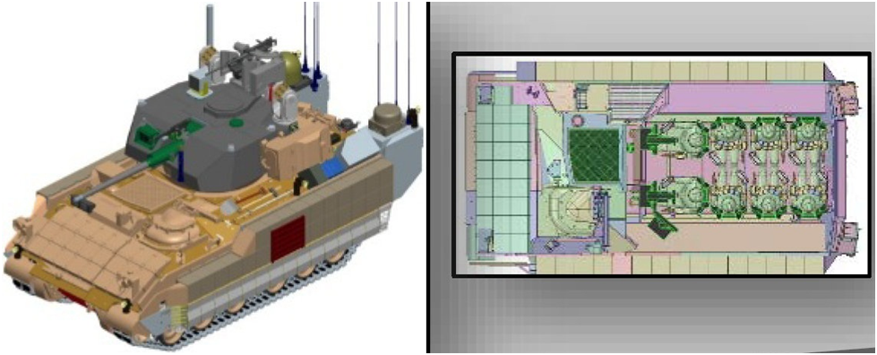

Looking at that proposed Bradley upgrade they do need to find a way to get that antenna farm under control.
Bradley design concept likely capable of mounting a 50mm Bushmaster IIIView attachment 677610
Which 50mm is it using? The telescoping 50x330mm, or the necked out 35x228mm 50mm derivative?

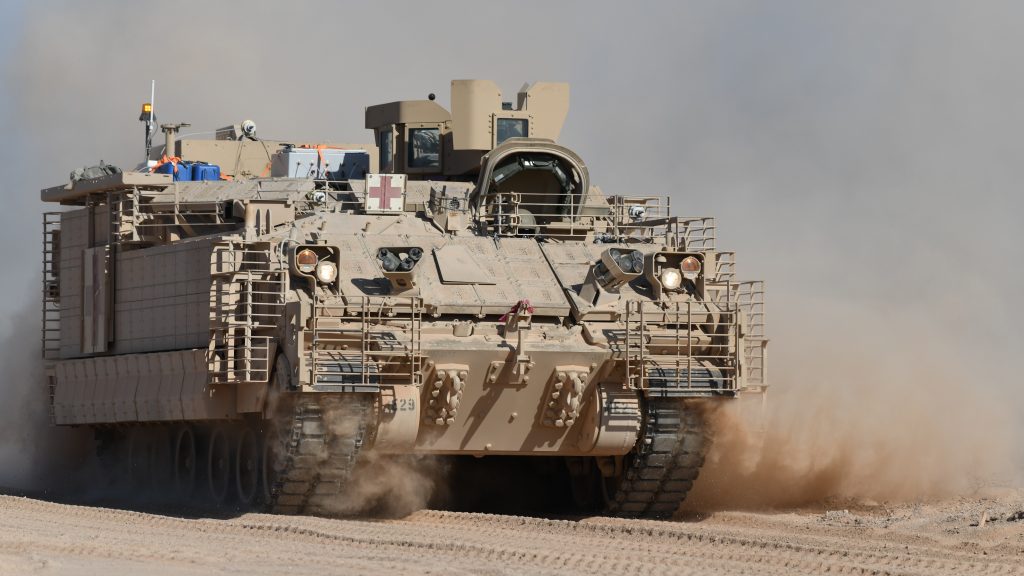

What the heck is this. Are we trying to be goofier than Russian and their cope cages?
Looks like a goofy roll bar. How do they imagine these things will be driven, by complete maniacs?
Brake too hard and it will do a full 360 roll forward!
Probably as GTX suggested, it's an antenna frame, which makes sense for a command vehicle like the one shown.
Camouflage net frame maybe?
An antenna would be my immediate thought, but this makes sense as well in the context of CUAS camouflage. A recent-ish Canadian Forces field exercise showed that camouflage netting was vital to avoid detection by drones when drones were overhead. Simply driving under scrub brush and putting the brakes on isn't adequate.
It could also be a mounting point for a standoff plate like the "cope cage"/emotional support armor but it doesn't seem particularly muscular so yeah.
Finally got an answer to this (thanks, AUSA 2022). This fold-able cage is for combat in urban environments that have a lot of wires and other overhead snag hazards. It's meant to push hanging/dangling hazards out of the way so they don't tangle with the vehicle's antennae or the cupola. In more open environments, the crew would probably stow the thing or leave it off entirely.
