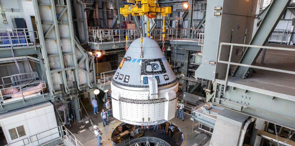

Boeing Advances Starliner Solutions in the Vertical Integration Facility
August 9, 2021
This weekend, Boeing restored functionality on more of the 13 CST-100 Starliner propulsion system valves that did not open as designed during prelaunch system checks last week.
Boeing has completed physical inspections and chemical sampling on the exterior of a number of the affected valves, which indicated no signs of damage or external corrosion. Test teams are now applying mechanical, electrical and thermal techniques to prompt the valves open. Seven of the 13 valves are now operating as designed, with inspection and remediation of the remaining affected valves to be performed in the days ahead.
Boeing is working a systematic plan to open the affected valves, demonstrate repeatable system performance, and verify the root cause of the issue before returning Starliner to the launch pad for its Orbital Flight Test-2 mission.
The company is assessing multiple launch opportunities for Starliner in August and will work with NASA and United Launch Alliance to confirm those dates when the spacecraft is ready.
Boeing will continue to provide information at www.StarlinerUpdates.com as it becomes available.

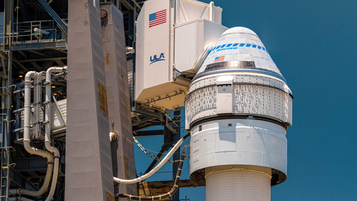

Boeing’s Starliner to go back to factory for repairs, probably causing another major delay for troubled program
"Boeing said Friday that it will remove its Starliner spacecraft from atop of a rocket to fix valves that have remained stuck, a decision that will probably force yet another months-long delay in its do-over of a test flight without astronauts aboard.
Boeing engineers have been trying since Aug. 3 to fix the problem, one in a series of significant issues that have plagued its spacecraft program for years. Boeing had been hoping to restore functionality to the valves and get a launch off to the International Space Station this month under its contract with NASA.
But the decision to move the spacecraft into a processing facility means the issue is a troublesome one, and because of other missions to the space station will probably mean that the launch will not go off until next year."

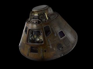

For the record: in 1996 before MDD Boeing also swallowed Rockwell Aerospace, formerly North American (1967). This company had build Apollo CM and SM so in a sense Starliner had clear Apollo CSM legacy.
Well the heritage obviously has been lost to time. Harrison Stormy Storm must spin in his grave in anger... also proof that a modern day Apollo isn't that easy to build; space is hard, Boeing is dysfunctional there.
What sounded obvious to Boeing, NASA or even the layman in the street... (build a modern day " heir of Apollo capsule" ) hasn't been obvious in the end.
Boeing seemingly had a decent, cautious design on hand ; lots of good arguments going for it; and so far has wasted a lot of them and credibility.
Now while Boeing has to figure out how moister enter NTO feed line and corrode a Valve, after it rain...
