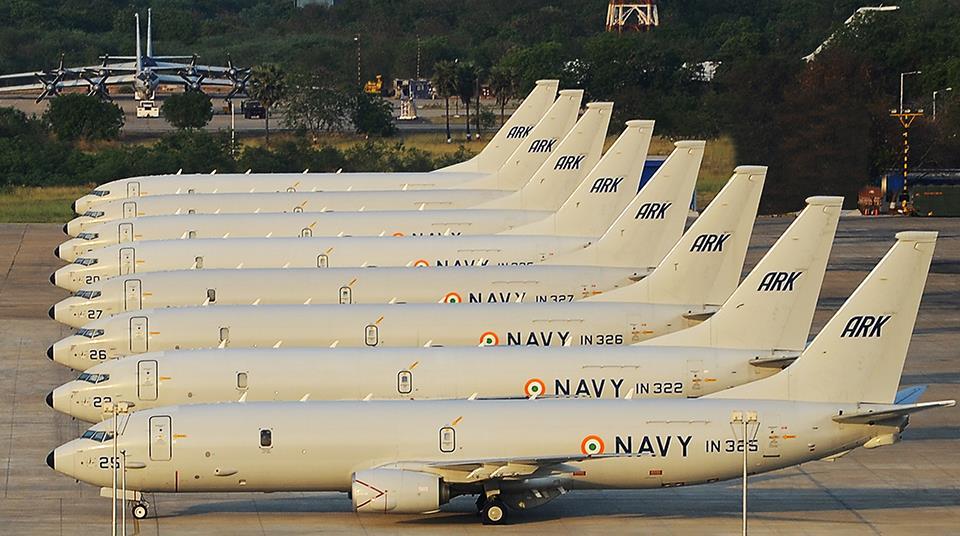

India use them with MAD sensors and doesn't seems to have any complaint to this day.
