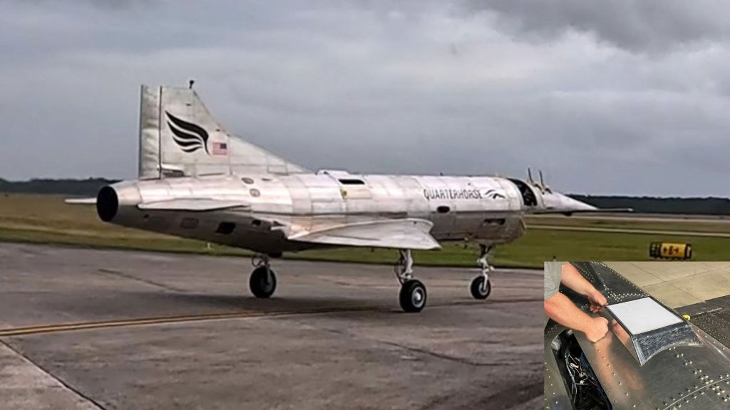

In your article, they literally bolted an COTS AESA to the inside of the canopy and got full network connectivity. Something similar was done with the AC-130 test connecting to the ABMS.
Can any military aircraft currently use Link 16 over Starlink by flipping a switch? No. But you acting like it is an impossible task to enable LEO comm connectivity in military aircraft is frankly as bizarre as it is absurd.
