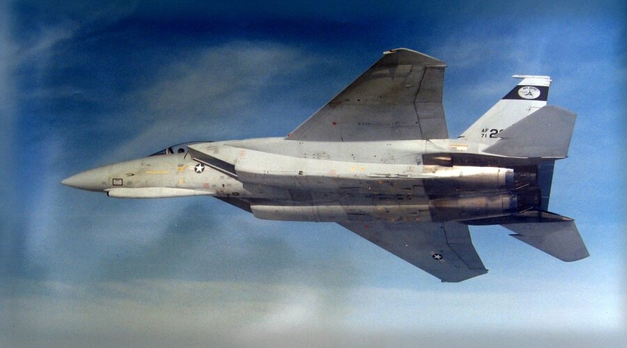

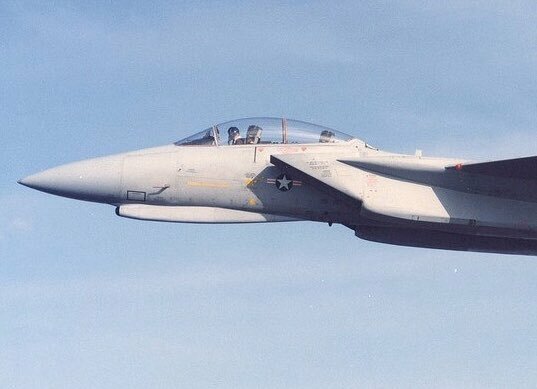

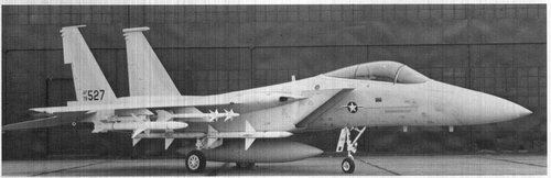

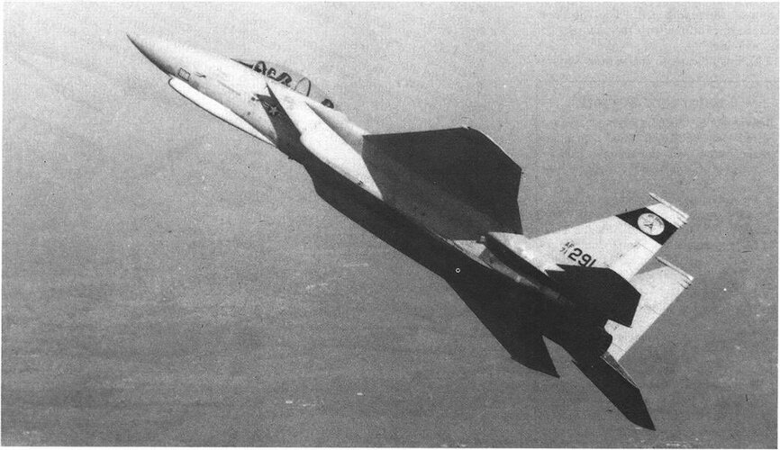

Wild Weasel F-15 (including specialized FAST packs) has been studied - and rejected - several times. First as a two seat F-15E variant (around 1983), than as a modified F-15C (in 1994, lost to the F-16CJ).
But the idea is still revisited regularly, without success.
