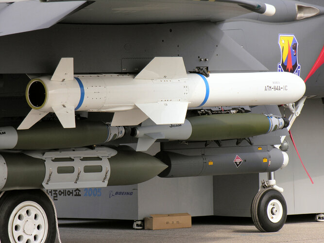

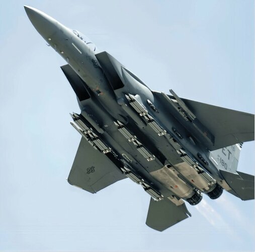

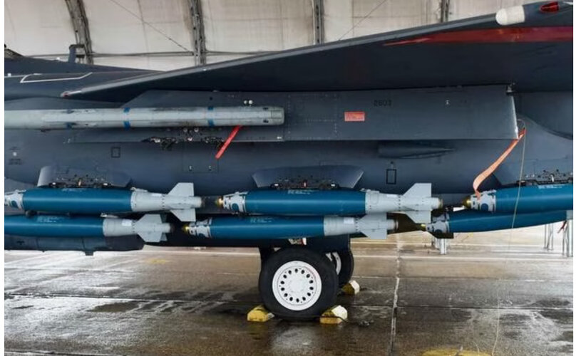

Can F-15EX carry AIM-120 or GBU-39 on its upper CFTs rows? On normal F-15E, I only ever seen that row carry basic MK-82. However, it was said that basic F-15E lack smart wiring for these station while F-15SK and F-15EX both have smart wiring there
No to both. The LAU-106 ejector launchers for AAMs only go on the lower CFT row. 4 SDBs on a BRU-61 rack are probably too heavy for the BRU-46 racks used on the upper CFT rows. I think they are limited to 1000 lbs.
On newer F-15s, all the CFT stations are wired for MIL-STD-1760 stores, that's true.
So maybe 3 GBU-39 is doable? or if F-15 operator somehow bought mbda Spear
I wonder if F-15EX could carry a dozen mk 82 JDAM? Fewer munitions than SDB but more bang. I think F-15E was alway capable of carrying dumb mk82s or CBU-87 on all these stations.

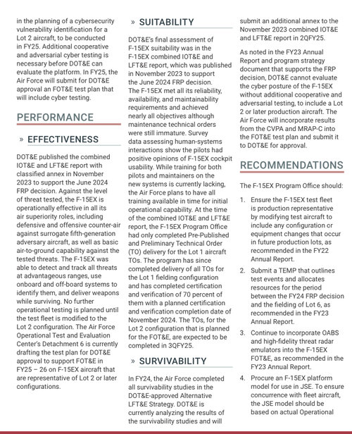

F-15EX are very effective against 5 generation aircraft. I wonder whether they tested it against red team F-35 or F-22?
Probably worth noting that the term used is surrogate 5th gen adversary aircraft. I expect that means that maybe US F-35 or F-117 but what that also means is they are replicating the threat. So the profile, EW and RCS within reason replicate what the US believes adversary 5th gen aircraft are capable of. The F-15EX wasn't flying against a USAF F-35, it was potentially flying against an Aggressor F-35 configured to look, act and where possible smell like a Su-57, J-20 etc.
