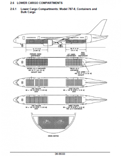

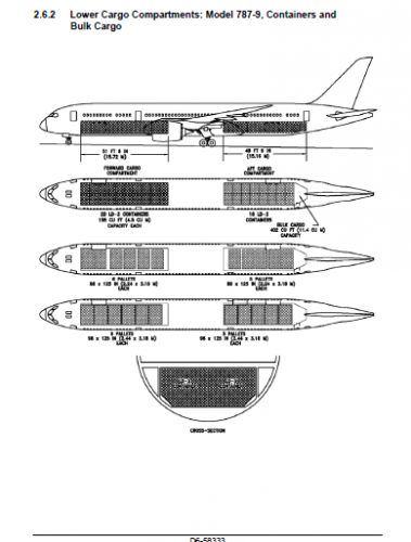

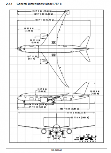

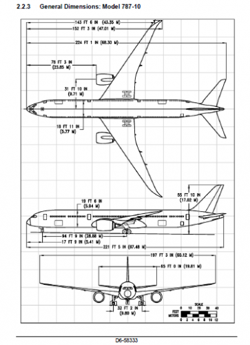

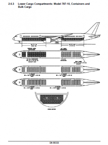

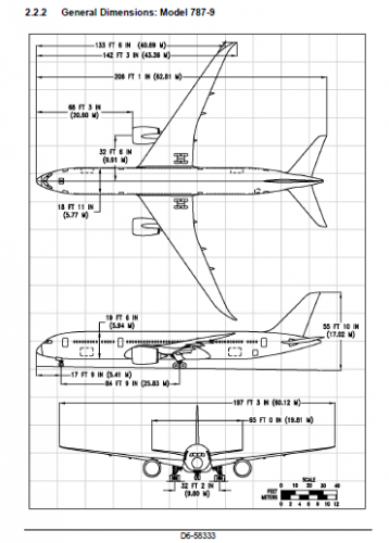

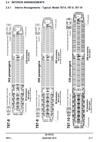

Hi! Boeing's official drawings.
Anther drawings to Boeing 787-8,787-9 & 787-10,also a comparison.
http://www.boeing.com/assets/pdf/commercial/airports/acaps/787.pdf
