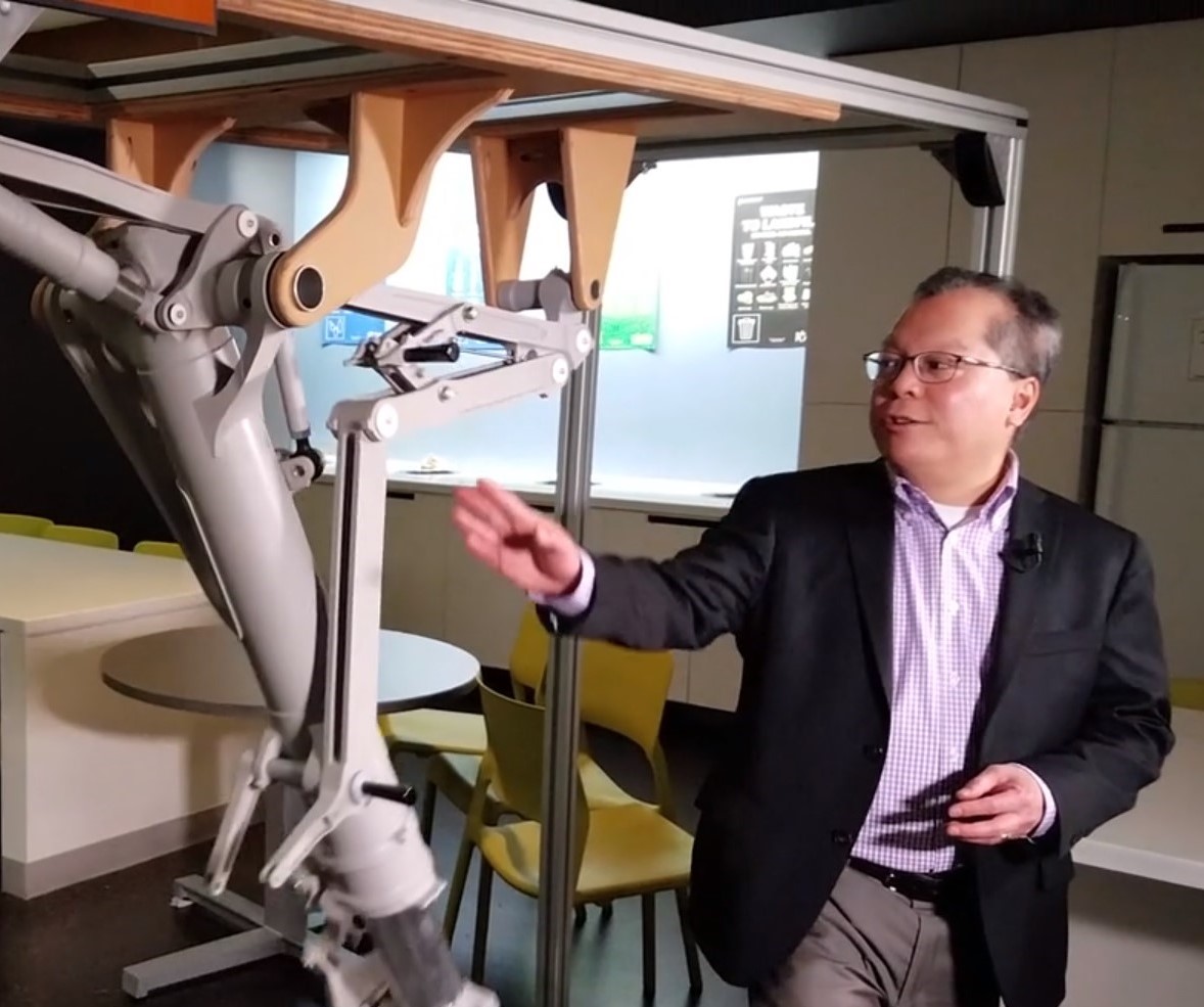

The nose gear on the Max is 8" longer, and even that caused a reworking of the forward avionics bay. Going bigger still would have meant relocating the entire bay IIRC.
There were further issues with the nose-gear for the Max 10, and that's another case of Boeing going for a more complex design to avoid introducing a different type rating.

And that was only to make for the rotation of the longer MAX-10, so imagine if they had to make enough room under the wings to place the engines nacelles so that they don't cause pitch up when we don't want to.

Ironically for Boeing, the extra 9 inches ( ca 23 cm) ground clearance added by the new extending u/c could have been substituted for the upwards-and-forwards repositioning of the MAX engines in the first place, negating the need for MCAS. If all MAX models had had this u/c from Day One, the whole MCAS fiasco would never have happened! As it is, the MAX 10 must fly with a complicated and expensive millstone round its neck that it really does not need.
