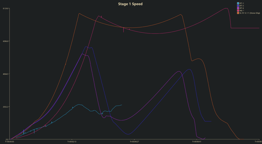

Comparison of speed vs time of New Glenn vs current F9 ASDS vs Starship
We can see that the separation speed is roughly comparable to the Falcon 9 despite a larger S1/S2 mass ratio (5-6 vs 3.5-4), there are probably lots of margins and room for improvement,, with less margin for landing or uprated BE-4.
The deceleration implies that the start of the reentry burn had a good thrust and relatively good orientation.
