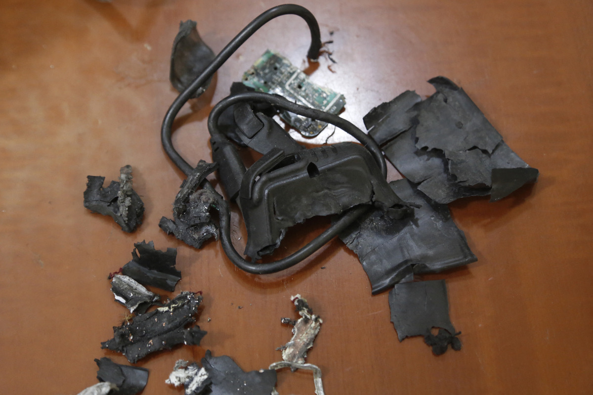

Something that needs to be kept in mind is that Mossad tampered with literally thousands of pagers and walkie-talkies, even with the best electronics design and top notch manufacturing methods you will always get a few duds.
Something that needs to be kept in mind is that Mossad tampered with literally thousands of pagers and walkie-talkies, even with the best electronics, design, top notch manufacturing methods you will always get a few duds.
Granted, and with ~5000 pagers alone I'd expect ~50 duds at least.
Has anyone said how many walkie-talkies went boom?

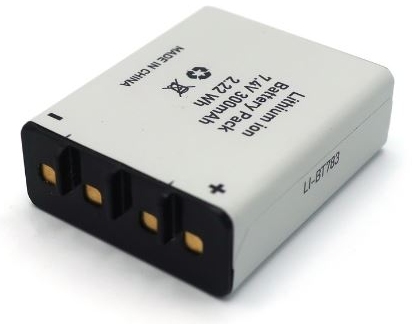

The AR-924 has a soft power switch button just like smartphones. It means that the main board was basically always powered, and the on-board clock was always running. These pagers either had a hidden feature embedded in the software that turned the detonator on upon the reception of a certain coded signal over the pager's receiver circuitry, or the pagers were fitted with an independent low power radio receiver connected to the detonator that was always listening for triggering signal. That is more likely given the reports that even the unboxed pagers also exploded on September, 17th.
Could it be that both design options were used for redundancy purposes?
This mystery person is almost certainly a Mossad agent.
I would fully expect that they were.
That said, the more complicated you make the detonator, the more likely it fails to go boom.
Plus, the legendary comment about how
1) If you want the ordnance to absolutely always go boom when in receipt of a valid command signal, we can do that.
2) If you want the ordnance to absolutely never go boom when not in receipt of a valid command signal, we can do that, too.
But if you want both, we need to talk.
Option 1 has a high accidental detonation rate.
Option 2 has a high dud rate.
Ca. 450 [walkie-talkies] according to the Cryptomuseum analysis.
So I'd expect at least 5 of those to fail to go boom. 50 failing to go boom would be way too high. 1% dud rate is expected, 10% is way too high.
