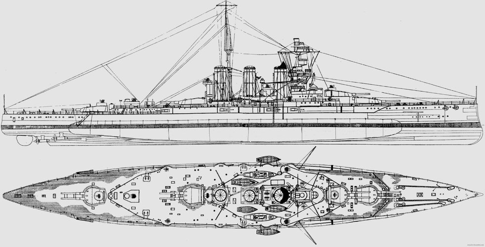

I do not recall exactly the thinking process behind the Tiger, but the general idea was for her to be an improved "Queen Mary" class, because funds were limited, and she was ordered only under condition that her cost would not exceed the "Queen Mary"'s. So the scale of redesign was limited. Moving the Q turret to rear would require a massive redesign, including weight distribution along the hull, so it was likely out of question.
One thing I keep thinking about is the height of the catapult at that level; or rather the lack of; from old footache I have seen in some documentaries, the biplane dips a bit before gaining altitude when pushed off the ramp....The X turret location doesn't give a whole lot of leeway for errors or wind instability....It also probably is why they always tried to install the catapult in the higher turrets; The newer generation U.S and British warships had higher freeboards that allowed high enough catapults installations. This is a thought, and not an affirmation though....
Machinery. They need a lot of space for machinery.
Precisely this. Queen Mary had Q turret between boiler rooms, Tiger had Q turret aft of the boiler rooms and the aft funnel to give it a clear arc of fire.
Moving Q turret even further aft would have necessitated moving engine rooms, which would have needed even more redesign and time, cost than was deemed acceptable.

The obvious opportunity with Tiger is her machinery, replacement as in the reconstructed QE class would save significant space and weight that could be allocated to other things. Tiger ran trials at 29 knots at 104,635 SHP but was pushing the limit of her hydrodynamic potential. Based on the machinery weight figures given by Friedman (which aren't even consistent between different parts of the book) for the Queen Elizabeth pre and post reconstruction, 1,500-2,000 tons could have been saved on Tiger before considering the reduced oil and coal stowage due to reduced consumption.
The space savings would provide magazine capacity and might, I'll let other do precise measurements, provide a solution to aircraft arrangements. Reducing the length of the boiler rooms and trunking the funnels could provide space for a cross-deck catapult between the new aft funnel (roughly where the middle funnel was originally) and the first aft 13.5" turret. Hangars could be placed either side of the funnels as in the QE reconstructions. This is certainly not ideal, the aviation facilities could be unusable whilst the main arament is firing, especially if the aft turrets are trains forward, and restrictions on firing arcs/elevations may have been necessary to protect the capapult form blast.
I find secondary armament more challenging but think the best option would be to mount four twin 4.5" BD turrets either side of the new hangars, for a total of eight. HACS could be mounted on the new forward superstructure and on the rear of the new hangars, for a total of four.
Eight 4.5" twin mounts is obviously less than the QE's ten but I suspect that every possible ton would be wanted to improve protection.
Main armament is interesting, the 14" option is superficially attractive but would be a major additional cost and the turrets would be a custom job. It would entail removing all the shell and cordite handling equipment (hoists etc.) and starting afresh within the constraints of the existing barbette and hull structure. The only other option would be a radical modernisation of the 13.5" turrets akin to what was done to the turrets used on Vanguard. The question might be how much more work would it be to produce a 14" solution for Tiger versus the reconstruction of the 15" turrets for Vanguard (e.g. would any reuse be possible)? That is probably not answerable by anyone on the forum.

Hi; so, I used the schematics of the Tiger circa 1928 and I applied what I would do if the ship ad been more prioritized during the twenties bu the admiralty; it resembles somewhat the work done on the HMS Barham. I voluntarily left the X turret for you guys to decide whether or not a catapult is warranted; take note that no hangar is possible on this; the reason being is I checked the blueprints of the ship, and from what I could see (not that clear) is there is a ''dome'' 1 inch plate running over the turbines and generator in the area where it seems the long quarter deck space is empty; at the beginnng of the ''triangle'' shape; something could be installed, but it would hamper the main turret's canons arc. The Barham didn't have the hangar either by the way......The Plane was covered with a tarp attached to some anchors.
What I did put on is the torpedo bulges ( sorry for the inexactitude of the drawing's corrections) the AAs', inluding 3 pom-pom 2 pounders, 4 quad .5, 6 single .5 ( more could be installed) 4 QF4.5/45 twin cannons; I remove the torpedo tubes, 4 6in. canons and 4 3in. old singles. I would put 4 in. plating on the quarter deck (most of it), and some on the forecastle and rear main deck. Engines would not be changed ( can't be done unless major work is done) but I would convert to oil only and look for efficiencies with that fuel; I would be looking for about 5% which is achievable.
There.s an small extension on the foretop with inclined guardrails for the wind resistance and gusts. Also, a deflector is put on the first stack to keep the smoke aloft the bridge structure. Some AAs' are on new platforms, some are extension of searchlight platforms.
You can download the image since it is hgh resolution and will allow you to erase and make your modifications...
Have fun:)
