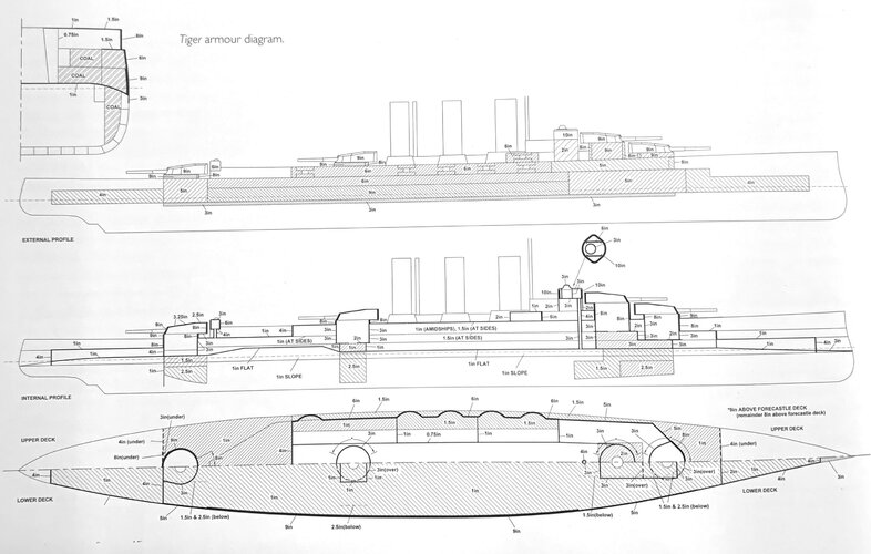

This depend on the scale of refit. My proposal:
* No changes in main guns (just supercharges to gave enough range)
* New boilers (installed in 1930s under pretext of "providing modern training experience") to gave 28-30 knots for the half amount of boilers
* Additonal armor over machines and magazines (would not require much time if it would be put on main deck)
* Bulges (installed during refit)
* New fire control system
* New AA set (the Revenge-class one, i.e. four dual AA mounts and two octuple Pom-Pom's)
* Catapult for scout plane
In compairson with what Hood required, such refit would be very compact.

Well, battlecruiser is not as heavily invested in armor as battleship. And - most importantly - restored Tiger would still be pretty reasonably fast for 1940s.
I don't see how the works proposed justify a training ship, especially if the number of boilers is being increased.
Increased - not) But the new boilers could be installed under pretense of training the mechanics crews on up-to-date equipment. And, well, the progress in boilers by 1930s was so great, that the much smaller number of much more compact boilers could be used to produce the required power for max speed. Yes, it's playing around of treaty - it required training ships to be reduced in number of boilers to sufficient to provide 18 knots speed - but it actually did not forbade replacement the remaining boilers with high-capacity ones. And if the training ship in question did not move faster than 18 knots, it would be pretty hard for anyone to prove that re-boilering gave her previous speed back.
So my idea is to replace the remaining boilers on Tiger by mid-1930s, leaving the same FORMAL number - but with greater efficiency.

Yes:) I got that; but my main concern up to that point is the weght; it's ok to add on a BB, but if you want to retain the speed on a battlecruiser, saving weight when adding is a priority; as demonstrated in late 39' with the Hood, when they removed the old 4 inches on the deck and replaced them with the QF4.5-45 duals, and added two more octoples and 3 more quad AAs', the ship was low in the water and had lost 3 knots; it also included some armed plating on the deck. So, the only way to bring the ship back to its usual draft was to remove something; and that something came in the way of the deletion of all of the 6 inches.
If some plate in was to be added on the Tiger, there would necessarily have to be some form of weight offset; when adding the weight of the AA logisticals like fire controls and munition depots, weight climbs quickly; changing the 6 in. for the QF4.5-45 in itself actually would save some weight and allow high angle firing, something the 6 in. can't do.
So, bulges slow the ship
Added plating on deck and turrets ( they badly needed that) adds weight and slows the ship
Added AA adds weight and slows the ship.
Removing the 6 in. reduces weight by a lot ( considering all the barbettes and logistics)
New boilers, oil only saves some weight and adds operations distance capability along wih a bit more power.
Adding the QF4.5-45 adds some weight, though much less than the weight than the 6 in. because of lighter logistical systems and installation ( only a good thickess deck needed)
The end result could have been a ship better equiped and as fast, if not a bit faster....

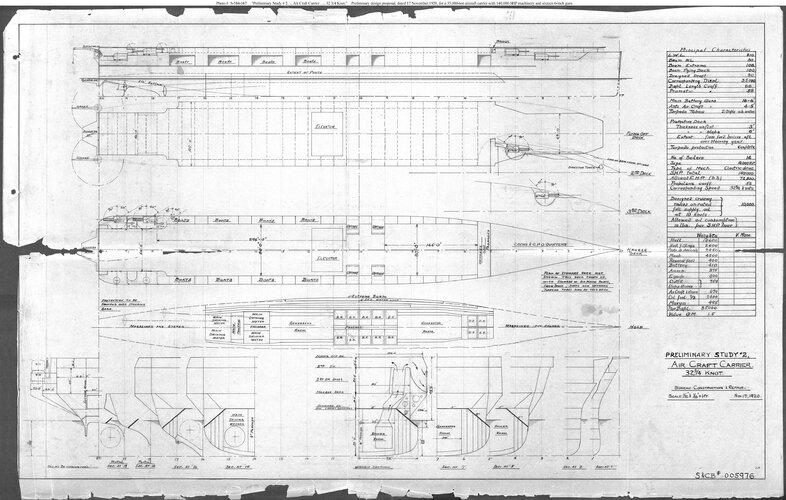

The USN had even been looking for alternate ways to use the incomplete hulls of the Lexington class before the Washington Conference convened.
For example:
In 1919 the USN's Bureau of Construction and Repair produced a Preliminary Design which used the then-current CC design (the 35,000 ton, 35-knot version) as the basis for a fast carrier; the carrier would work out as (roughly) 29,000 tons.
In 1920-21, the prospects for a purpose built carrier design ran the gamut, but the high end was a 35,900 ton, 35-knot ship that was so close to the dimensions of the then-current CC design (the 43,000 ton) that the General Board suggested converting one or more as an economy measure (again, before the conference started). There are photos of the 1921 design models on page 42 of Friedman; Design A was a flush-decker, 35,000 tons, without an island; Design B was 39,000 tons, based on the hull of the CC Ranger, with an island.
The Washington conference was called in July 1921, to meet in November 1921 - in response Preliminary Design produced a conversion design of the 43,000-ton CC hull on July 25, 1921, and the rest, so to speak, was history - including the conversions authorized by Congress once Harding's Asst. Sec. Nav. Theodore Roosevelt Jr., had suggested the 36,000 ton exemption for carrier conversions (yes, the ex-President's son held his father's old position!).
The above-mentioned 'Design "B"' (note the handwritten date on the bottom-center line of the drawing and in the "notes" section in the lower right):
Just as an aside, the 35,000 ton S-584-167 design actually made it into the USN's budgets, with 4 authorized (3 in 1920 and 1 in 1921)... but were canceled shortly thereafter:

So, here's mytheoretical story and mods for the Tiger....
The Tiger actually was saved by the RN; that much is true, since they managed to keep it right up to the beginning of the thirties before time ran out on them; so, how did they achieve that; they justified keeping it to replace the Hood which was going to be dry docked for several repairs and refit during the 20's it actually replaced the Hood as the admirals ship for two years. So, in keeping with that line of thought, it could be said that the retaining of the Tiger was to replace the QEs' while they were reconstructed. It is somewhat of a stretch in argument but it could have been swallowed. During that time, torpedo bulges would be installed and torpedoes and their infrastructures removed; a bit more drag created, but weight removed; the machinery changed to more efficient oil-only boilers of a lighter weight would bring back the speed, or a bit more and save some extra weight. Next, the main belt thickened to 10 in. and extended up to the outermost barbettes, adding weight which would be offset by removing the 4 in bow plating and reducing the stern to 2 in.; (compromises) the final weight of the hull plating added would be minimal. For the deck protection, an extra 3 in. plating for the upper deck and main deck up to and around the barbettes. Next, the turret sides would now be 11 in. while their top would be 6 in.; the barbettes would now be 11 in. ( part which is above the deck), along with the conning tower. This added weight would be offset by the removal of 4 of the 6 in. secondary armement along with their barbettes and loading structures. Replacing this would be 4 of the much lighter and easy to install twin QF high angle 4.5/45 in and 3 octople 2 pdr pom-poms plus 4 .5 in. quads; to finish with AA armament, 10 single .5 in. spread between the front mastand the decks. New gen HA director controls on foretop and on the rear structure would complete the light refit.....
The final result would be a ship capable of 28 to 30 knots, the same operational range, and a beeter fast escort for aircraft carriers or other duties not involving primary combat........
Let me know what you think:)
Erm, I'm afraid it's a VERY big stretch. The Washington Treaty put no difference between active and inactive capital ships; any non-demilitarized capital ship counted (even if it was mothballed). So no, "replacement for refit" argument would not work at all.
It was done within the Washington Treaty limits. Basically RN removed Hood from active fleet for refit, and returned Tiger from training ship role to fill the niche in battlecruiser division (which was supposed to have three ships). As I mentioned - Washington Treaty put no difference between active and inactive capital ships.
First of all, it's not allowed. Washington Treaty specifically stated that alterations of vertical armor (i.e. belts) are NOT allowed for Britain, USA and Japan. France and Italy have more freedom here.
True, the Repulse and Renown main belts were replaced. But works on them already started by the time Washington Treaty was signed, and they were specifically mentioned as exception because of that.
Secondly, changing the 9-inch belt to 10-inch one would be a massive costly undertaking - and would provide very little in terms of actual benefits. While on Repulse and Renown the replacement of 6-inch belt to 9-inch one provided 1/3 thickness increase, in your case it would be just 1/9. Not enough capabilities improvement to validate the MASSIVE cost of new plates.
Again; no alteration in vertical armor was allowed for Britain, US and Japan. Not to mention that increasing side armor while the face armor remains 9-inch seems to be a pretty strange solution.
There was no barbettes for secondary armament of Tiger; her 6-inch secondaries were in casemates, manually-loaded.
