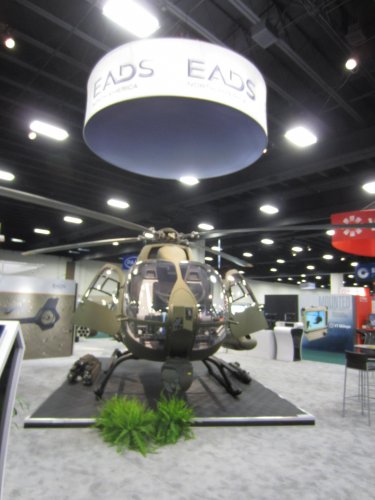

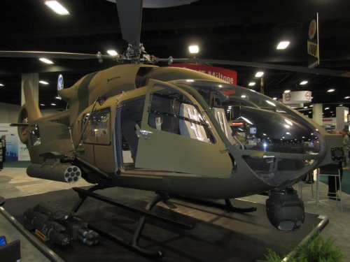

EADS North America/Eurocopter AAS-72X+ on display at Quad A.
https://www.facebook.com/photo.php?fbid=10151518712035528&set=pb.80119815527.-2207520000.1366408390.&type=3&theater

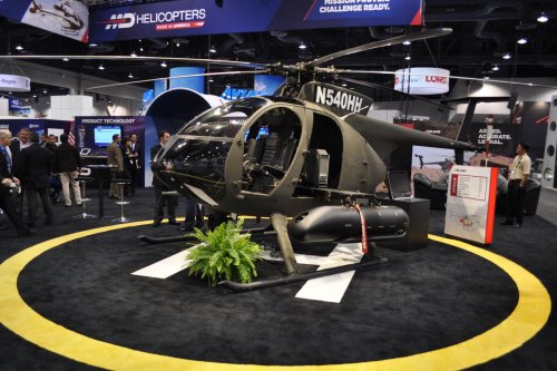

MD Helicopter MD 540F on display at Quad A.

Jgreat pictures Triton thanks

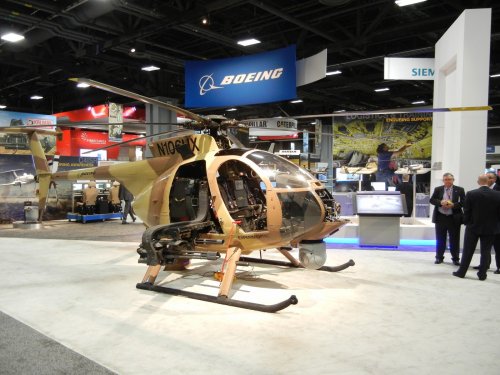

Boeing AH-6 on display at AUSA 2012.

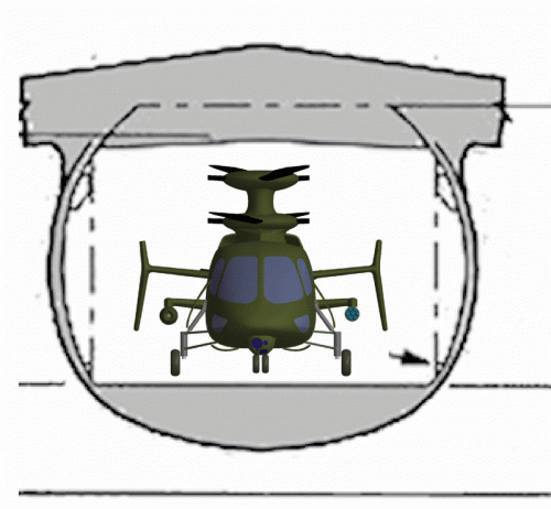

Guys, please... When you reply you can quote just the last sentence. Do NOT leave the whole thread of discussion in your quote. Thanks!
Biggest challenge I think for X-2 technology for USN use will be its height. Not sure it will fit in the small hangars on the DDG.
Triton said:
Won't mast height also be an issue with air transport?
Sikorsky claims they'll be able to pack four S-97s in a C-17, but are not specific how much disassembly will be required. Does anyone know the overall height of the S-97 gear down and gear up? Those numbers don't show up in the specs or illustrations.

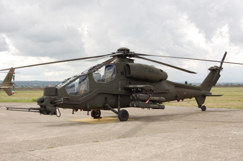

I've always advocated that the US Army for the $7 billion dollar's they waisted on the LHX program in return for nothing. It would have been better of adopting the Agusta A 129 Mangusta International (with five-bladed rotor, M197 gun in a customized nose turret, support for Hellfire and Stinger missiles, advanced avionics equipment and two LHTEC T800 turboshafts) and it's light battlefield helicopter variant - the A 129 LBH. Not would have it been $billion's cheaper, it would have meet the compatibility requirements of the combat scout and light transport requirements of LHX, as well as it being in operational service more than a decade ago!!
The only stumbling blocks I could see with the adoption of the Agusta A 129 derivatives in US Army service:
1/ The arrogance and ignorance of Buy American Only lobby within Congress and U.S. defence industry
2/ There is no doubt in my mind that the US Army would have taken this cost effective and workable proposal of the A 129/A 129 LBH and tried to reinvent the wheel , added stupendous and unreasonable modifications, added crazy amounts of sensors and weapon systems, re-engine it ............
Regards
Pioneer

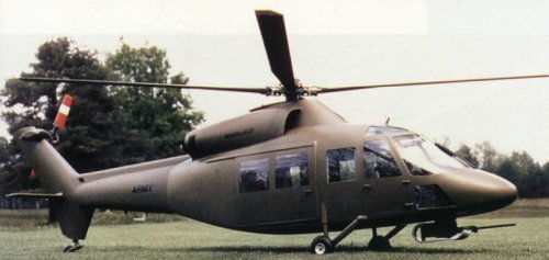

  • Mock-up of Agusta A129 LBH or (A139) transport variant of the A129 Mangusta.jpg

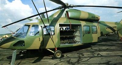

  • Mock-up of Agusta A129 LBH (Light Battlefield Helicopter) variant of the A129 Mangusta.jpg

Oh did I add, that the A 129 (in it's Scorpion model to the Australian Army's AIR 87 competition) can be readily deployed by Lockheed C130 Hercules with very quick turn-around. Preparation time for embarkation is just three hours and it can be readied for operations at the other end in less than four hours. It is also marinised (salt water protected) for prolonged ship-board deployments. This only would have added to the flexibility and deployable aspects of the Mangusta in the LHX requirement. Freeing up strategic assets like Lockheed C-5 Galaxy's and McDonnell Douglas (Boeing) C-17A's
Regards
Pioneer

Actually the only Russian "attack " helicopter that carries troops is the MI-24/MI-35. The closest Western comparison would be with the stillborn AH-3/S-67. Mi-28 and KA-52 are two seaters, the latter having side-by-side seating as apparently will FVL- Medium attack.
The Mi-28 is now quite famous for it's compartment. This has been known for sometime. The compartment fits three troops however cramped. Three is good number if someone needs to be rescued.
http://www.militaryphotos.net/forums/showthread.php?99988-Russian-Photos-(updated-on-regular-basis)/page3135
Cdrs want observers placed on high ground and not to use a Blackhawk size craft to accomplish that task regardless of the type of conflict.
A combined scout/atk may be an option but using a lifter for attack and scout is a bad idea. A armed FVL size should be considered some sort of standoff gunship as it would not suited for the close fight for multiple reasons.
The Mi-28 is not well suited for fast roping etc. so a projected Scout/Atk must be able to quickly & safely deliver and recover a sniper/observer tm to an urban rooftop .
Ok, the Sikorsky X-2 AAS looks impressive. Contension would that a clean stealth AAS (troop carrying)/ Atk (internally stowed msls) would still be faster, stealthier and more capable in close including possibly even air to air fight. . Whoopee for passengers in a dogfight.
Unless I am missing the point here, the S-97 is capable of carrying six troops inside the aircraft.
The x2 attack modified to attack/scout capable of carrying 2 troops might be a more better.
Six troops is great but can that maneuver, evade..etc.
