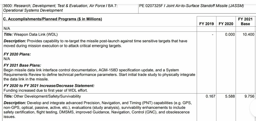

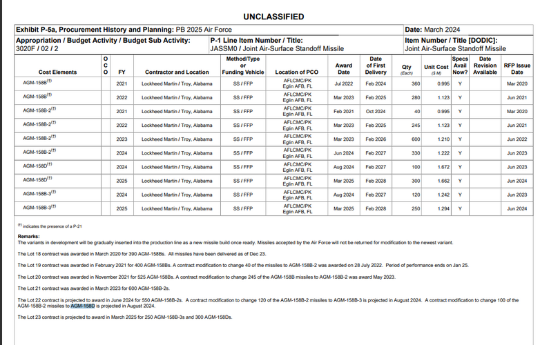

AGM-158D is being procured this year as part of the lot 22 JASSM buy.
AGM-158B-3 is also apparently a thing that is going to be procured in 2025, with the D model outnumbering orders of the B model.
I believe this is one of the only documents that really discusses it at all, it's from the FY22 budget.Do we know what capabilities the D version has explicitly?

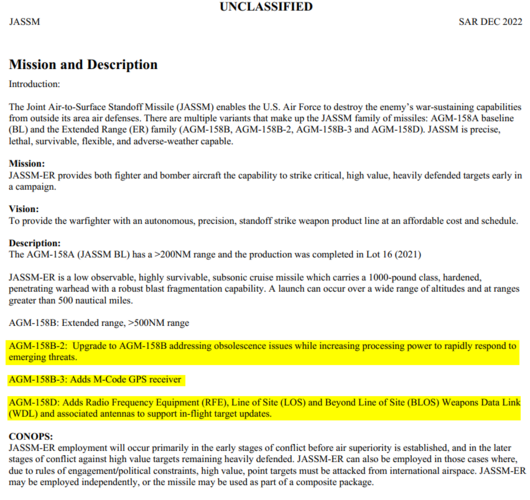

158B-2 I *think* has a revised shape for longer range and the M-code GPS (I presume SABR or something similar).
But that's still your personal guess, right? Is there any piece of government source documentation or manufacturer documentation which mentions either B-3 or D variant in any sort of detail?
B-2 range extension over B-1 is usually described as being considerable, though. from 1000 km to 1900 km.
But, truthfully, all the sources listing such a range are not really quality sources.
When you mention that B-2 has a moderate range extension, you mean to imply that actual range increase of B-2 variant over B-1 variant is not, in fact 900 km but (much) less?
There were rumors of an “extreme range”/XR version that was a stretched fuselage. I’ve seen no credible sources for such a development nor any reports since a couple years ago. B2 has been characterized as having a longer range but no description of that range increase has been printed in what I would consider a credible source. We do know that it has the same engine and largely keeps the same form factor, so barring a major decrease in warhead, it is my opinion that any range increase is quite modest.
I went looking to see what the differences were yesterday. At first I was excited about the range increase but then it turns out there probably isn't one.Yep, this is the problem. There are several mentions of JASSM XR becoming AGM-158D and then -158B2. But those talk about a dramatic stretch (nearly double the weight) with increases in both warhead weight and range. It is obvious this is not the missile that is actually being built now as -158B2, so something changed but the program is very opaque about what and when.
