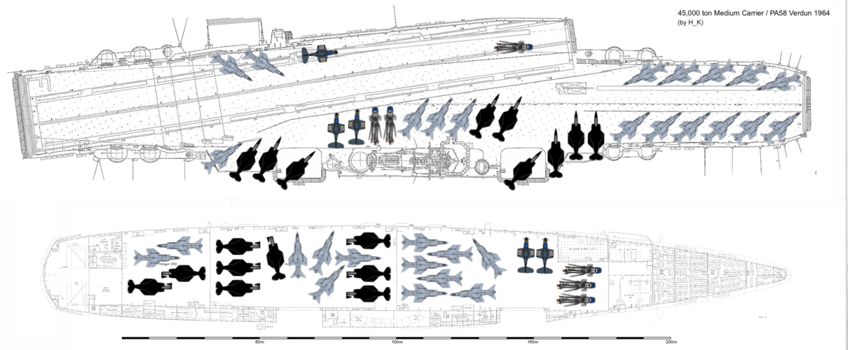

how wide and long is the hangar of 58?
The images are in Shipbucket scale (2 pixels = 1 ft).
PA58's hangar was nominally 200m x 28.5m (vs. 180m x 24m for Clemenceau). However on Clemenceau this length included some engine and weapons workshops, with the effective hangar length being 134m. The hangar also narrowed by 2m towards the ends.
Most likely the same was true on PA58, so I estimated effective hangar length at 158m (as PA58 is 24m longer than Clemenceau). I also assumed a small 18m extension forward where the centerline lift used to be - this could be used for helicopters, boats and pallets.
All in all, flight deck and hangar sizes are very similar to the Essex class. I estimate maximum density spotting of 58 F-4B Phantoms (27 in the hangar and 31 on the flight deck), which with the standard USN density factor of 75% implies a max air group of 44 F-4Bs.
Operationally that gives me an air wing of:
- 36 large fast jets (e.g. 18 F-4s + 18 Buccaneers)
- Or 50 small jets (F-8/Super Tiger)
- Or a mix of large & small jets (e.g. 25 F-8s + 18 Buccaneers)
- 5 Gannet AEW/COD
- 6 Wessex/Sea King ASW/plane guard helos
- 5 Gannet AEW/COD
Globalsecurity has 152m usable length for the hangar btw.

Now here's my 45,000 ton carrier with a mixed airgroup of 48 jets... using the usual USN 75% spotting density factor. It's a little tight as the Buccaneer takes up more space than I expected, but otherwise looks good.
30x F-8 Crusaders (could be replaced 1:1 with Super Tigers)
18x Buccaneers
5x Gannet AEW/COD
6x Sea King ASW/plane guard

Oh that works!
What is really cool is how it can be compared with the Clems own air group.
- many more Crusaders
- Buccs versus S.E as the attack wing
- Gannet & Alizé were quiet similar
- ASW helicopters: Sea King vs a mix of Super Frelon (too big) or Lynx
To provide the 64 long-range strike platforms needed in a TAU, you would at 18 per CV need 4 on station at the same time......
Conversely needing only 32 fighters and 8 AEW, just 2 such CVs would be needed.
However....
Assuming said fighters are just F8 Crusaders or Super Tigres implies a standard CAP of 2 hours and consequently you'd need to double the fighter component to 64 aircraft......
And so you can see why this might not meet RN perceived needs.
