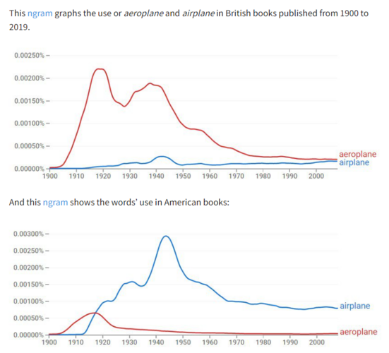

Interestingly Aeroplane has declined much greater than airplane has increased so I would presume aircraft has taken up the mantle or some other terminology.

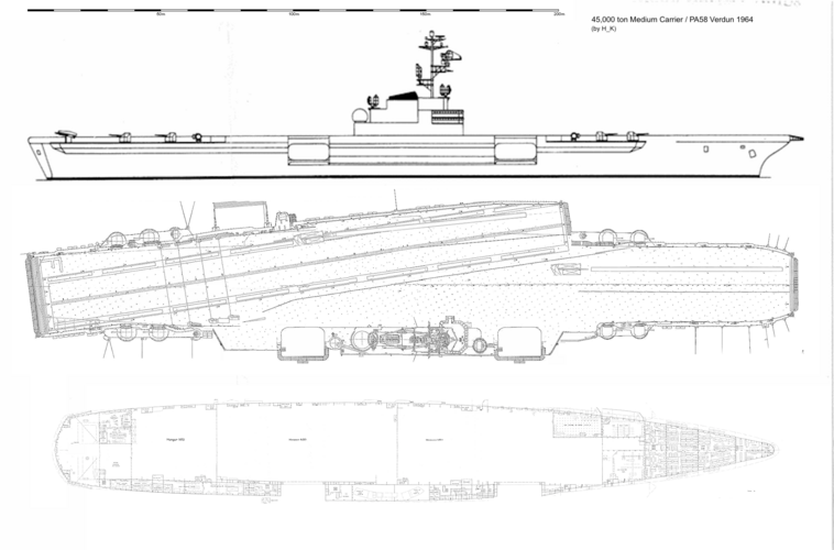

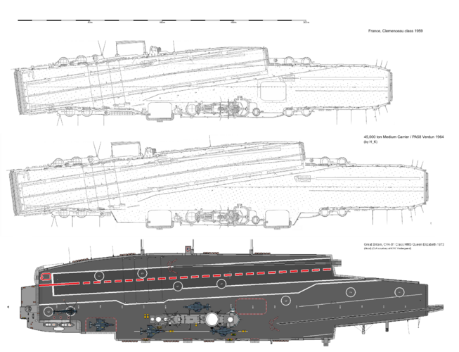

While you guys have been debating fighters, I've been working on my 45,000 ton medium carrier proposal. ;)
Starting point is the PA58 design. I've drawn it in detail by upscaling the Clemenceau plans (as that's basically what PA58 was), adding the longer 199ft BS5a catapults used on Eagle/Ark Royal. This is not meant to imply that the RN would buy PA58, just meant to illustrate what a 45,000ton RN carrier might look like.
Also including a side-by-side comparison vs. Clemenceau and CVA-01.
Next up... going to add the air group!

something that would be interesting in particular to PA58 as a side note: France ran at a higher steam pressure than British ships. The first three CVA19 Hancock class ships used British BUILT cats, so one would think they are essentially British cats designed to take American pressures and thus had better throw weight. I want to say that the Clem's ran at 600 PSI like the Hancock but am NOT certain on that.. but the point remains that these cats could have some extra "OOOMPH"
Also in case the board messes with the scale.. how wide and long is the hangar of 58?

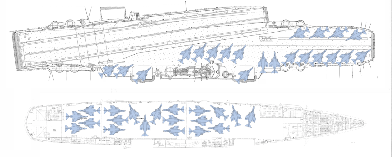

The images are in Shipbucket scale (2 pixels = 1 ft).
PA58's hangar was nominally 200m x 28.5m (vs. 180m x 24m for Clemenceau). However on Clemenceau this length included some engine and weapons workshops, with the effective hangar length being 134m. The hangar also narrowed by 2m towards the ends.
Most likely the same was true on PA58, so I estimated effective hangar length at 158m (as PA58 is 24m longer than Clemenceau). I also assumed a small 18m extension forward where the centerline lift used to be - this could be used for helicopters, boats and pallets.
All in all, flight deck and hangar sizes are very similar to the Essex class. I estimate maximum density spotting of 58 F-4B Phantoms (27 in the hangar and 31 on the flight deck), which with the standard USN density factor of 75% implies a max air group of 44 F-4Bs.
Operationally that gives me an air wing of:
- 36 large fast jets (e.g. 18 F-4s + 18 Buccaneers)
- Or 50 small jets (F-8/Super Tiger)
- Or a mix of large & small jets (e.g. 25 F-8s + 18 Buccaneers)
- 5 Gannet AEW/COD
- 6 Wessex/Sea King ASW/plane guard helos
