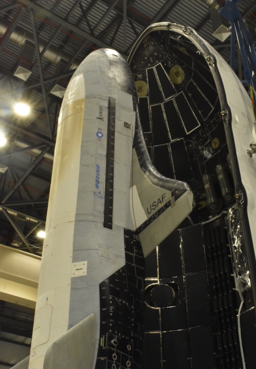

Anyways, the X-37 needs to have its payload bay open and its solar array deployed. These are not meant for repeat operations on orbit. it can only operate for a limited time with payload bay closed.
