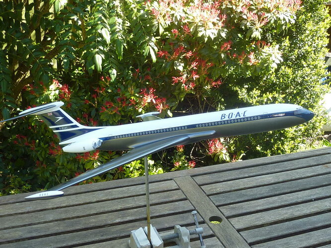

On another note, that's the 2nd picture of a VC10 you've posted with wingtip tanks. I was under the impression that the Super 200 would have been just like the Super but 15' longer and that tip tanks were a further development. Have I been labouring under a misapprehension?
Yes Rule of Cool, the Super VC10 200 was designed with tip tanks to guarantee a transatlantic range for BOAC, otherwise it was so big that it wouldn't have been able to guarantee year round transatlantic operations from London. To me, this implies a marginal performance, which is perhaps why BOAC preferred the smaller Super VC10 to match the 707 & DC-8 range wise. All the imagery I have of the Super VC10 200 variants show tip-tanks.

Rule of Cool, this version of the Super VC10 200 (which I believe was called the VC10 Super 212) even had extra fuel tanks on forward extensions of the wing-root fairings. I believe this was the specific version submitted to Pan American World Airways Inc. in 1960.
