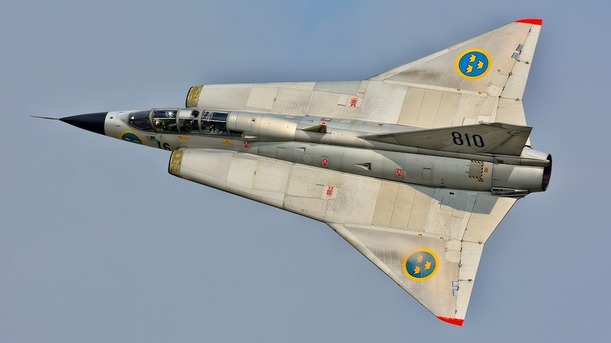

I am beginning to think I am flogging a dead horse, as it is a common mistake.
It is Draken, with one K :(
Have mercy.
Draken-Drakkar
Have mercy.
Thanks
Well the Draken or Dragon have a very nice wing very modern for a very old aircraft

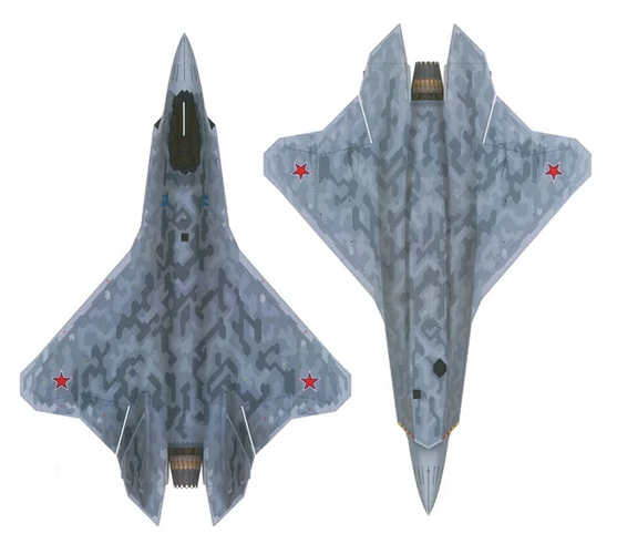

The J-35 has a compound delta like F-16XL and it seems Su-75 will have the same basic concept, not the same wing.
Compound deltas were designed to fix the low speed faults of delta wings, specially tailess delta wings.
Modern fighters want dymond type wings, but they want increased area, some designs are going for tailess wings and Draken already had the same needs a tailess delta, well compound delta wings.
So there is a convergence in needs a tailess wing, is good for stealth and low drag, but it is bad for controllability.

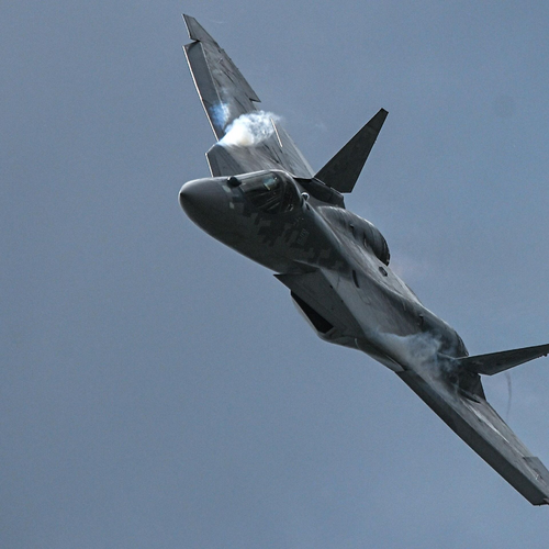

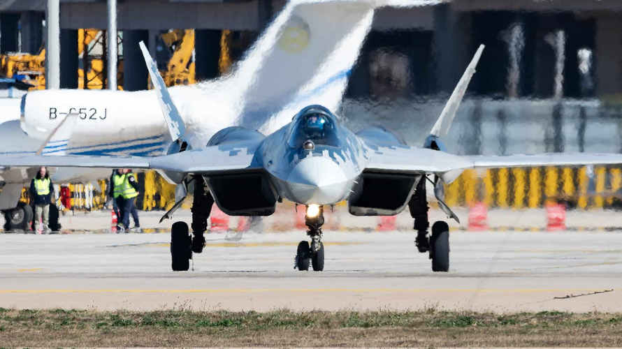

Take the Su-57 without TVC nozzles and those tiny vertical stabilizers will show it how clumsy it is, same F-22.

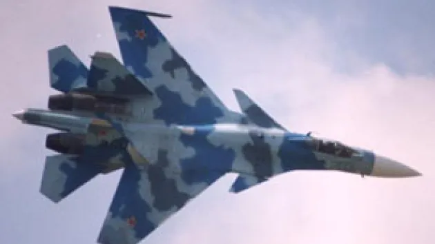

Su-27M had many aerodynamic control surfaces, even without TVC nozzles could outmaneuvered even most 1990s fighters.

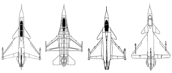

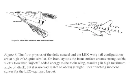

I believe the cranked arrow Delta wing of planes like F-16XL and Canard delta will be dominant in future Fighter designs
I'm leaning more towards either 3-surface or canards than cranked deltas.
like i said the aerodynamic and wing form depends what aircraft purpose is
canards are ideal for dog fight like Rafale
cranked deltas ideal for multi combat aircraft like F-16XL

Each aerodynamic configuration has advantages and disadvantages.
Turn rates are a relation of lift and thrust, the more lift a better ITR the better Thrust higher STR.
Regardless an aircraft has canards or LEX or Levcons the most important is lift and thrust.
To go for canards is because tailess deltas use the canards for vortex lift and control surface.
There are many reasons why to use canards but canards per say are not a synonym of superiority.
A design configuration has to consider materials, speed, altitude, AoA and then the wing can be chosen.
Deltas use canards because deltas are not good at low speeds and lose lift at STRs.
LEX are fixed and can not be used as control surfaces as canards are used, however this has not been proven a bad feature since Su-27 can do the cobra using horizontal stabilizers

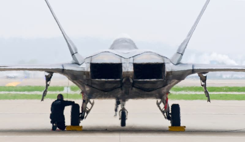

These pictures show the horizontal stabilizer is well hidden by the wing on F-22 on a frontal and a rear view
The canard on J-20 never achieved that planform alignment
Su-57 follows the same rule and adds a LEVCON adding the same a canard does but perfectly aligned to the wing

The Su-35/Su-27M was an example of this, the canard increase lift and added some controlability to the lift by deflecting at high AoA and shedding vortices with some degree of control as a LEVCON will do.
Su-57 is the perfection of Su-37/Su-30MS by deleting ventral fins (which help at high AoA) and reducing drag and radar signature with the LEVCON and TCV nozzles by reducing the size of the vertical stabilizers and eliminating the canard
Bigger canards means smaller deflections and also helps with radar absorption.
Small canards like on the advanced Flankers were only done to fix a CG issue.
The canards on the Su-30 to Su-37 did indeed fix CG issues true but they also they add vortex control since they are deflected, on F-18E has larger a LERX than F-18A/C to fix CG issues but they can not be deflected since they are fixed LEX.

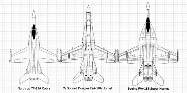

The F-18 for example having a large LEX generate vortex lift and it can use a wing with less leading edge wing swept.
Th advantage of Gripen versus F-18 is the canard is not fixed it can be deflected so it is a pitch control device doing what in the F-18 the horizontal stabilizer does. But the wing on the F-18 has less swept and can achieve less lift lost at STR.

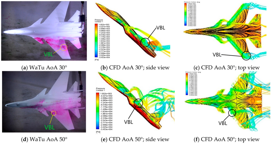

The maneuverability of the Sukhoi Su-30 at very high angles of attack (AoA) was remarkably appealing. Canard angle, in cooperation with aircraft wing, created a flow pattern whereby, in that position, the fighter still had as much lifting force as possible in order not to stall. The behavior of changing canard angle configuration played an essential role in creating the strong vortex core so that it could delay the stall. The study of vortex dynamics at canard deflection angle gave an essential function in revealing the stall delay phenomenon. In this study, one could analyze the flow patterns and vortex dynamics ability of the Sukhoi Su-30-like model to delay stall due to the influence of canard deflection. The used of water tunnel facilities and computational fluid dynamics (CFD) based on Q-criterion has obtained clear and detailed visualization and aerodynamics data in revealing the phenomenon of vortex dynamics. It was found that between 30° and 40° canard deflection configurations, Sukhoi Su-30-like was able to produce the most robust flow interaction from the canard to the main wing. It was clearly seen that the vortex merging formation above the fighter heads was clearly visible capable of delaying stall until AoA 80°.
Adding a forewing to an aircraft such as LEX and canard will produce a strong vortex that will interact and affect flow over the main wing [17]. This influence will be used to modify the flow so that the aircraft has better flight performance. When the flow above the wing has begun to experience turbulence, the vortex core from the forewing will hit the flow above the wing and make it re-streamline. Forewing configuration will affect changes in vortex structure that occur. Canard has a more flexible configuration due to the ability to adjust the deflection angle.
Several previous researchers have observed many fuselage effects on the types of straight type aircraft body models, such as Chengdu, X-31, and F-18. On the other hand, the fuselage on a curved aircraft body model of the Sukhoi Su-30MKI has admirable maneuverability in high attack angle conditions. Sukhoi Su-30MKI has a unique canard wing configuration, adding the canard in the same height and near the main wing, while most other aircraft use a canard configuration above and in front of the main wing. This high agility allows the aircraft to release weapons in all directions, due to the dynamics of vortices formed on the canard, wings, and body of the aircraft. Therefore, analyzing the occurrence of vortex dynamics becomes a crucial factor indicating lift force at a high attack angle of attack. Thus, flow visualization method is an effective way of determining the phenomenon of vortex dynamics.

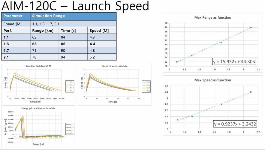

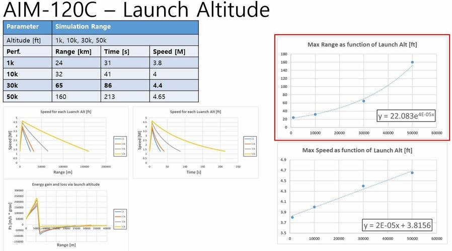

it seem like due to the creation of HOBS missile and TVC, the need for low speed STR is eliminated, so swing wing and straight wing become redundance. Most fighter seem to emphasize high speed capability
Yet few aircraft managed to reach significant part of high speed performance envelope that was here in 1960s, in 3rd gen. And you can almost see how 4th gen aircraft, through their sub generations, became overall slower.
F-35 isn't a reversal because of stealth here, it continued the trend that was already in place. Partially because it's a strike fighter of course, but so were, in all honesty, its predecessors. It is just built for the job.

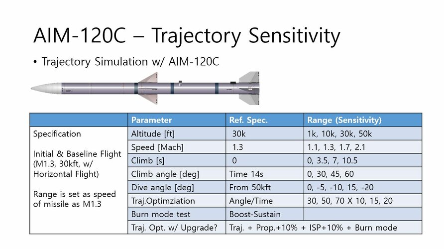

I think it mainly has to do with the fact that launch speed has negligible impact on missile range and average speed compared to launch altitude

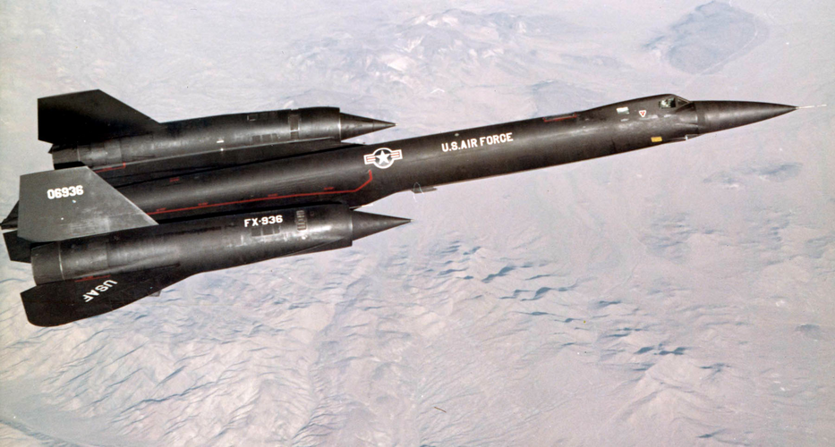

YF-12 is huge for a fighter, yes it was very fast had internal weapons bays (stealthy in some way) but it meant a huge aircraft and a very heavy aircraft at high speeds because similar to a rocket it needed lots of fuel and a huge and heavy aircraft will not turn well, first is speed, second wing design and third is weight, it will not be maneuverable.
