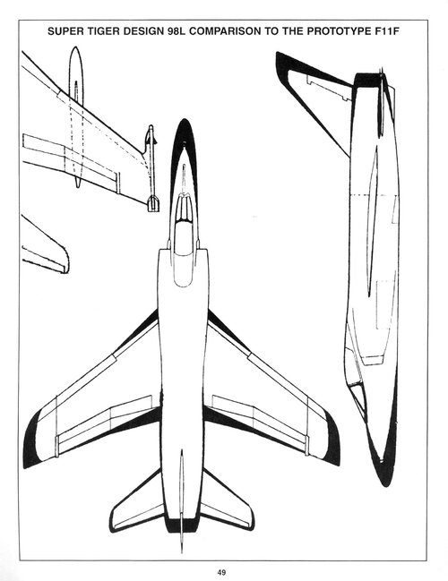

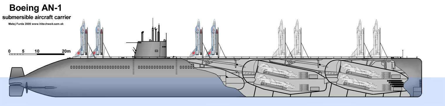

EDIT: The additions. page51image54108912
I will draw attention to the solid black portions of the drawing, in particular the wingtips. The 98L was what was to become the F-12. Adding to any of the possible production orders just the wingtips, which could be done to any existing F-11 in inventory increases the wing area to 313 sq. feet and lowers the wing loading to 83 and change at 26,000 pounds, at the max TO for the standard Tiger of 23,000 you are looking at 73... so she can launch off anything that can handle an A-4 including the H-8 CVS Essex.
The second drawing is of the AN-1, on that I want to draw attention to the F-11 folded up in the tube... they actually altered 6-7 just off the assembly line aircraft that way.. a large enough number that it is strongly likely that they test flew one to make sure it still would.
That also becomes a problem a couple plays ahead: She folds up to 10 feet across. F-8 is 23 folded, so 2 Tigers could fold up in the space taken up by a single F-8... And in the case of the Royal Navy it could directly replace both in terms of span and weight 2-1 SeaVixen.
But the wingtip thing is enough to be a threat to the Crusader and give smaller carriers a viable all weather mach 2, sparrow carrying air defense fighter in either single or 2 seater form... and that makes justifying bigger carriers more of a PITA to congress.

They were going to market the origami ST. So, let us say that CNO doesn't warn off Grumman and lets the sales go through (This is a potential suspect as he would have eyes on all possible programs but could be someone else); this kind of system would have some appeal to the Germans since as I recall they may have done something similar with the F-104.. I have a vague memory of a video of a Starfighter being "yeeted" like this, but am fuzzy on it... Edit: Though a folding wing is not shown in the illustration this just demands nay screams for one and to be put on a train or a covered trailer
This would give the USMC a platform to compare to the F-8 and start screaming for as Vietnam starts heating up... all of the improvements made to the ST including the origami folding could be done to any long nose F-11, including the ones that were mostly in storage in the mid '60s allowing you to double up a Marine squadron of F-8s in the same hangar space with an aircraft that is a much better CAS platform and a near equal gunfighter... Marines love raining "hate and discontent" on the heads of people shooting at fellow Marines and they are super good at being REALLY annoying in yelling for things that help them do that... see the amount of money poured into the F-8 to add A2G to it because of the Corps. I would bet the conversion costs of the program would be less than the development costs of the F-8 subtype that I can't remember the designator of.
That zero-length F-11 is a new one for me.

The version offered to Germany was actually an F11F-1F. Instead of the Wright J65 in the original Tiger, this version was powered by a Pratt & Whitney J79 and was capable of reaching Mach 2.04 in level flight. And possibly faster in the production version (the prototypes were just stock F11F-1s with a fuselage plug and wing root fillets).
